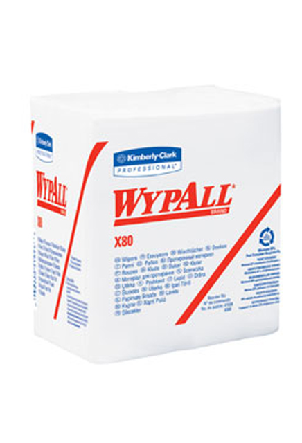

For the towel I will be getting wipeall x80
that's what they buy here... hope it'll do...

Denatured Alcohol is what I use to pre wipe my surface - gets the grease and oils that can conflict with vinyl adhesives quite nicely.
And standard box or rags/towels works well for wipeing.
