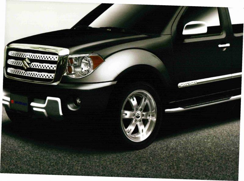

about to purchase used sp540v
should i be worried black head is going bad on this machine
we printed a sample and i dont like the lines on this print
any advice out there or is this normal
maybe a minor cleaning will do
im getting a heck of a deal so i dont want to refuse it??
That looks more like the front end of a truck then a Roland printer.
Oh, I get it now..... that's the print. I don't see any lines. Get it..... I can't see any imperfections from my house. :toasting:

...yeah, what he said...and the lines may be as simple as a feed problem relating to media and profile selection

well we have printed other pics and rest of colors look sharp its just the black that has some thin lines; but i guess its quality of pic

Have a tech look at the history report, show a test print (this may show the scratches on the head in the service test print). Either way, figure about $1,000 to replace the head with labor and a good general service/alignment for the printer.
