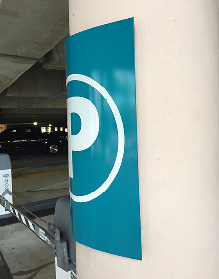

I had about #16 of these to install on large poured concrete columns in a parking garage. It is 3mm ACM Maxmetal that was put into a slip roller and bent. It works fine no heating, bends like solid aluminum. Put cast turq. vinyl on after bending with the white cast P. Tapconed pvc strips on column and VHB taped on panel. Just ran my tape measure around the column to get circumference, found the radius and with a large compass drew on paper so I could duplicate column curve when bending. Was over at the parking garage today and remembered this thread so took pic.

Creighton
Goodness, you are awesome. How in the world could you remember this thread and go to that kind of trouble!? Exactly the type of applications I was figuring there must be a case for.
Thank you. What an awesome forum.
