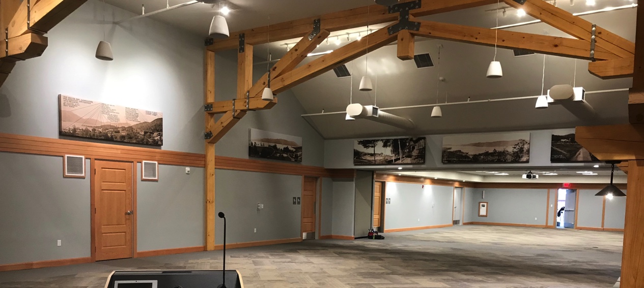

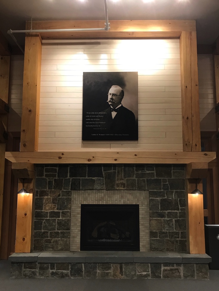

We made (8) 30" x 96" acoustic panels a few month ago. We followed this video's instructions for materials and construction: https://youtu.be/GBHYiWIJhU
As for the printing, we printed on Ultraflex UltraPoplin Soft Image D240 on our HP Latex printer. It is a porous material, so we did have to use the ink catching attachment. All of the artwork was in sepia tone, but the client loved the image quality.
Also, if you are installing yourself, I would suggest using some french cleats rather than traditional hanging wire etc.

You're very welcome. This was the first time we were ever asked to make panels like this, but the video lays out a very straight forward plan. It is a bit of a process, but the materials aren't very expensive and the results were well received. There are cheaper ways to do it, but if your client is willing to pay, they will love it.
