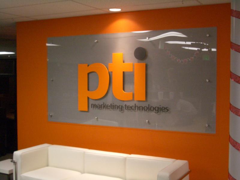

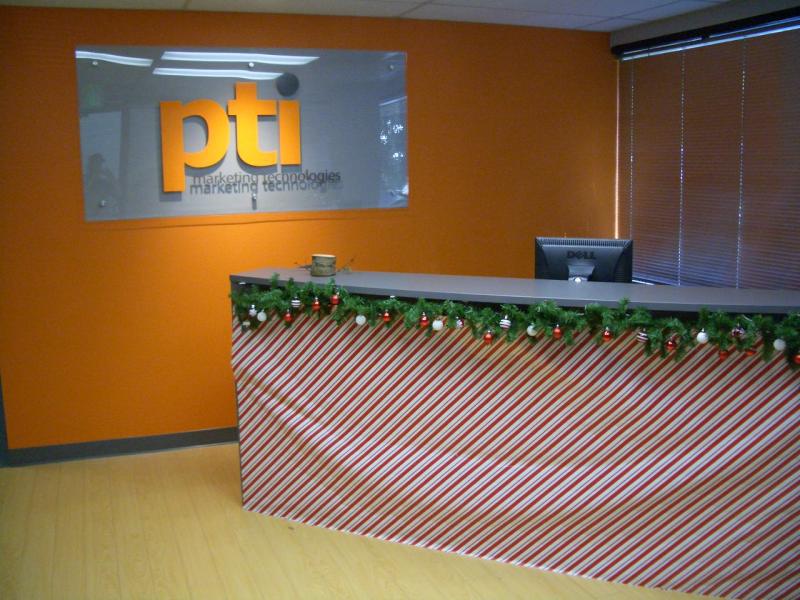

For this project we applied a sheet of laminate (not vinyl, but the laminates they use for mdo board tables/wall laminate). Drilled for standoffs and applied a full sheet of polished acrylic with pantone matched acrylic mounted with acrylic glue. One large and one smaller version.

take a look at "Non-Glare" acrylic for the next one, if you haven't already. I did a few signs like that & then I found the non-glare & like it much better!
GP
Very nice - how did you drill the holes?
