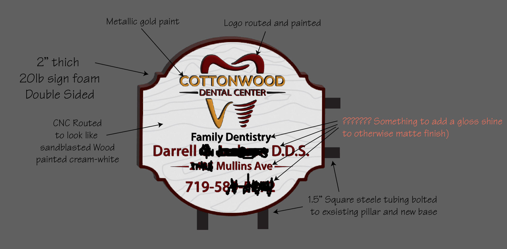

Hi All got a job I'd like to add some shine to. I was thinking about affixing acrylic to the sign foam letters but Gemini said they wouldn't recommend that. Any other ideas?

I haven't done it in awhile, but we would sometimes use something called TC resin on the letters. It was sort of an epoxy you mixed a little paint in and applied with a syringe. Added a little thickness and gloss.

I'd get rid of everything on that sign except the logo. Nobody is going to call the number just because they saw it while driving by. If you're sitting in front of it, the address is pretty pointless as you should already know where you are. If it was a basic flat sign it'd be different but for what appears to be a blasted sign, it should be classy. That things a disaster. Sorry

Metallic gold is not going last outside use another color. If you want shine on letters use gloss paint. If you are insistent on using acrylic dump gemini and use https://eliteletters.com

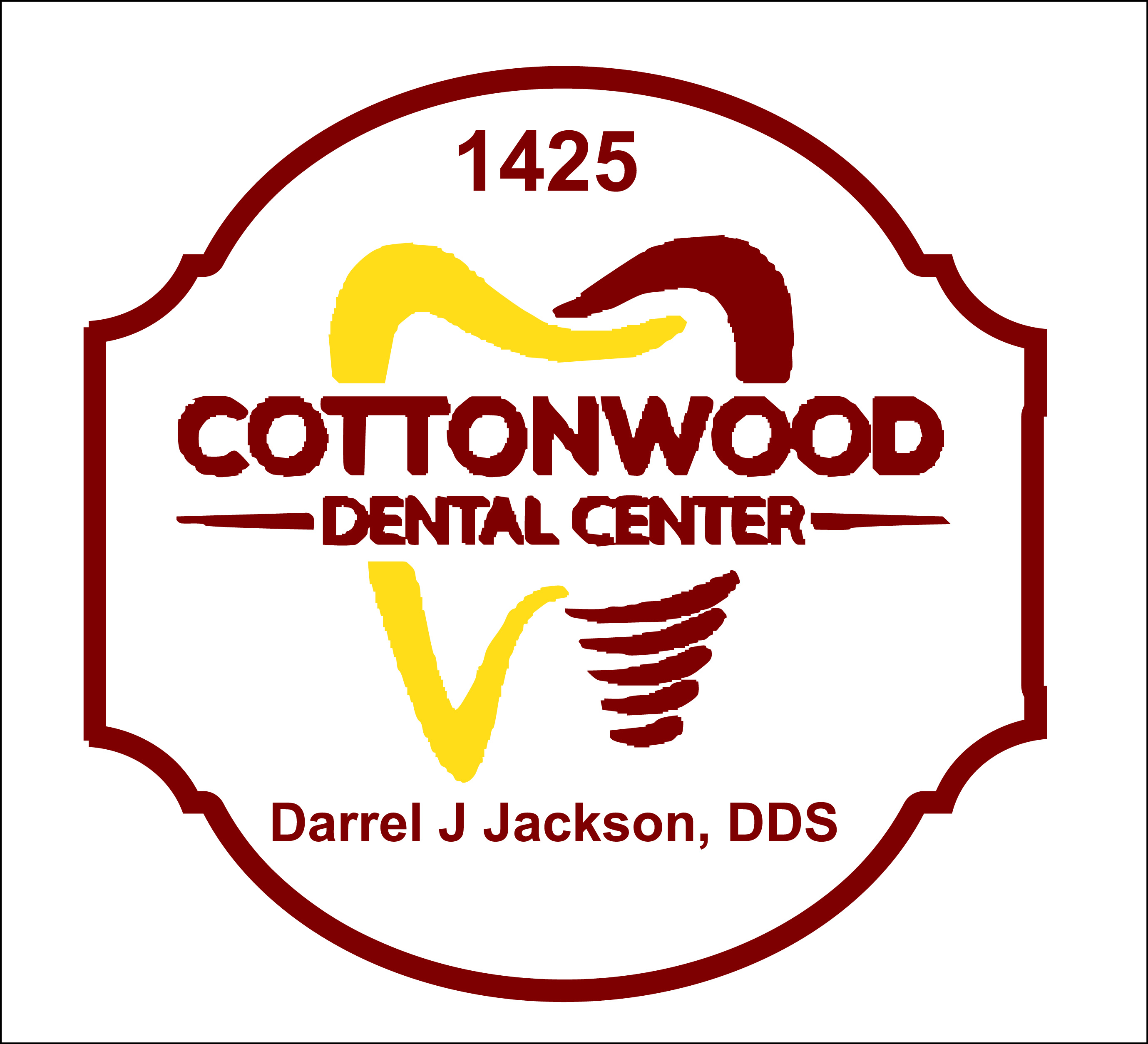

A couple of items you did not ask for. Sign shape does not match sign information, drop the number and drop the street. see attached

I agree with the design suggestions. There are several ways to add "shine". The acrylic would work with studs. The epoxy suggestion is interesting, I've seen tuturials on it but never tried one.
You could use real gold film, I'd suggest the Florentine texture., that combined with resin for the burgandy would look great. Or you could five the logo a raised profile so it pops off the surface. Lots of options.
