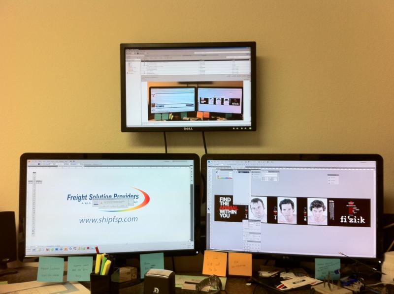

heres my setup:
2 24" for working, and one 20" for email.
all running dvi.. have a dual dvi for the 24's and single dvi card for the 20".
was a pain to setup, but works great now.

ProWraps - so, you are using 2 video cards? I was thinking of trying the same thing in one of my other work stations with an older card, but wasn't sure if it would work.
ProWraps
yeah i couldnt find one with 3 outs. and most of the 2 outs only had one dvi port and one rgb. it was a few trips to Frys electronics to get it to work. some one them didnt support the resolution of the monitors either. like i said it was a pain.
this was a year ago. im sure now its probably easier as hardware keeps progressing.
windows a bit a tough to get them to recognize, setup primary monitor, arange them etc. but in the end, i got it working.
then you run into the motherboard being able to handle two cards. bios settings etc. which socket it will make primary blah blah. you gotta deal with agp, pci, pci express. like i said, its a pain. the motherboard is KEY to allowing this setup.
i wish i could remember exactly what im running. i dont want to tear my box open to find out.

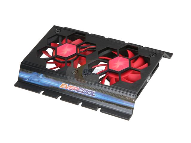

Yea, also DON"T forget more fans in the box, if you up-size the existing power supply, you will be introducing more heat inside the box. So, add more case cooling.
Another good idea is to add hard drive coolers (fans) to keep you hard drive working longer, heat is a big enemy of hard drives.
http://www.newegg.com/Store/SubCategory.aspx?SubCategory=577&name=Hard-Drive-Cooling
