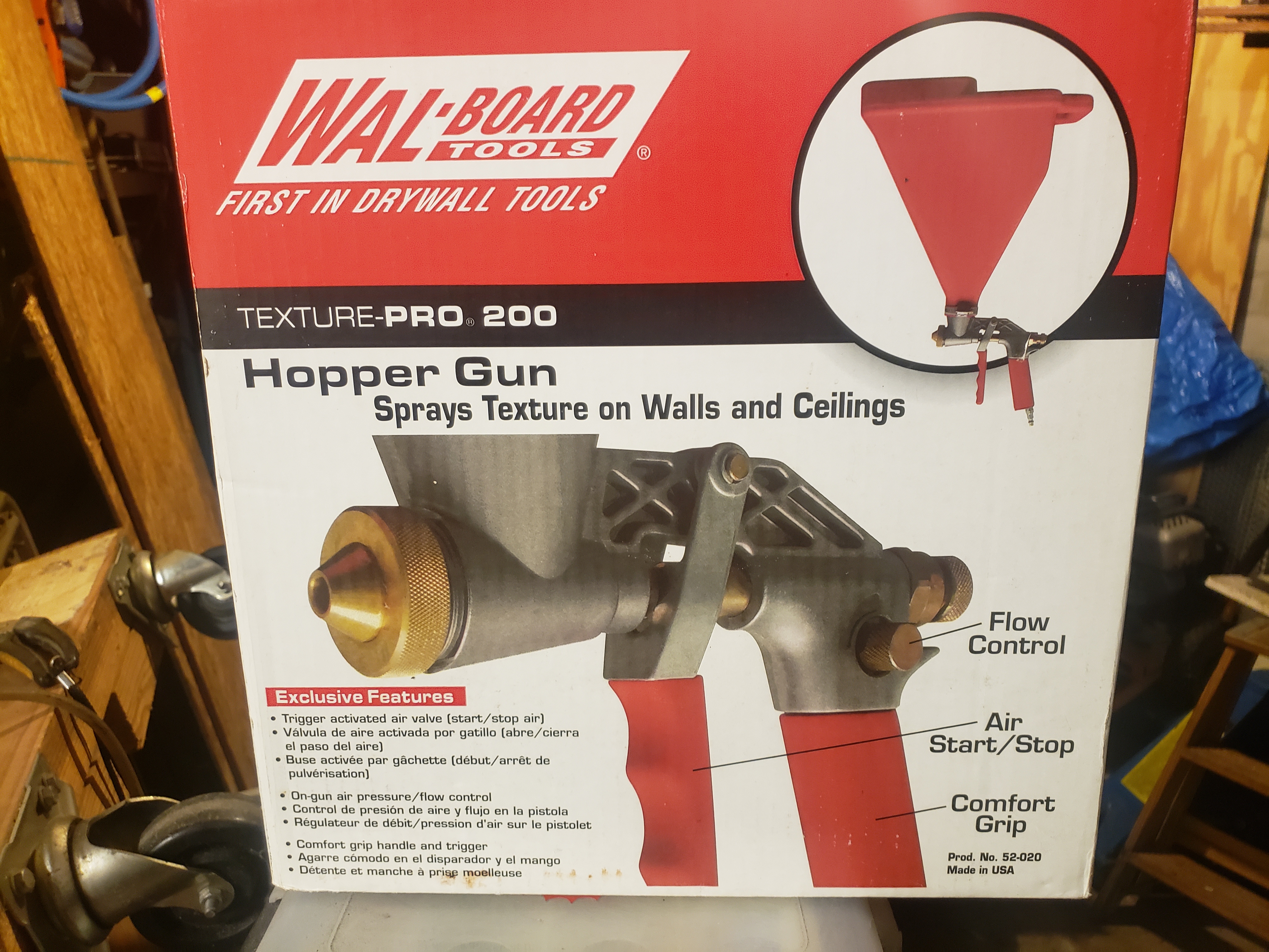

But a Hopper Kit from Harbour Freight. See attached photo.
Lightly sand ACM then add a good outdoor white primer to a half or a full bag of concrete.
Mix it well.
Use dry wall mud for indoor use.
Add it to the hopper, stand back and spray the sheet of ACM to your liking. After the mixture starts to set up you can lightly drag a trowl across it to simulate the stucco texture, or in most cases you can leave it like it is.
The kit comes with four nozzles from fine to massive clumps.
I did this process years back on a wall using a stencil then spraying it then removing the stencil.
I have used this kit multiple times and every time I hit a HOMERUN.
