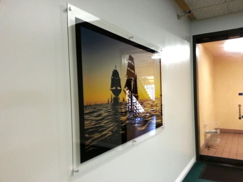

Here is face mount picture. Print on Oracal adhesive Clear on L25500 with reverse print (wrong read), backside using laminate apply white vinyl. Final wet mount on .25" Clear Acrylic. This project such PITA, because artwork with solid black away from edge. We done 3 customer like and order 5 more coming 60"x40".

So, if VHB tape is applied to the vinyl, and the VHB tape is 1/32" (±) thick, and you add a dime-sized dollop of any reputable silicone (which will be either non-shrinking or low-shrinking silicone), and mount that on the wall, it's going to pull the vinyl off?
Sorry, but I don't see it happening.

We were subbed an install for something like this last year. 30 pieces, 1/2" acrylic with 2nd surface graphics. Each panel was 78x36........Heavy!
They were sent with French cleats that we're vhb'd and silicones to the back. As soon as we let go of the first one it dropped to the floor. We took them back and drilled them out and used standoffs. I think you're heading for disaster by trying to adhere to second surface graphics.
Worst part about the whole gig was that each panel went on a different floor. So we unloaded them, took them 2 at a time in the elevator and unloaded all 30 just to find out it wouldn't work. Took 8 hours just to unload and reload! Luckily we were paid for this.

This is when pics of art should be posted. I personally think this will work with no issues.
trimitbyrich
I have to agree with stand off's for sure. They give a very classy look to it for one, but more importantly wont damage the wall as much as vcb. When they go to take it off it will peel large sections of the drywall off as opposed to very tiny holes. Stand offs for sure.

I don't see how you would use standoffs with second surface graphics without mucking up the graphic (unless it had a clear border which it doesn't sound like this does).
A 15"x20" 1/4" acrylic weighs a LOT less than a 36"x75" x1/2" piece. And when the weight is carried completely around the perimeter by the tape it does a better job distributing the stess than a single horizonal cleat attached with tape. Also I would just use tape, it will do the job just fine.

I agree 100%. A sign that thin is putting only shear force on the tape. One square inch of VHB tape can withstand a ridiculous amount of shear weight. If you attach VHB to the perimeter, it's staying put.
OP: I only mentioned using silicone because you mentioned being apprehensive with just using tape. VHB will do the job. If apprehensive, VHB and silicone are a mean combination.
