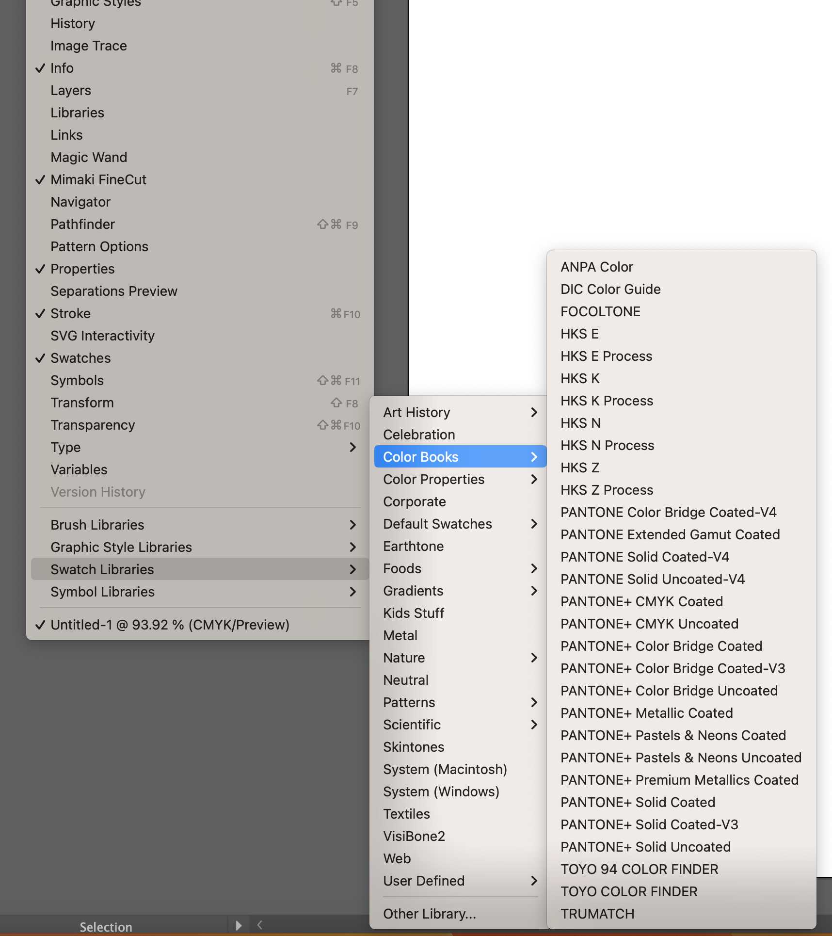

mine work ok in version 23 on a Mac

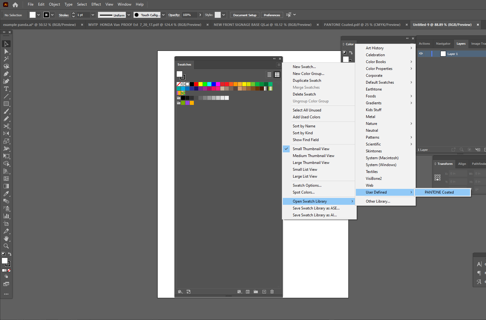

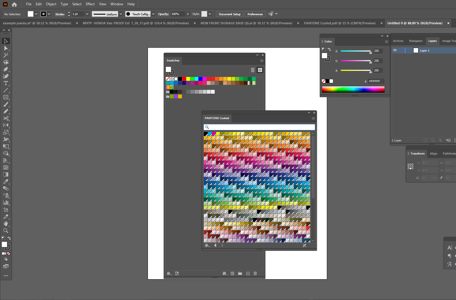

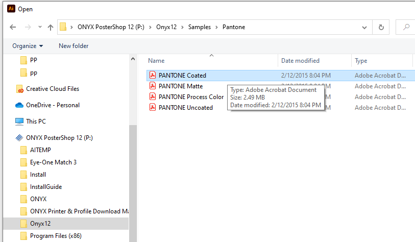

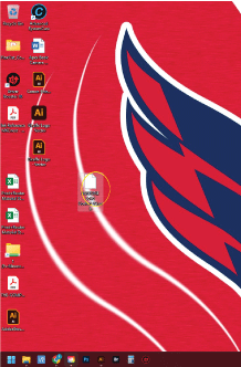

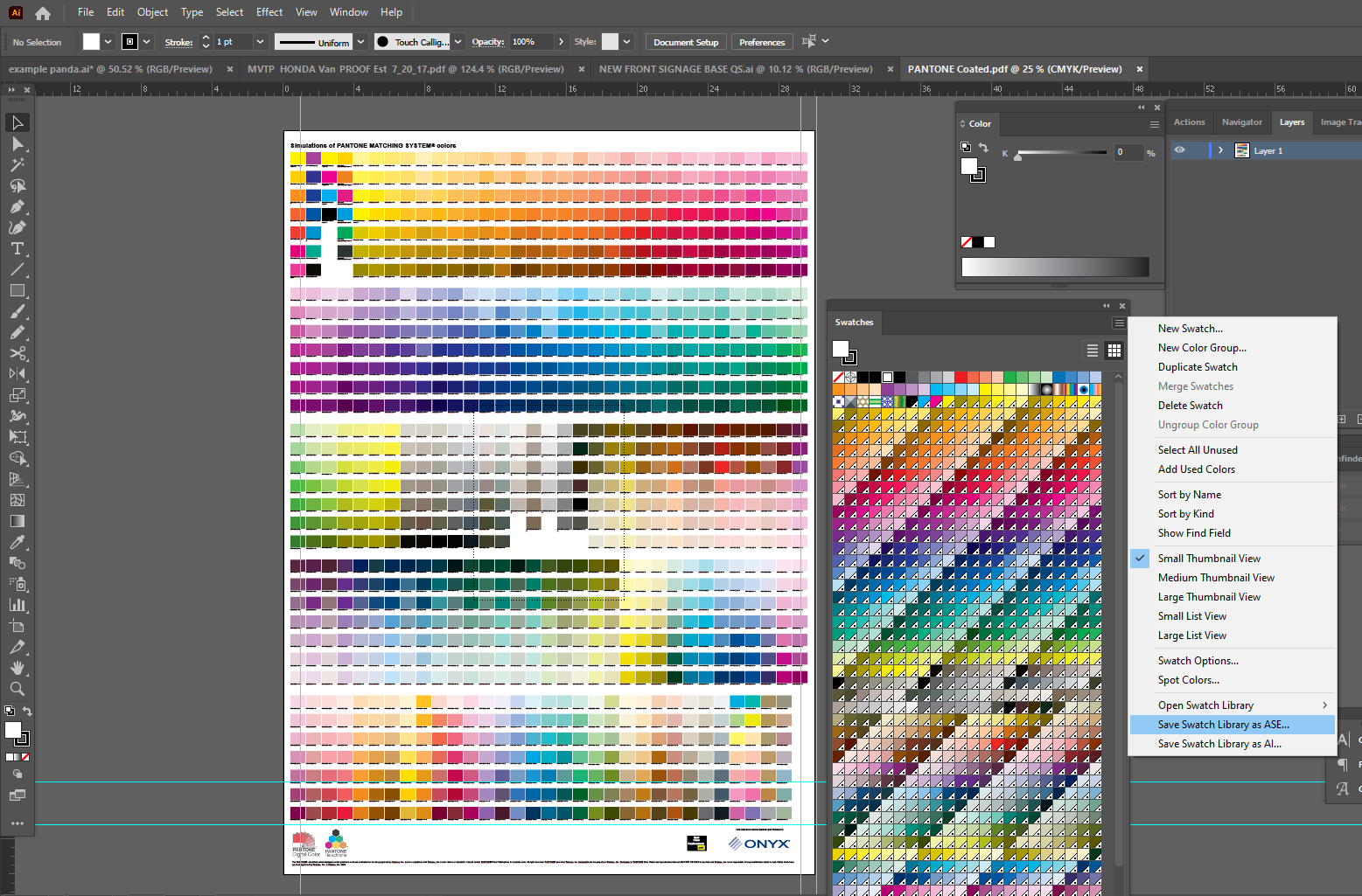

I just opened the ONYX sample PANTONE PDF image that comes with the software install. This then showed all the pantones in the Ai swatches palette. I then deleted any other odd swatches that were in the palette, then saved the palette as the User Defined.
Now when I need pantones I just open up the User Defined Pantone C swatch palette in the color libraries.
Some RIPs allow you to export a Color Library that Adobe software can import. Check to see if Onyx will allow you to do that.
