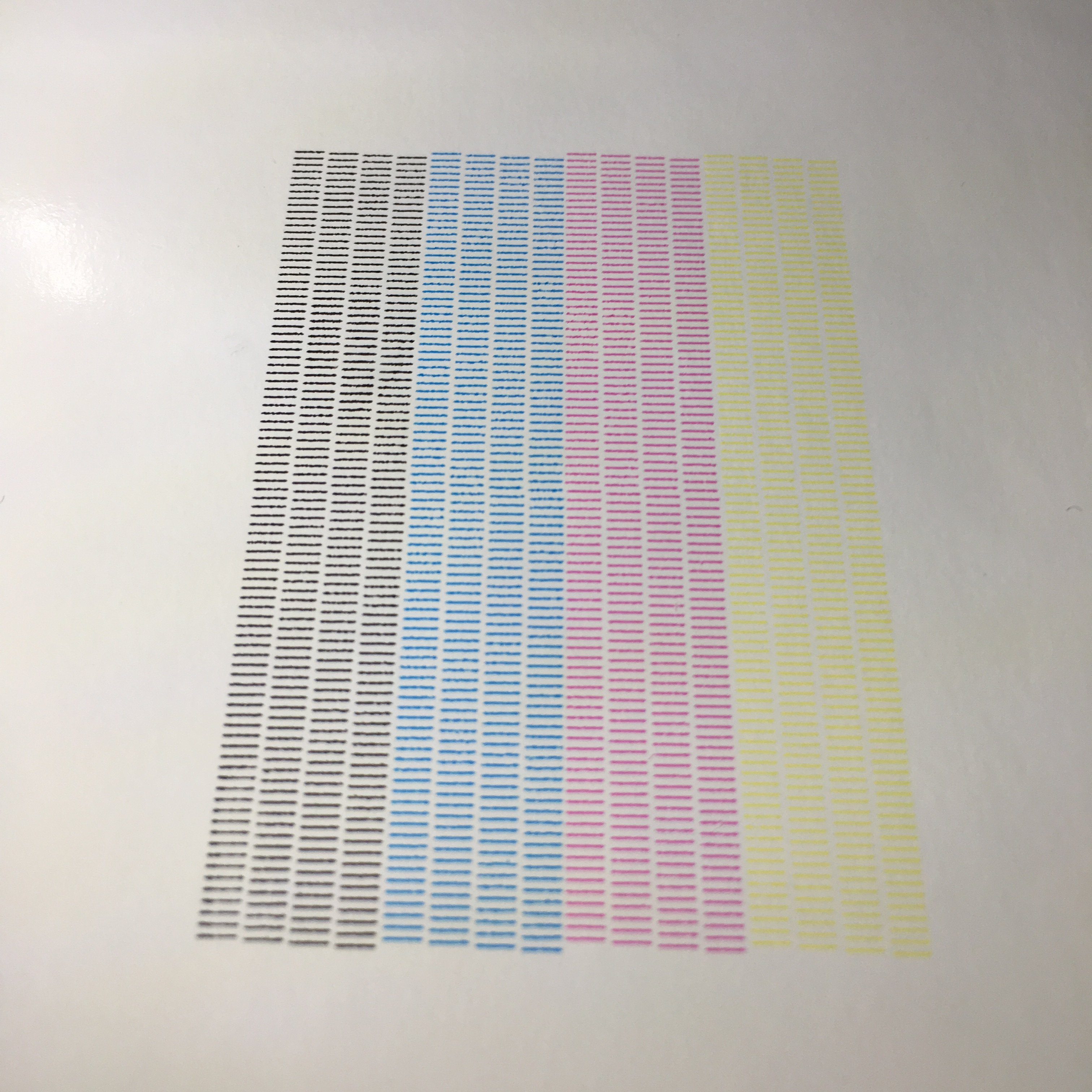

I aligned the heads and got good patterns verticle/horizontal/bias etc, printed a report and saw I could clear the old data too. All test patterns look good as new! Now time to install software and do some real printing.

First image is when I put in K/C head and got running then did the other one. Last image is both installed and aligned.

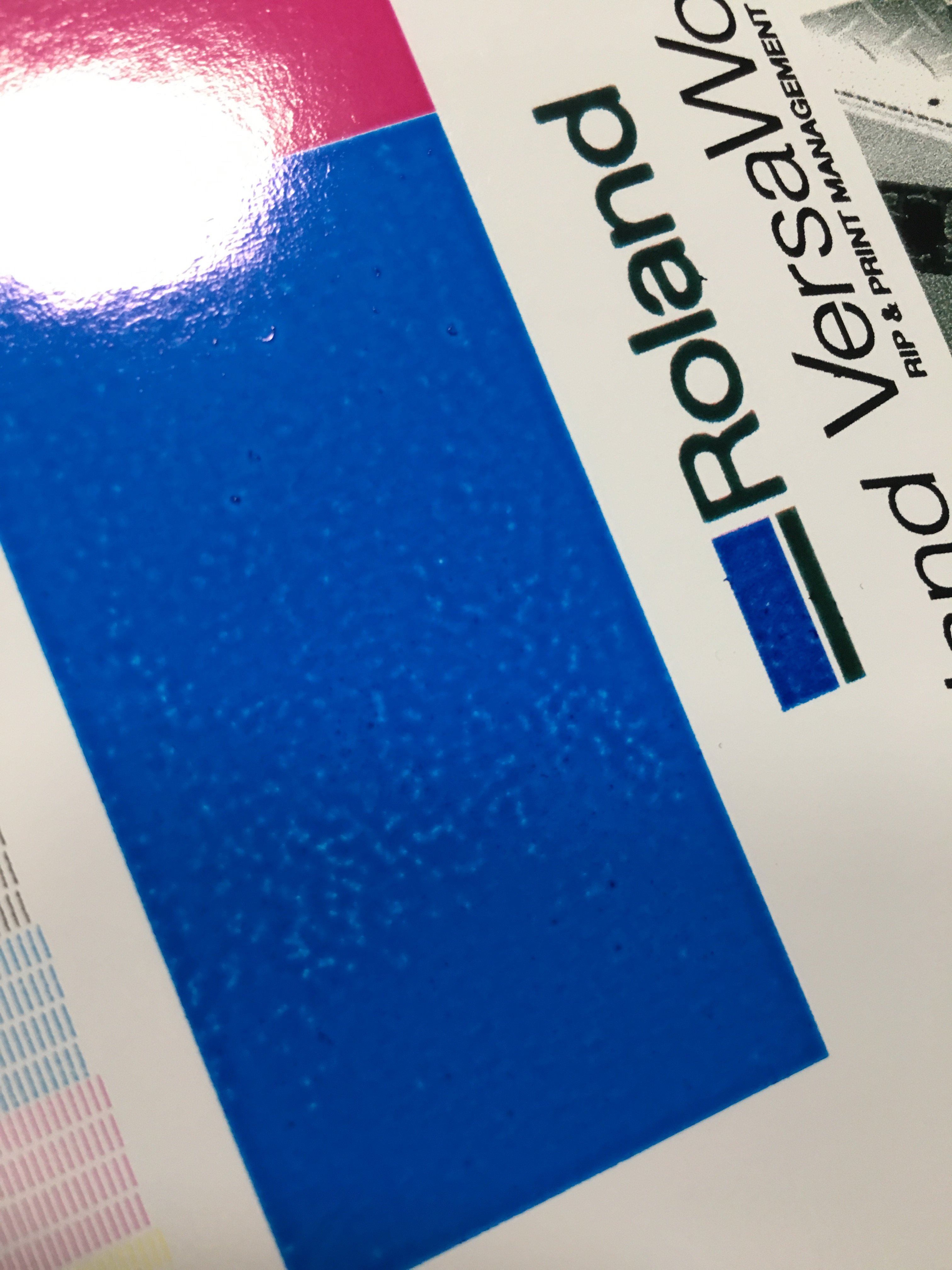

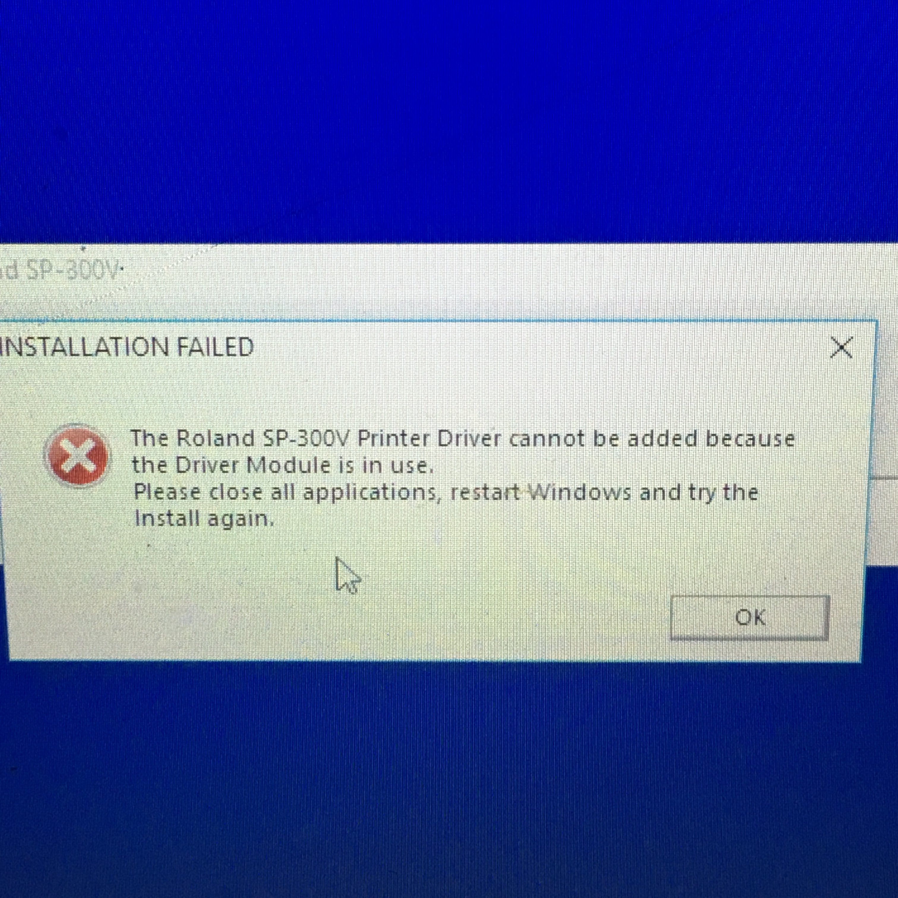

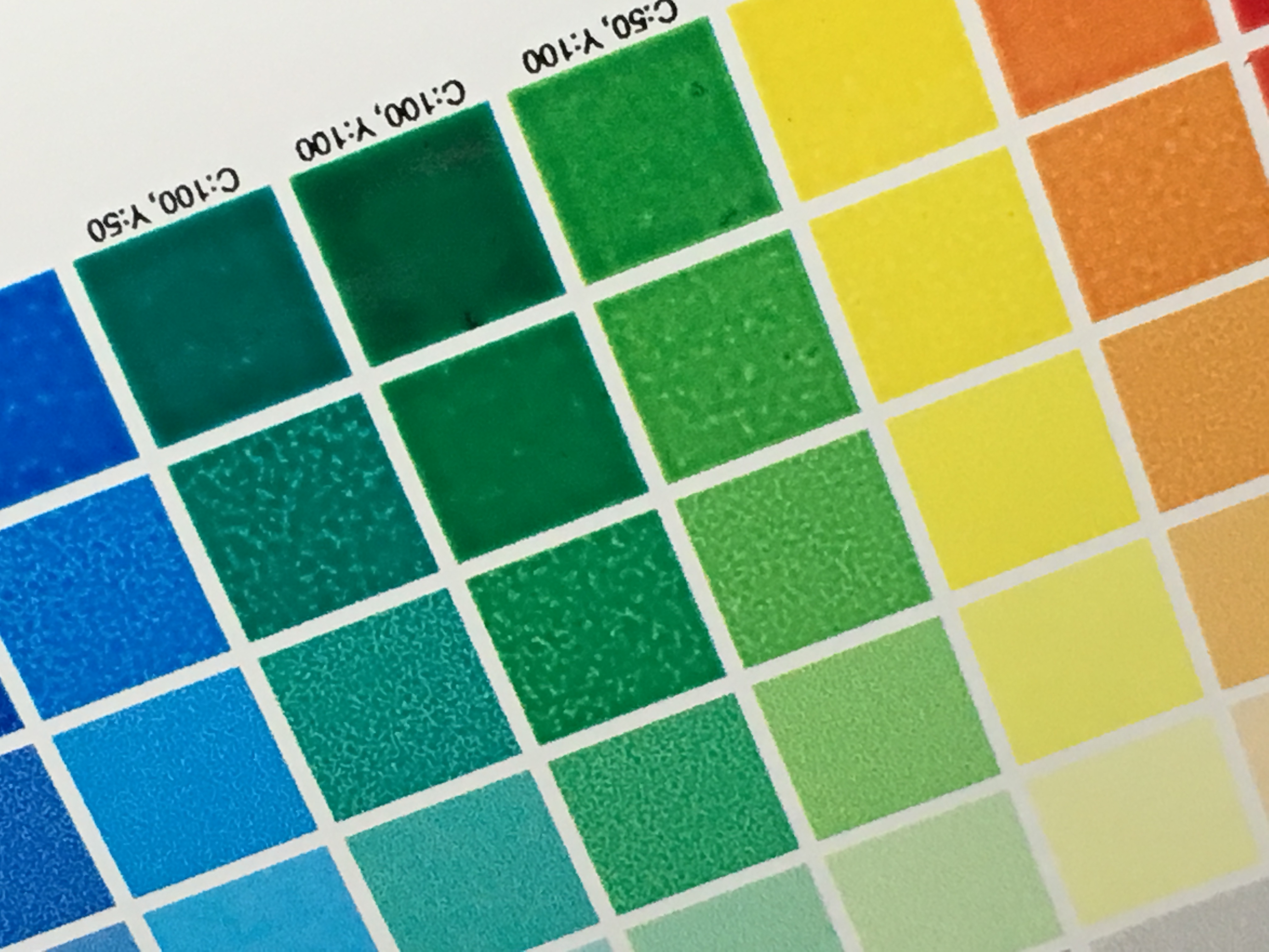

Now I'm printing and trying to figure out a computer to use, I have an old version of versaworks, 1.20. Have it installed on a newer computer but don't have the printer profile installed off the other disk, it tells me to quit all apps and try to install it again (I'm not a windows person). I was able to run Versaworks and have it print a test print, looks like ink came out a bit heavy on the print/wet/thick and kind of mottled in the solid areas, I think it may be a profile issue? But I did get it to print some eps files/clip art and also the same thing, tried to set media to Generic Vinyl I. Same efffect....any tips? I"ll post a pic shortly of it...at least it's printing sharp text and nice colors!

Usually when you see ink saturation like that it could be a couple things. The heat settings are too low, the material is defective or the profile is wrong for that media. Usually it's heat settings but it's not unheard of to just have a bad roll of vinyl or even a partially defective roll. Do a little trial and error with the profiles and see if one works better than the other. If you try multiple profiles and it pools up no matter what, I would suspect bad media. If you change the media and it still prints like that you may have environmental issues or even bad/old ink.

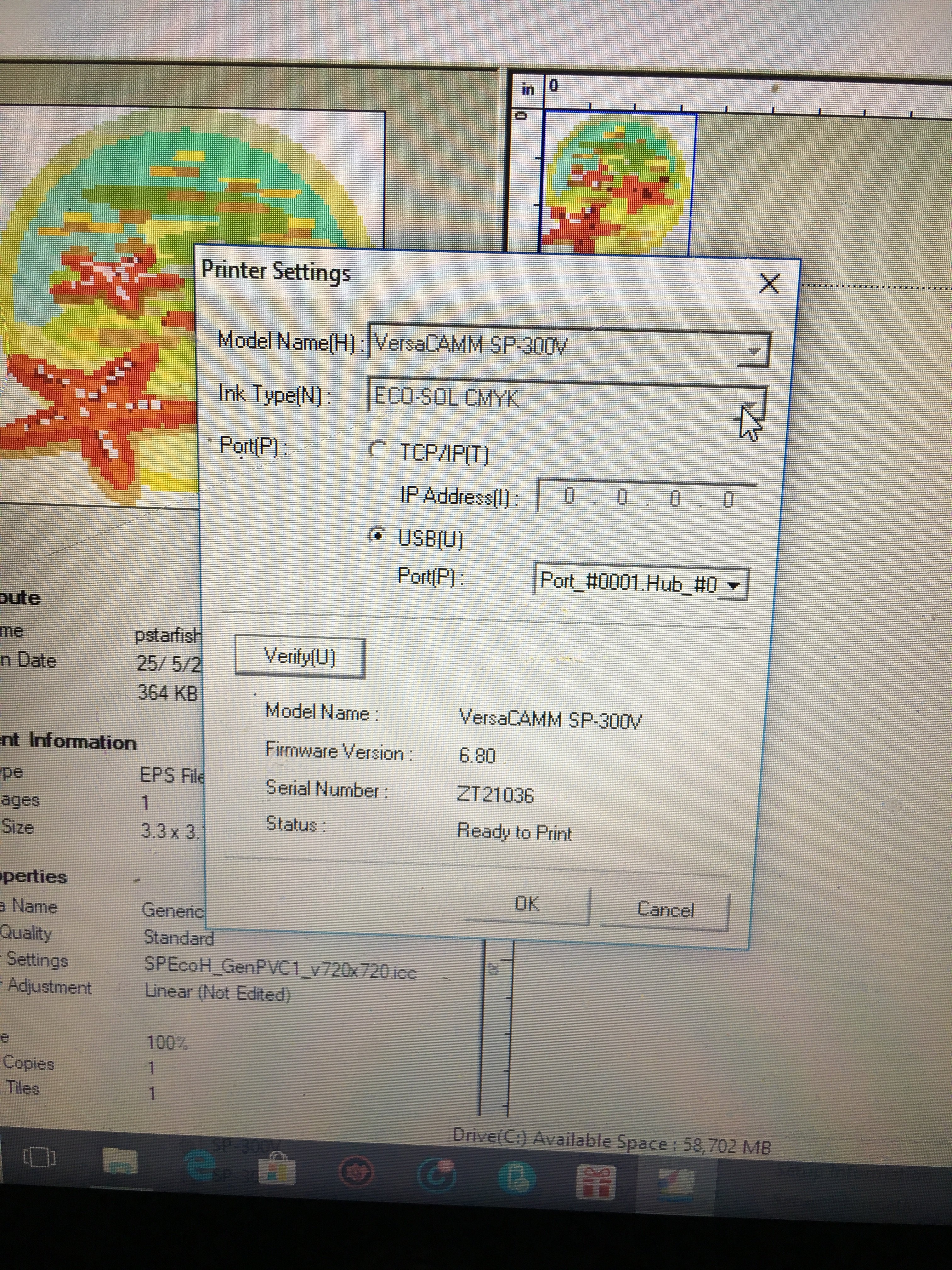

Can anyone tell me what version software I can use on this sp300-v printer? I have a computer with windows 10 and versaworks version 1.2 disk. Can I buy the latest versions software to run this?

Well turning on the heater helped a lot! I thought it was on but it wasn't....Looks perfect...I"m still having issues with the software version 1.2 on a windows 10 system, get it to print some but can't change a lot of settings/print quality or even scroll down to see all the preview window info. Tried to contour cut today and just nothing cut. So I found a new version of software on Ebay and bought it, 5.5, the seller said it would work on my SP300V. I'll wait till the software arrives and try it and get to printing if so!

Good work on the referb. The test prints has a slight sway to it, I think that means the head alignment is slightly off.

If you get Roland VW to start, you should be able to go to Edit>Preferences>Roland@RNet and have it check for updates. You may have to restart VW for it to automatically check.
