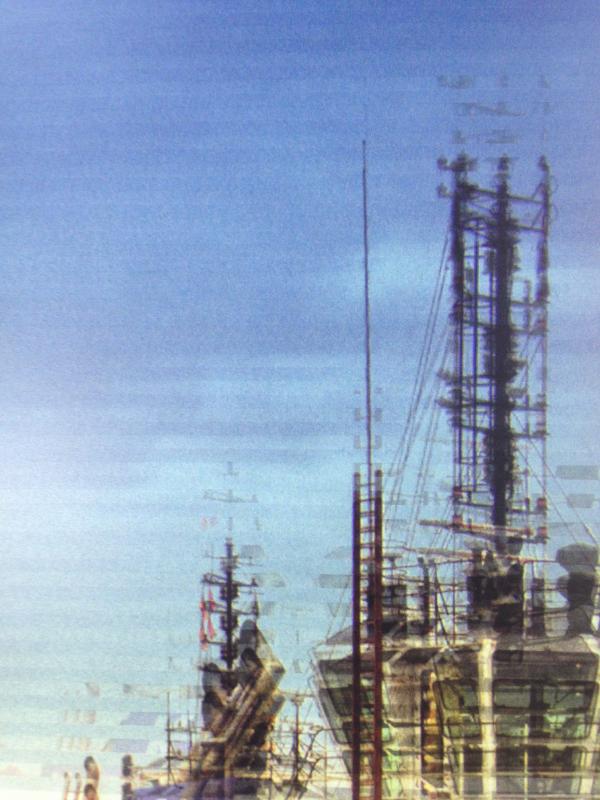

When we turn on the ionizer, the picture is printed, begins to divide in two or troitsya on the horizon. Printing is not possible.

Wafels
can you take a picture of the result?
and how does it print without ionizer?
We had same problem once, but restart of whole machine helped with that. Other time the encoder strip was damaged.

Vertical copying pictures.
encoder strip - new (recently replaced).
Instead ionizer by using antistatic cord.
Original. ---- Ionizer ON.

Wafels
Well, ours was also new, but someone damaged it during installation of machine, or later. And it were barely visible small fractures.
and restart as our operator says.

You talk about the encoder strip?
But if the ionizer is turned off - normal print!!!!
Wafels
yep.
Turn it off then if it prints ok. I'm sorry but I can't give you no other advice then, rather than contact your local agfa dealer and they will appoint you technician. We had to call our technician to solve banding problem, stripes on image.
