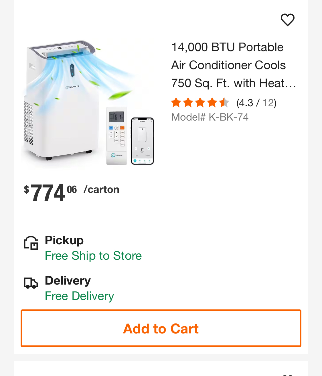

I got fed up with our 2 mini splits constantly failing in our 40'x60'x12' building. We mounted a large 28k BTU window unit through the wall to help. While rated to cool up to 2k ft², it keeps the whole building cool and dry on it's own. We're in South Cakalaky so high 90's and 100% humidity are the regular summer conditions. About $800 from Home Depot.
