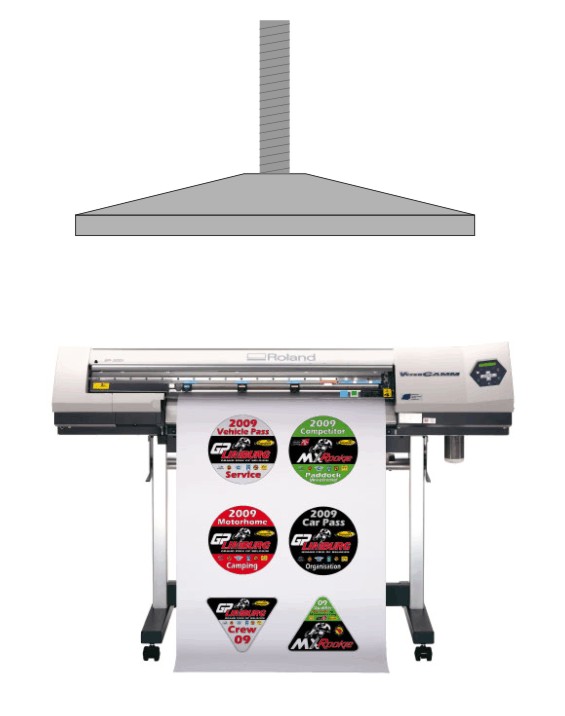

The hood idea isn't bad, but think about a collection tray that would sit on the floor below the machine with inlets spread the length of the printer. I'm sure you can buy the collector as I've seen them at many shows, but you could easily build one yourself too. Of course you'll also want ambient air to be circulated, which is why Island Clean Air only uses one side of the Duster 2000 (what we run) for the Fume Control attachment.
