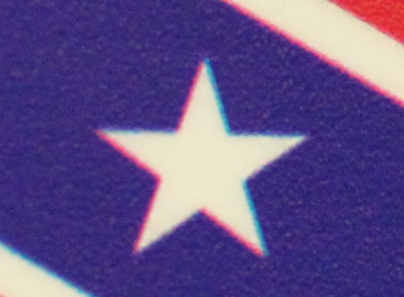

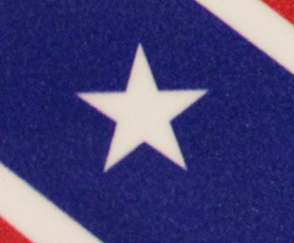

I just had GSG replace my K C head and now I have some type of alignment issue. The first Star shows magenta on one side of the star and cyan on the other. The star is only .25" so it's not noticeable unless you look really close. The second star shows what it was like before the head was replaced. I've gone through all of the calibrations and nothing seems to help. Am I just being too picky? What can I do to fix this?

jeff412
Solution:
If anyone is interested, the problem was the vertical head alignment. Just had to adjust the magenta head a little and now everything is perfect again.
