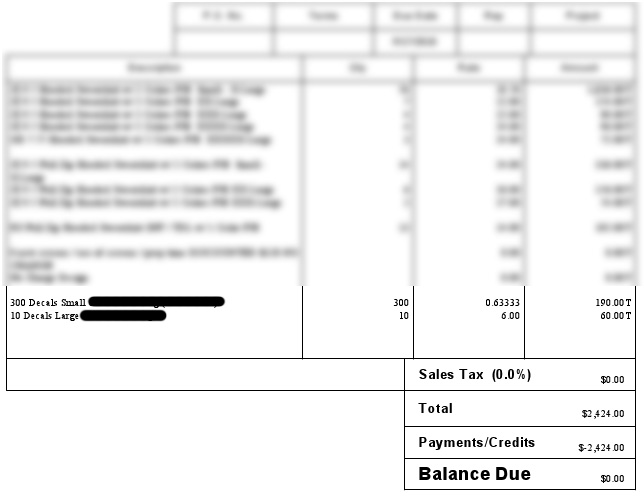

Had another potential customer today ask about getting some decals for their car business. Said they use a guy now who is so backed up the orders take weeks to receive and wanted to see other options.
So, They send me this invoice they got from him apparently. The smalls are 6x3.5" cut vinyl and larges i'm not sure, they didn't say directly what size they were. The design is pretty much lettering cut out in the middle with a outline on top and a regular style on a second line.
I thought this was WAY too cheap for cut vinyl and i told them i could print them but at $.74 each for 500 unlaminated and $.96 laminated
I haven't heard back lol
I explained how the cheap price they are getting and poor turnaround time may say alot for the companies they are using now and the benefits of printed over cut vinyl (color combos almost unlimited, shape unlimited, design unlimited pretty much). I also let them know the standard turnaround for bulk orders is 3-7 business days.
Anyone care of share their say on this deal?

means nothing without seeing the art...
and besides, never trust a vague term like "cut vinyl" 10 people could say that and mean 10 different things... well, ok,,, maybe only 5 things... but what do THEY mean?? ...every single PRINTED decal I've done in the last 10 years... all 10 million of them... they were "cut vinyl" ... and printed...
besides, maybe the 6" x 3.5' decals is an "O" for the Ohio O's ... so, big deal.. cut 500 O's and move on... I'd do that for 63 cents each...
well, actually I wouldn't... maybe the 75 cents you quoted though... but still, words are worthless in this business... show me the goods.. or the art, or the fine print...

I know that & you know that... but if a client asks me for that, & wants anywhere near a buck a piece, I'll show them a printed "vinyl" decal & say how do you want that "cut" ... a rectangle? ...an oval? ..or a nice custom outline that follows the shape of the typography...
that shop ain't just "lowballing'... if they are quoting 2-lines of computer cut vinyl lettering at 63 cents... do nothing... just wait like a vulture.. they can NOT do that & will die trying.. then you swoop in...

welll..
That invoice is for $2500... and these decals are only 10% of the invoice.
He may have made a big profit on that other stuff and then "threw him a bone" with the cheapie decals.
Obviously the other guy is not super excited to do JUST the $250 portion...
BUT..
You may want to consider doing it, because then you can catch the other $2250 when that comes up now & then.
