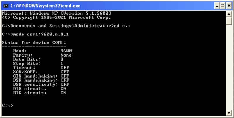

Create rectangle in Corel and export as c:/test.plt
Go to command prompt and try the following...
C:/mode com1:9600,n,8,1 (enter, or com2 if that is the correct port)
C:/copy test.plt com1 (enter)
See if your cutter responds.... if not, repeat with Com2

J Hill Designs
just go to your c:\ drive in command prompt, and start the sequence at mode
should look like this
