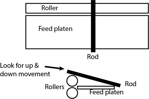

Royal Sovereign uses crowned rollers, so you will get a pressure differential between the ends and the middle. Check to see if the rollers are out of round by laying something rigid across the roller. See attached pic. The Royal Sovereigns can drive you crazy.

Should have specified the obvious, that you look for up & down movement as shown in pic, is while running the machine (no lamination needed).
