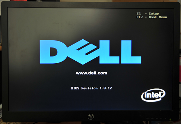

I have a Dell Inspiron 530 running Windows XP with a Core 2 Duo processor, worked fine yesterday.
This morning it will not start-up, freezes at the DELL screen, will not allow F2=SETUP or F12=BOOT MENU, just stuck on the Dell BIOS screen.
I have Norton Ghost, and in the past I made back up files and a recovery disk, however, I can't get the computer to read the disk, will not do anything, just stuck at the BIOS screen (see photo).
Called Norton, they had me try to restart and tap on the delete key, tried many times to restart holding the F2 or F12, nothing stuck in the Dell BIOS screen.
Norton tech says the BIOS is corrupted and I need to open the computer and reset the BIOS on the mother board?.
I don't know how to do that, can anyone offer any help or suggestions?

I would try taking the CMOS battery out and re-insert it. That may be an easy fix before switching jumpers, etc. Def. sounds like a BIOS or motherboard issue and not other hardware / software as it isn't even getting to that stage.

This may be the easiest. I would unplug the system , remove the battery, wait a few minutes, then re-install the battery. You may or may not have to make a few BIOS setting changes afterward.

:thankyou:Hey guys, thanks for the help, while waiting for a reply did a google search (Love Google), anyway I found a link that said to unplug everything form the computer, and press the POWER button and hold it for 15 seconds, this sometimes will reset the BIOS. Then connect only the monitor, mouse and keyboard and re-start.
I followed the instructions and my computer started up, it paused at the DELL screen as it did before, and then went on the normal start-up, Holly Cow, it's fixed, it is a small miracle.

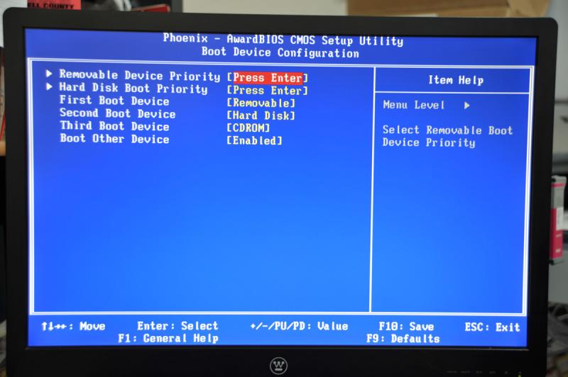

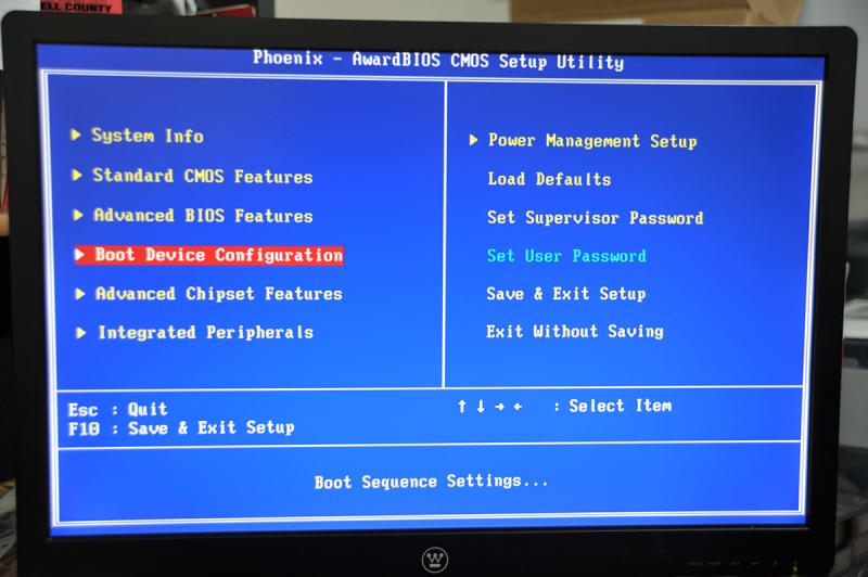

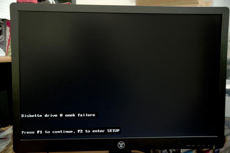

Hey everyone, thanks for ALL the good tips, as stated above I did change out the battery on the mother board and that reset the BIOS and the computer will start up, but now there is another problem, ever since I installed the new battery, when the computer starts up, It stops with a black screen saying "Diskette drive 0 seek failure" (see attached photo). And gives me two options F1 to continue or F2 to enter setup. When I select F1 the computer continues on and starts up, but it's annoying because every time it starts up, it stops on the "Diskette drive 0 seek failure" screen.
When I select F2 and go to the setup screen, I was NOT sure what to change, I asked Casey what to do and he suggested I change the FIRST BOOT Device from Removable to CD, leave Second Boot Device at Hard Drive, and change Third Boot Device to Removable. I made the changes, however the issue was NOT fixed, every time I start up, I still get the same message: "Diskette drive 0 seek failure".
Anyone have any other ideas or suggestions to cure this "Diskette drive 0 seek failure" issue?

It is trying to boot from a Floppy Drive first and that is not going to work. Depending on the age of the BIOS, there may be a separate setting regarding booting from the floppy first. Find it and disable it.
In the photos, your first boot device is still "Removable". I would put the CD/DVD first, then hard disk, then removable.

Casey, the photos are the BEFORE, I have made the changes you suggested. I will look for the FLOPPY FIRST as you suggest.
