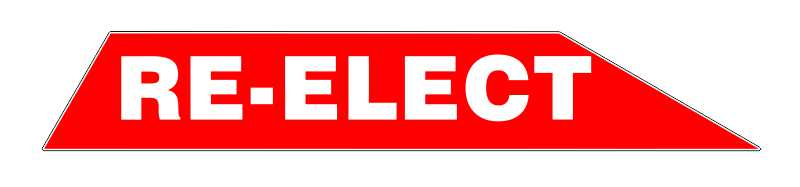

These particular prints that I noticed this on were not the huge job that I'm printing right now as we speak, but were some 3"x12" contour-cut decals that are solid red (Roland spot color) that I needed to blast out before doing the big job. I allowed a 1/16" white outline around them so as to avoid cutting into the ink and getting major curl. I only waited a few minutes before weeding.
It just seemed really odd, I haven't experienced this with the LG stuff.
I guess I'll wait a few days before covering 'em with pre-mask!

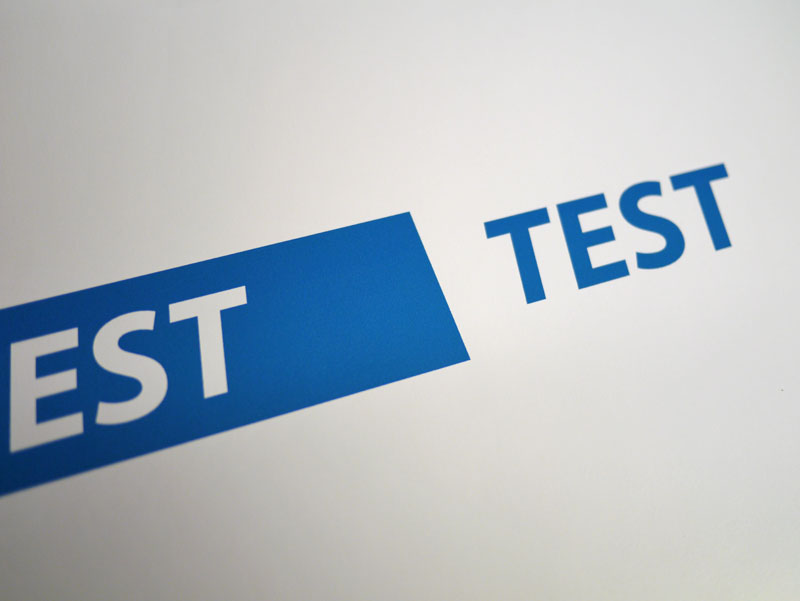

It's a roll of Matte, and I'm printing at high-speed with awesome coverage. Before doing a small test print, I thought that it would not be good enough at high speed, but it's very solid (it's all teal lettering, Roland spot colour), no graduated tones. I'll let you know how it goes with laying it down.
Colin
This is the print coverage at high speed; pretty solid. (Actual colour is Teal, I guess something got lost in translation between camera, computer, monitor, & reality).
