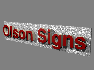

I've used Swift 3D for a couple projects.
Pretty easy to use to render images like this:
