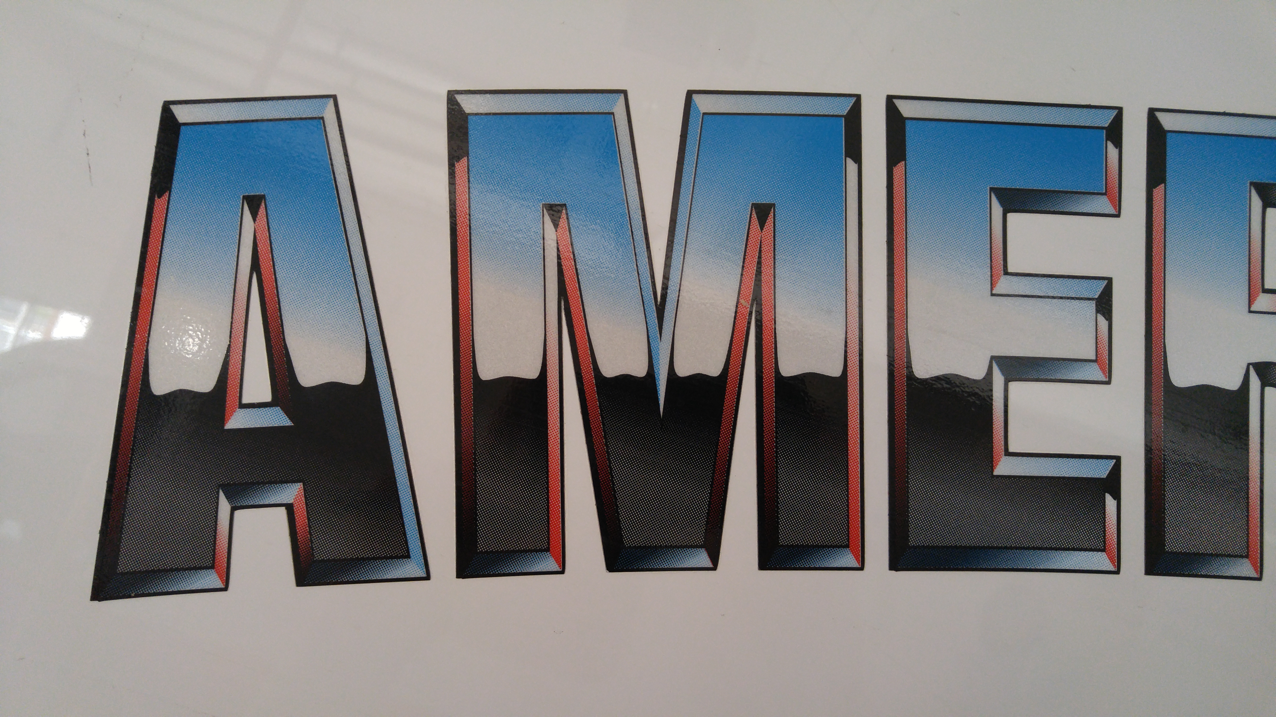

I have to letter an ambulance to match others but here is the kicker... They do not have the artwork. So I am trying to reproduce this lettering. Tried Eye candy with no luck. Any thoughts?????

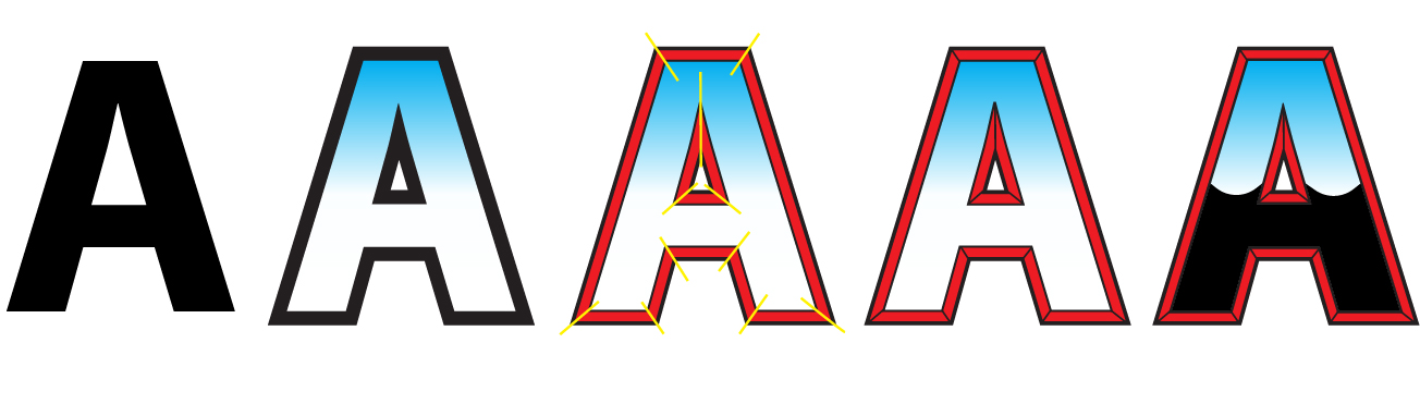

Combine TimToad's post with this and you'd be golden.
Make your text, add a thick outline. Separate and expand it. Add a thin outline around the text. Then make one more outline that is slightly smaller than the thick one. Separate and expand it. Then make 0pt paths on the corners, expand, and then use it to cut the middle outline apart. Apply the gradients to them parts. Then use the tutorial above to create the middle effect. That took me about 5 minutes and that included trying to remember how to do it.
You'll have to match the halftone in the bottom half too or it wont look the same.

That's a great idea!!! My problem is I don't know crap when it comes to illustrator. My background is in photography so photoshop has always been my go to. Currently I use signlab 10. Love it but I can not reproduce this easily.... What a headache...

I can't tell enough from the type sample, but if the base typeface has no curved segments in it (such as ITC Machine) then the effect would be relatively easy to reproduce all in vector format without having to settle for pixel-based Photoshop type stuff. There is no one-button click simple solution to it. Gotta be willing to spend a little time on it, especially for anything that looks good. Still, it's not hard to do. Using CorelDRAW for instance you would start with the contour tool to create the face or outline of the beveled letters (adjusting the results if necessary). Then you use the snap to object functions to create all the individual parts of the bevels. From there you just refine the line work and fills.
Regarding halftone effects, it's not necessary to use Photoshop for that. Astute Graphics' Phantasm plug-in can produce vector-based halftone effects (among some other neat functions) in Illustrator. The latest version of CorelDRAW has a new Pointillizer tool than can produce very good vector halftone effects from geometric shapes (like circles) or other source objects.

FutureSigns: yes, of course a Gerber Edge Font. All the fire engine manufacturing companies had an Edge (probably still do). I knew I has seen something like that before (course halftone, almost comic book look, peculiar hump in horizon line). It's been years since I had an Edge, but as I recall they had pre-set "filters" for producing popular effects. This was somewhat of a novelty at the time. Gerber fonts were around $200.00 each (so if you wanted both Helvetica and Helvetica Bold, you had to pony up $400.00). This all changed in the late 1980's when vector based drawing programs and PostScript fonts started to become popular.
