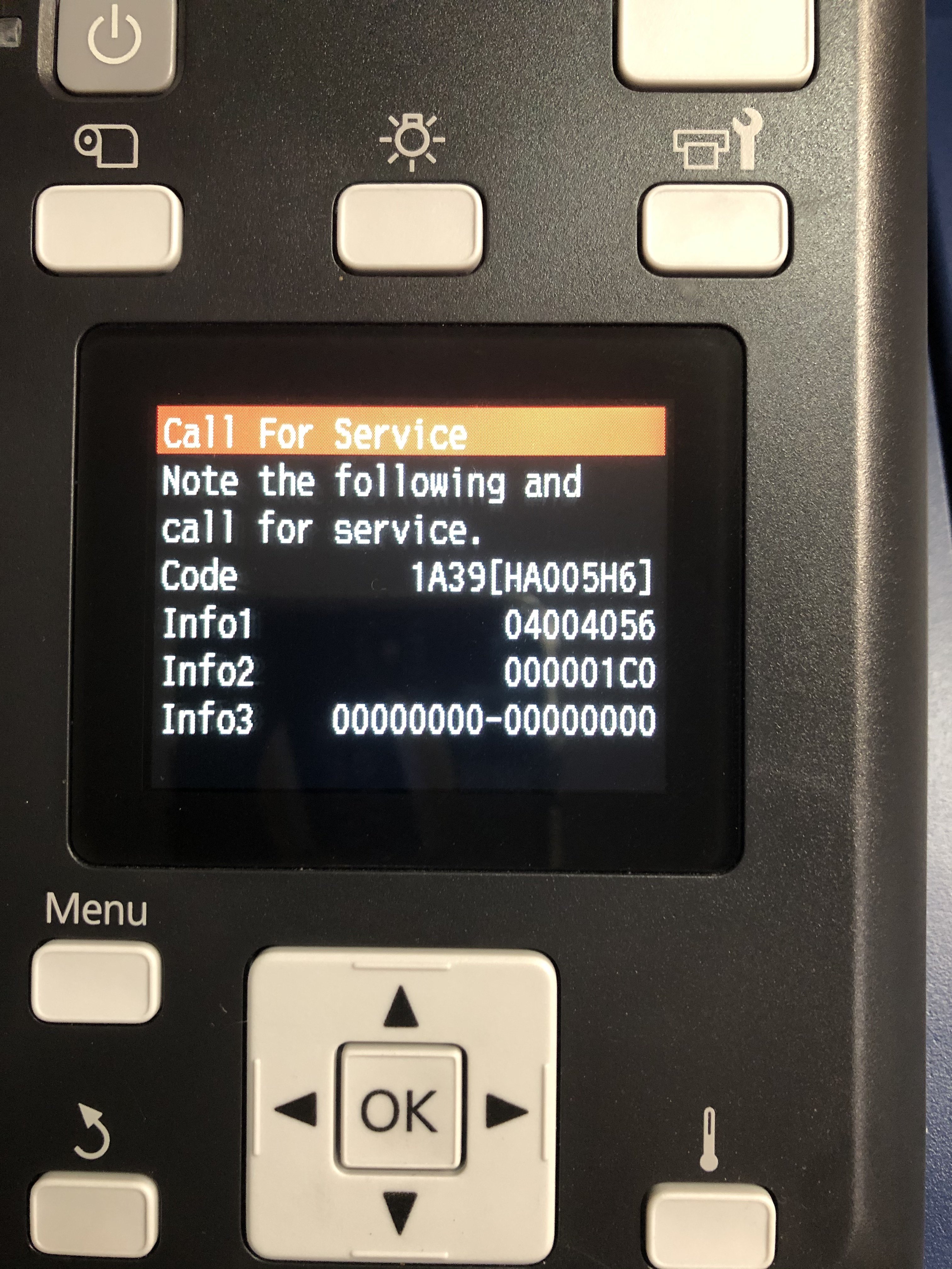

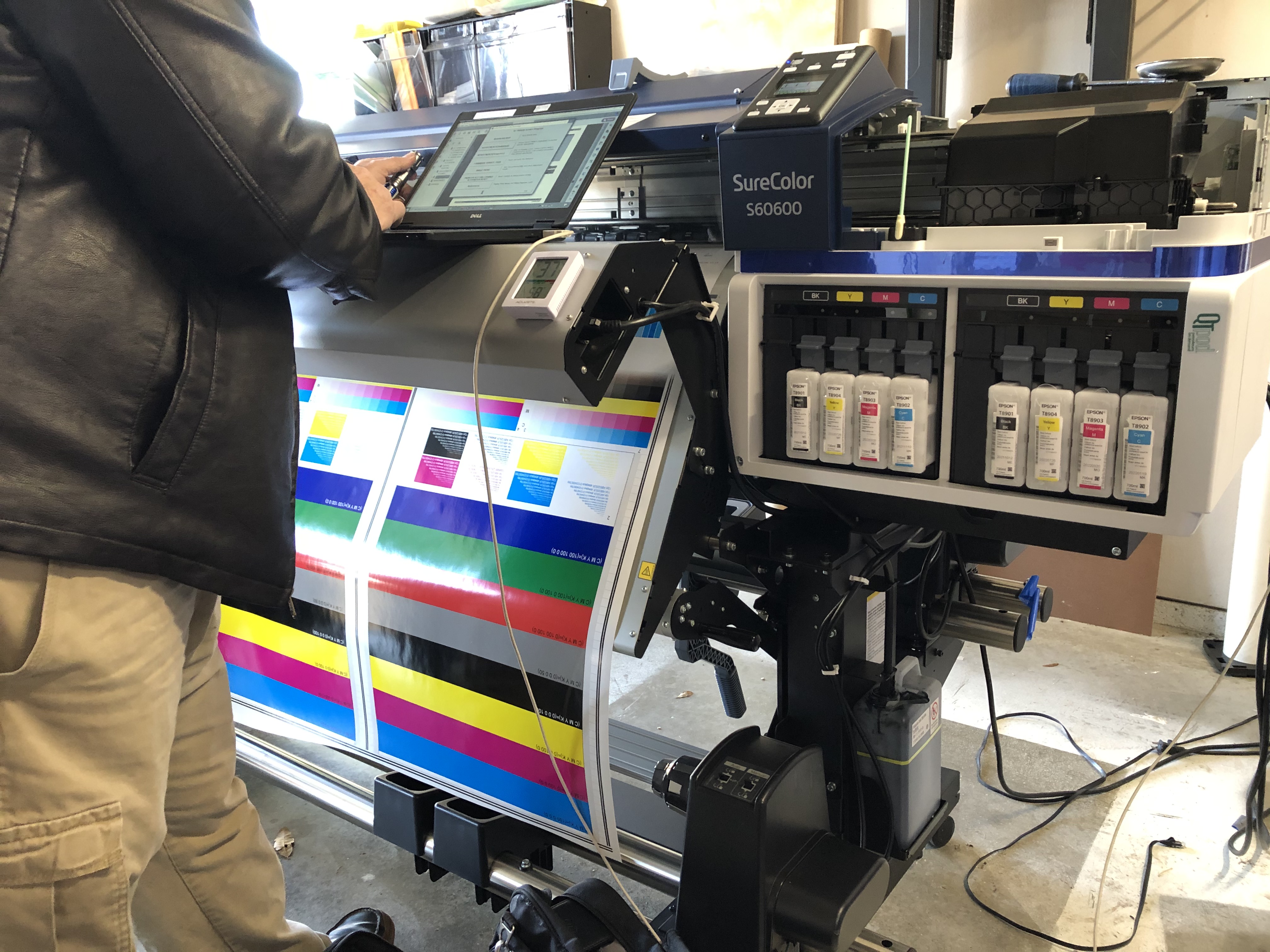

One of our S60600 print heads (right) went bad in between jobs (it had been stopped for maybe 5 minutes max)... One moment it was printing just fine- then we received Error code 1A39. The tech came out to check and this error means it could have been a number of issues. We tried replacing the board before breaking the seal on the new cartridge- Didn't work. We Then opened up the new cartridge and replaced the right head first- all of a sudden it started working and the error cleared. $2,700ish later, the printer was up and running.
