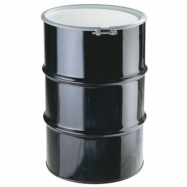

biggmann
Here is the type of drum we are wrapping
these ridges are what is giving me the problems and the prints are small logos on white on the bottom two spots with a checker board pattern on top ( I dont have a picture here at home)
