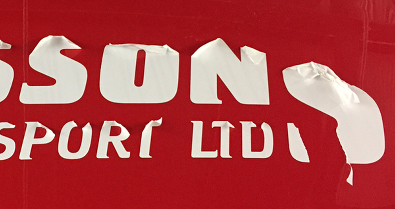

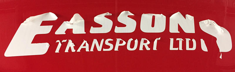

Anyone having trouble with Oracal 751 falling off in a few days?
signmeup
I lettered 7 trucks last week and they sat in the yard waiting for satellite installs so have yet to turn a wheel on the road. The 751 decals on the air dams are literally falling off from the top down. I have been installing these decals in 751 for the past 8 years... several hundred trucks. This is the first time I have had this problem. Same prep as always. Seemed to cut, weed and install the same.
Anyone have any ideas on what has happened. The trucks also had black 751 installed on the sides at the same time that looks pristine.

signmeup
Kinda wondering about that Baz. I only order the stuff in 10 yard rolls so it was fresh from my perspective. No telling how long my supplier had it though. I get about 18 of these decals out of 10 yards so I'm also wondering why the previous 10 haven't done this.

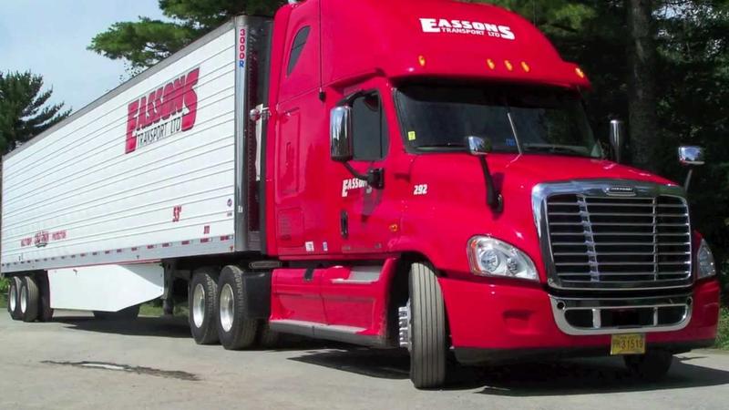

There's nothing wrong with the vinyl or your application techniques. More than likely, something has either dripped on it or some mist has dropped on it as you can see the bottoms and sides seem to be holding quite well. Therefore, something is coming down from the top and ruining the adhesive from the top..... down. I'd look to see what's above these units.
