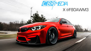

Aside from making covid signage for our local hospital, clinics and restaurants, we have been pretty slow. We are trying to keep everyone busy between covid orders. We recently got an interesting request.
I have a customer asking specifically for a SATIN red chrome wrap. Can't be matte or glossy. Not finding it in 3M, Avery or Oracal. I don't want my installers to be stuck in a nightmare install if the stuff is garbage. Anyone have any suggestions for this specific vinyl?
