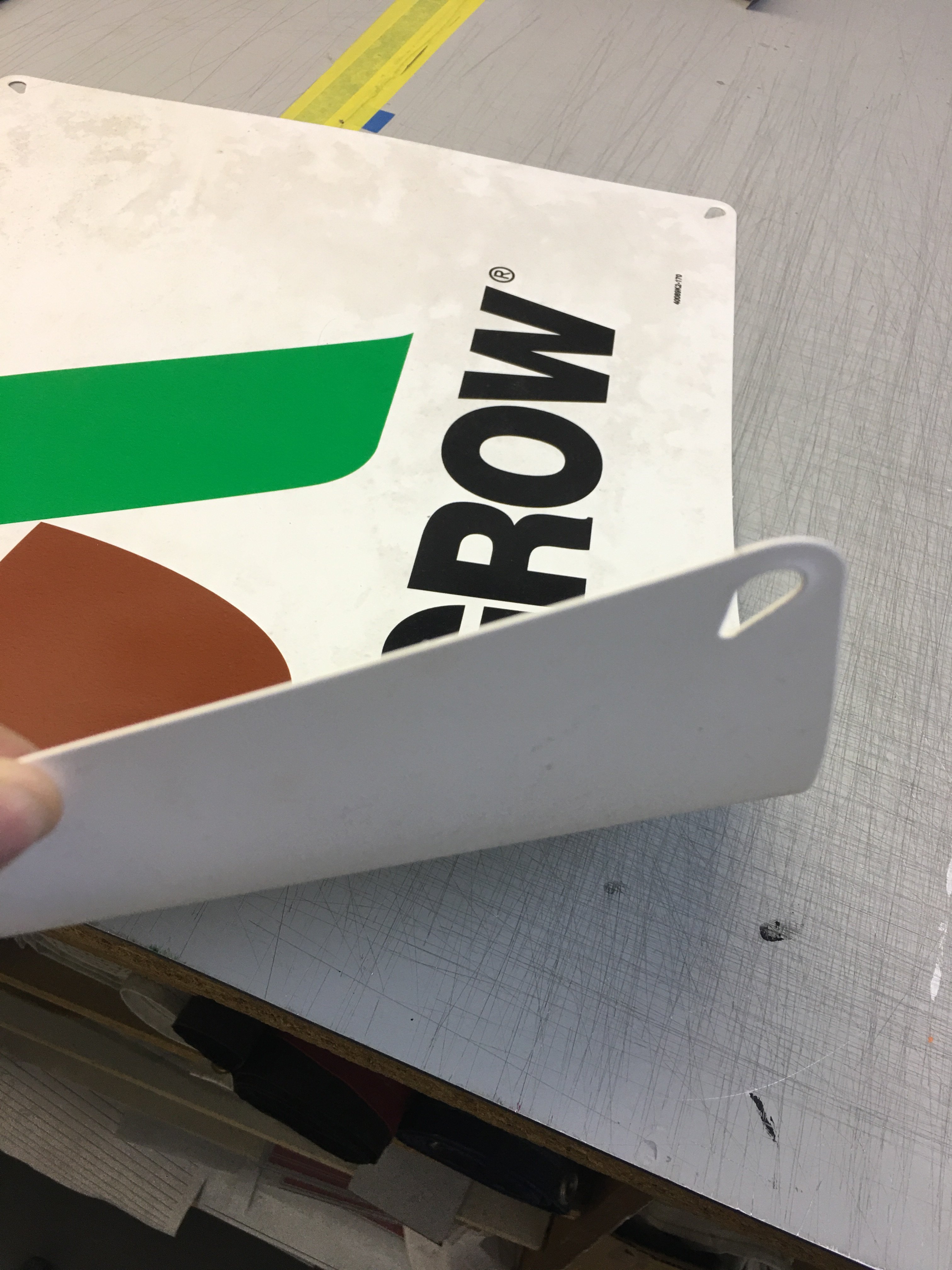

Anyone know what material this is
intense_design
Does anyone have any idea what kind of plastic this is. It’s 1/16” thick. Is very bendable and easy to clean

He said it's 1/16" thick and you all are saying it's .030? or .040? MMMM....no, it would be .060 if it's 1/16" thick. Even grabbing a calculator would tell you that.
Reactions: 2B
Actually, the correct conversion is .0625", so a calculator won't tell you that. ;)
I thought that he may have been just estimating the thickness because from my experience, as we have supplied thousands of these for a local seed dealer, they are .040" thick, at least in our situation. That's not to say that you couldn't use thicker material and Asgrow very well might, but I'd be willing to bet if he put a caliper on them they are actually .040". Then again, maybe not. Either way, he will be able to figure it out. I don't know why someone else commented that it looks like .030" because there's no way you can tell that from the photo. My speculation is based solely on my own personal experience.
eahicks
u need to math more... 2mm is bigger than 1/16...
Correct, it is more than 1/16", but I don't get your point....no one mentioned 2mm.
And yes, 1/16" is .0625", but since they don't MAKE a .0625" thick styrene, it would be .060 styrene.
