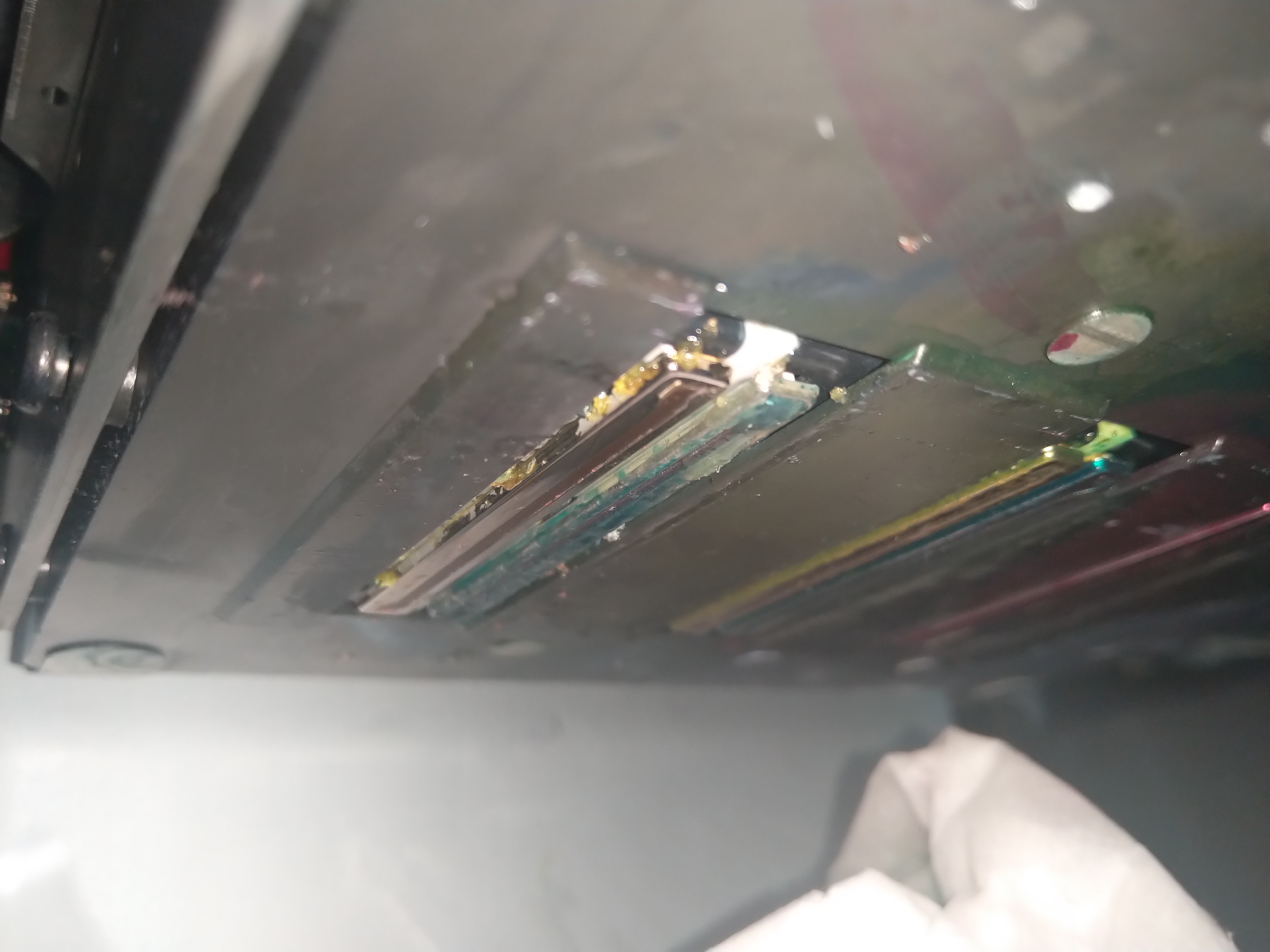

This is a pretty typical scenario with me on the UJF MKIIs with primer, the primer nozzles are mostly fine, but it reacts with the clear ink and cements in place. The Gen5 heads on the JFX200/500 are more durable in some ways and have a single unified nozzle plate and are easier to clean. It's not a guaranteed issue, but one to be mindful of. Good to see if the swap is worthwhile before committing to it.
Interesting, how old is that head? We wipe our heads between every print with a physical cloth and we have no build up, been doing it that way for a year.
Smoke_Jaguar
Usually happens when the printer sits for a few days. Usually fine, but since ink and primer share a capping station (there's 2 sections, connected with a Y fitting). Heads naturally drip and it's a good thing, keeps clogging from being as much of an issue. Since the ink reacts with the primer, it can catalyze. Most people are scared to touch the nozzle plate, good to wipe them down. Just have to be gentle, use a clean surface on each swipe with a Texwipe and some flush or maintenance fluid 15 (or similar) and you're fine. Also applies to Gen5 heads as well as the UJF's CE4 heads.
First UJF 6042MKII I had was a toasted #1 head. About 70% of primer channels worked, 3 nozzles of clear. If it was on a separate head, I could see it being less of an issue. Suction wiper in later revisions helped, however the JFX200 (and EX variant) just uses blade wipers.
crashaffinity
we have the suction wiper so that's good, but i'll keep an eye on it for sure, we did order the cleaning fluid for the primer channel and i was wondering why it warned not to use it on the other heads, so i haven't used it
