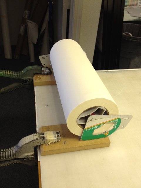

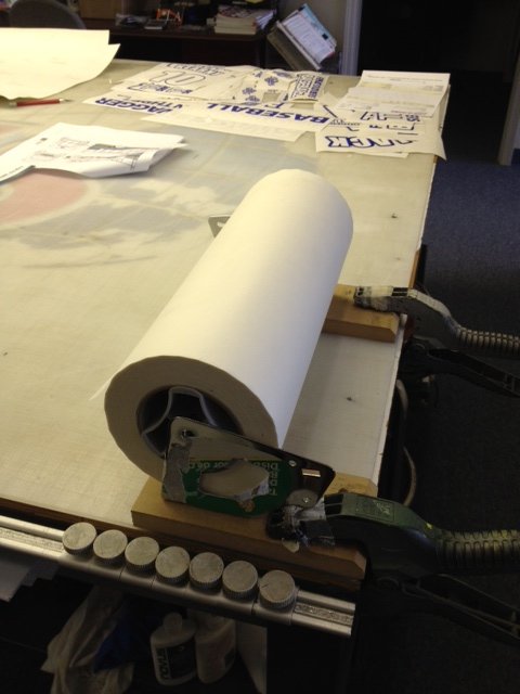

Here's ours....it's made form packing tape handles! Just took the handles off, bolted on to 2 blocks of wood, and clamped to the table. The tension on these is adjustable and easy to change rolls.

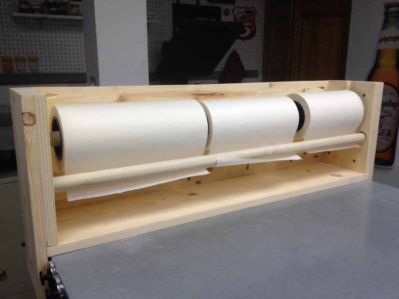

After seeing this post a couple of months ago, I decided it was time to upgade mine. I got to the shop a little early this morning and finally made a new one.

With this, how do you roll only one of the rolls at a time? Don't all three start going? Is that a problem?

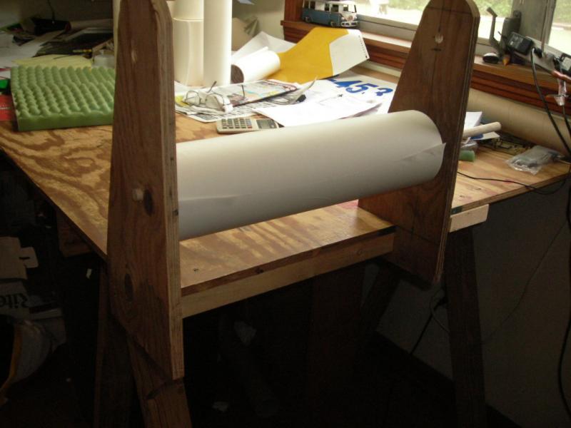

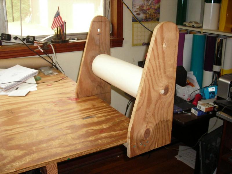

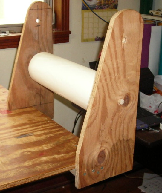

Here is the one that I built. I countersunk the screws on the table top and used wing nuts for e-z removal. I like being able to drape extra material over the edge of the table for those extra long pieces. Scrap MDO, gotta use it.
