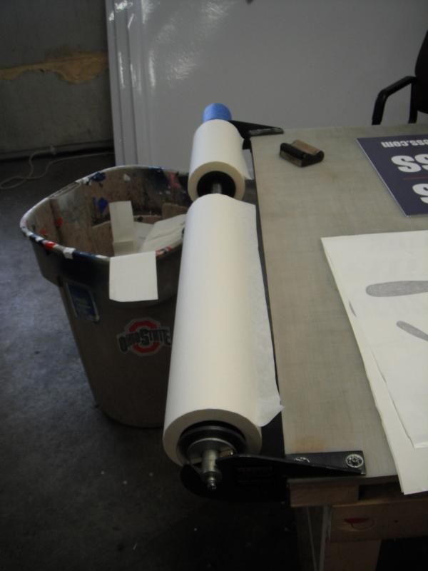

Here is mine. All recycled materials - 100% green - no carbon footprint (unless I burn it).
It has an "L" angle on the back that hooks against the edge of the table.
The harder you pull the tighter it holds.
Makes it easy to move on or off the work surface without clamps or screws.
It's patented, so if you make a copy you can't show it to anyone......

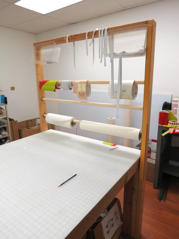

2x4's screwed to the table legs, dowel rods with pole mounts; one the dowl removal end; the other the complete circle. Has worked great for years now (dowel has never fallen out). it's easiest from the bottom dowel, so we mostly just use it, but I can use the 2nd one up just fine also.
The junk hanging over the top are my home-made roll wraps; scrap banner slices 1/2" wide with velcro on each end; work GREAT.

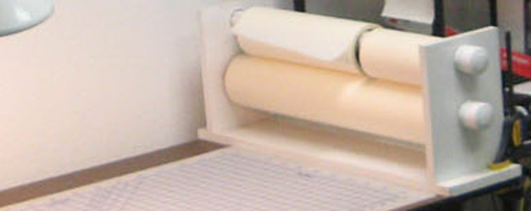

I inherited mine from the estate of a very talented signman and good friend, Woody Peabody, amongst other things. Simple design and works like a champ, just like Woody. It's about to come off the table and move today because the crew is on the way and today we move the shop! Goodbye terrible parking, high electric bill from no insulation and terrible plumbing!

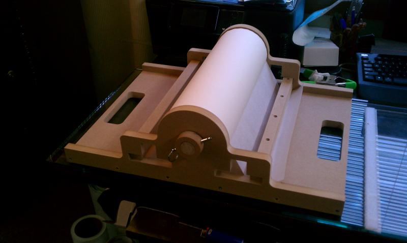

2 x 4 scrap around the shop. Been using this one for about 6 years now. Routed slots on inside to make it quick change. Use 3/4 pipe with shipping plugs on each end. Also use shipping plugs on each end to keep alignment when laying it down on our 10 foot steel table.

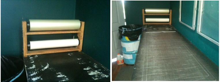

Similar to others.... just some MDF and PVC tubes. Been using this for about 12 years

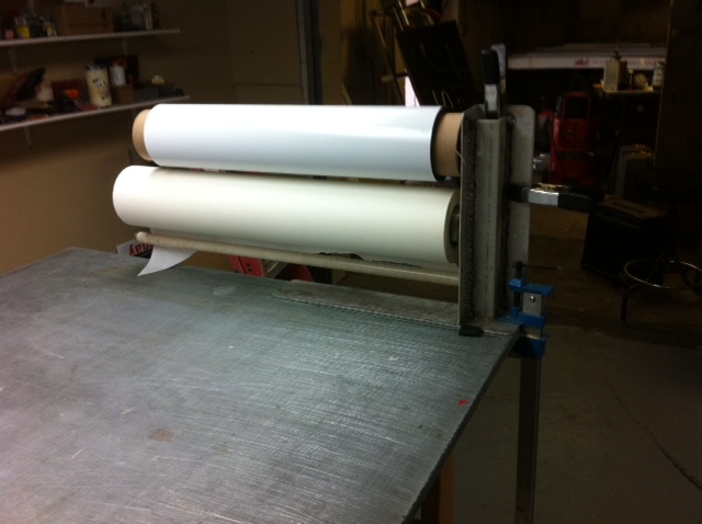

Best one I've got so far and I'll never go back is what I've got attached to this. It may look like a bar but it has a tension setting on it. Keeping the tape firm as you pull it away. So putting application tape on long sheets is a breeze and we hardly ever have a Transfer Tape Malfunction anymore.
I don't know where it came from as I got it from a lady who was closing up her shop. But looking for something similar with a tension setting in my opinion is the way to go.
