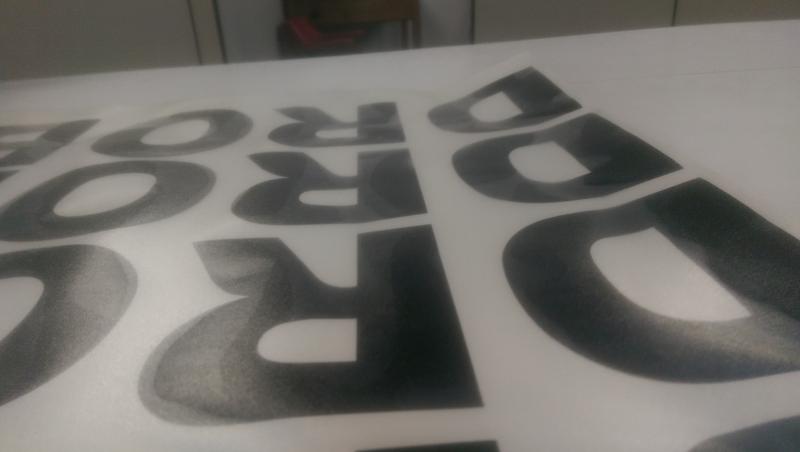

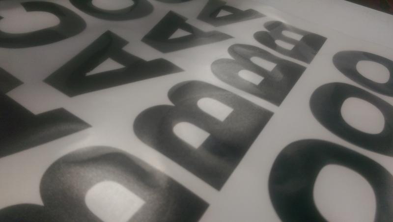

having an issue with application tape tunneling. attached pics not the easiest to see but believe me it's tunneling.
was using r-tape at-60 and this started happening so i went to a more aggressive tape, at-65 and it's doing it again.
any suggestions on a fix or different tape to try. i prefer to use a clear tape for easier install line up.

Clear tape has done it to me. Usually when there is too much tension and sometimes w/ temperature flux.
Suz
The clear stuff doesn't work so good for me. The masking tape style is hard to see through Yes, but it seems more pliable, more flexible, and with better tack. I haven't found a clear that I'm happy with yet and have gone through lots of this stuff. Due to the problems you mentioned, my clear does not get used nearly as much, especially for larger work. Too many problems here. I have wondered if being in WA State with lots of moisture in the air would contribute to the issues I've had. Anynow, good luck. I agree though, the clear makes the line-up part easier.

I would suspect that the adhesive coating on your transfer tape was a bit lacking as you said the problem was intermittent.
Cut out a piece of the raised tunneled part and test it’s tac by applying it to another small piece of vinyl and the pull it off
There are a lot of different formulations for the pre-mask “tac” level.
(ie. Hi -Med - Low)
Most Pre-mask and masking films use a rubber based adhesive not acrylic...
Translation when you stick down a rubber based adhesive you get what you get at
that time not much more over time like acrylic adhesives do…
So when you work with a pre-mask applying less or more pressure will do little to change the adhesions end result.
However you do have to… by hand or by laminator apply pressure…
Tunneling is usually a result from rolling up the pre-masked cut vinyl.
You can use pre-mask that is designed to adhere to the exposed areas of the silicone release paper as well and this will help resolve the problem.
Try this... (I don't work for them or sell it)
TransferRite 582U is a medium tack application tape workhorse for general use. Once a graphic is weeded, 582U adheres to areas of exposed liner and does not lift on the corners, tunnel or "dog ear". Rolled and stacked graphics remain smooth and ready for installation.

thanks for the feed back and i am using a laminator. the thing is this doesn't happen all the time that's what gets me. wondering if it's temp or humidity thing. also was thinking maybe loosen up the tension on the laminator.
S'N'S
I apply with squeegee and it tunnels every time regardless of how much pressure I use....haven't tried the "upside down" approach. I find it squeegees down ok, but left on the bench for a couple of hours and it's tunneled, which I think is the mask pulling back after stretching while squeegeeing.(I don't use it very often now)

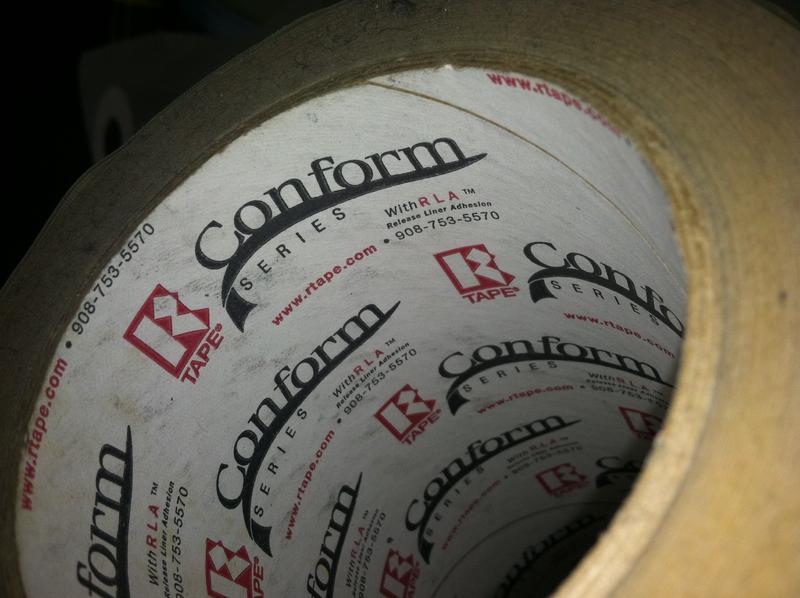

We have a few rolls of R-tape that are old from our old shop that are yellow and smell like brown sugar and have a hatchmark texture to the face. they are old and not really sure the product number but they are great tapes.

that's it! Find your old invoices for the model number lol
AaronSSsignsKC
old yellow r-tape

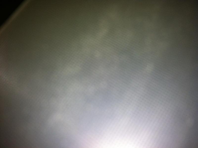

Hey i checked to see if i could track down the product # for this stuff but no luck. the one thing i did notice is the marking inside the core is a different artwork than the normal r-tape or I would assume the newer tapes. but anyway here are acouple pics of it you can kinda see the hatching ontop but its not the best photos.
