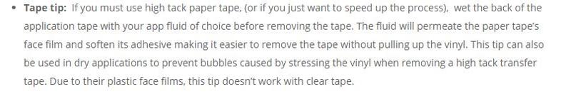

Most brands of paper transfer tape come in low / medium & high tack. You can also lay the vinyl down and wet the transfer tape and let it soak for 5 minutes, makes it easier to remove.

contact RTape, they have NUMEROUS adhesive grades and will send samples to test what works
bulldozer
we spray windex and spread it around by hand to lightly wet the surface, then proceed to peel. no ammonia formula of course.
Isn't it still wax based? Do you do this before laying down the vinyl or after it's been applied dry? It seems like his would cause the vinyl to not stick as good, as well as leaving wax residue behind to deal with before painting.
bulldozer
after laying the vinyl to the substrate on top of the transfer tape. helps release the tape from the vinyl.

The water trick sonds viable but paint and water dont mix to well generally you want dry surface. I guess if careful then the water wont get on the wall that will be painted. Does the water not seep through the transfer tape to the vinyl?

Well I'm going to try rtape "at60" that's the clear pre mask low tack. Any body use that stuff? I have real doubts about this. I'm thinking I'll still have to do my pre stick system. I just did it again ( the pre stick system) and it worked but it takes a lot longer to apply the pre mask. I was using main tape clear medium tack.
Jwalk
Ok so I tried the at60 I sort of jumped the gun and practically bought a life time supply. Now I'm thinking maybe medium would of worked?
I love the way it comes off when the vinyls on the surface you want almost fall off, that part is perfect... However it struggles to keep the counters of the letters stuck to the transfer tape , a lot of fussing with that now.
I suppose its what do I want to spend my time doing. I appears fussing will occur some form or fashion. Really tight and intricate stuff maybe something more tackier, big stuff this would be ok.
