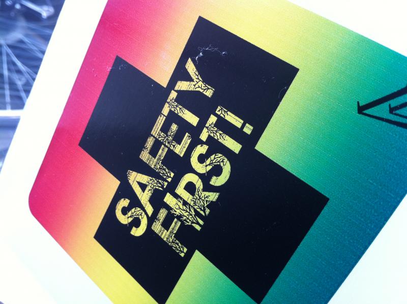

Hoping this picture helps diagnose the problem. DPF8000 printed on sp300v. This is using the sp540v profile on my sp300v with full width scan turned ON account for smaller width.
You can see the banding and on the red and green ends, the ink appears to kind of "puddle" up and appear blotchy. I also want to point out the BLACK does not appear banded in any way, and is actually nice and solid - i just noticed this. Does this appear to be a feed calibration issue?
(I also tried full width scan + slowing head speed to 500 using sp540v profile with same results)
Thanks!
All other medias print this exact file/image perfectly. So I have get that it's a profiling issue of some sort.

splizaat
Hopefully i can get to the bottom of this Prowraps, cuz I do love this particular material, I just can't get it to print correctly....yet. And arlon tech support hasn't been helpful
splizaat
Switched to Roland's MCVP with full width scan on....andddddddd... BINGO :) Today I did a LOT of testing on these samples I got from Arlon of 6000XRP, 4560GT and 80000 and came up with the best print results as follows:
Arlon 4560GT w/ Roland GCVP Profile
Arlon 6000XRP w/ Roland PCV2 Profile
Arlon DPF8000 w/ Roland MCVP Profile (and full-width scan turned on)
Hope this helps anyone else trying to use Arlon on their SP300V. Their theory of using the SP540V profile and slowing head speed had me running circles. Finally got smart and tried some more roland profiles and came up with good results with the above settings
splizaat
DPF8000 using the sp540v profile with full width scan AND the head speed set at 300mm/sec gave about the same results as the MCVP profile with just full width scan on -- but MCVP prints MUCH faster. If you find any other tricks lemme know!
