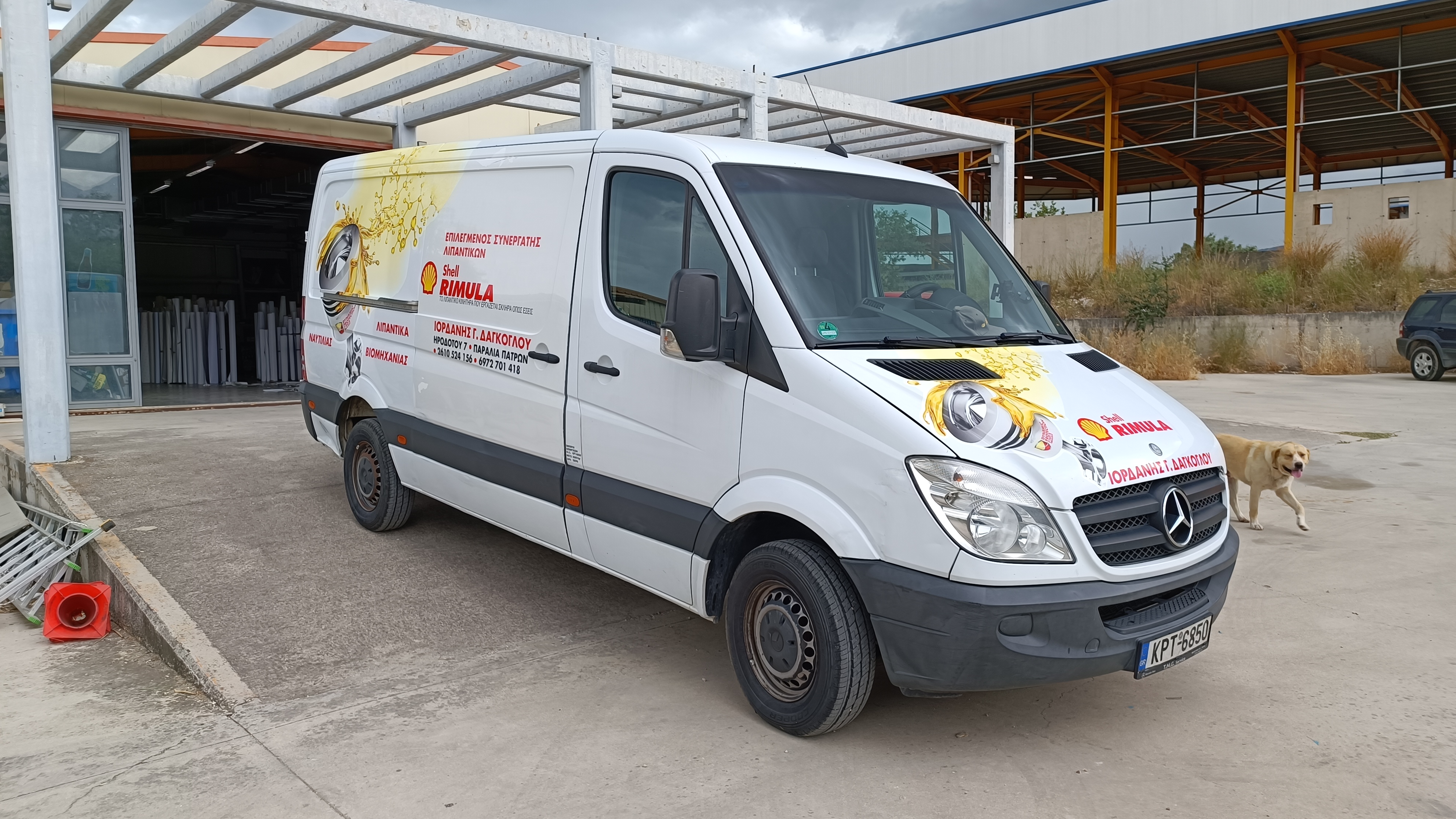

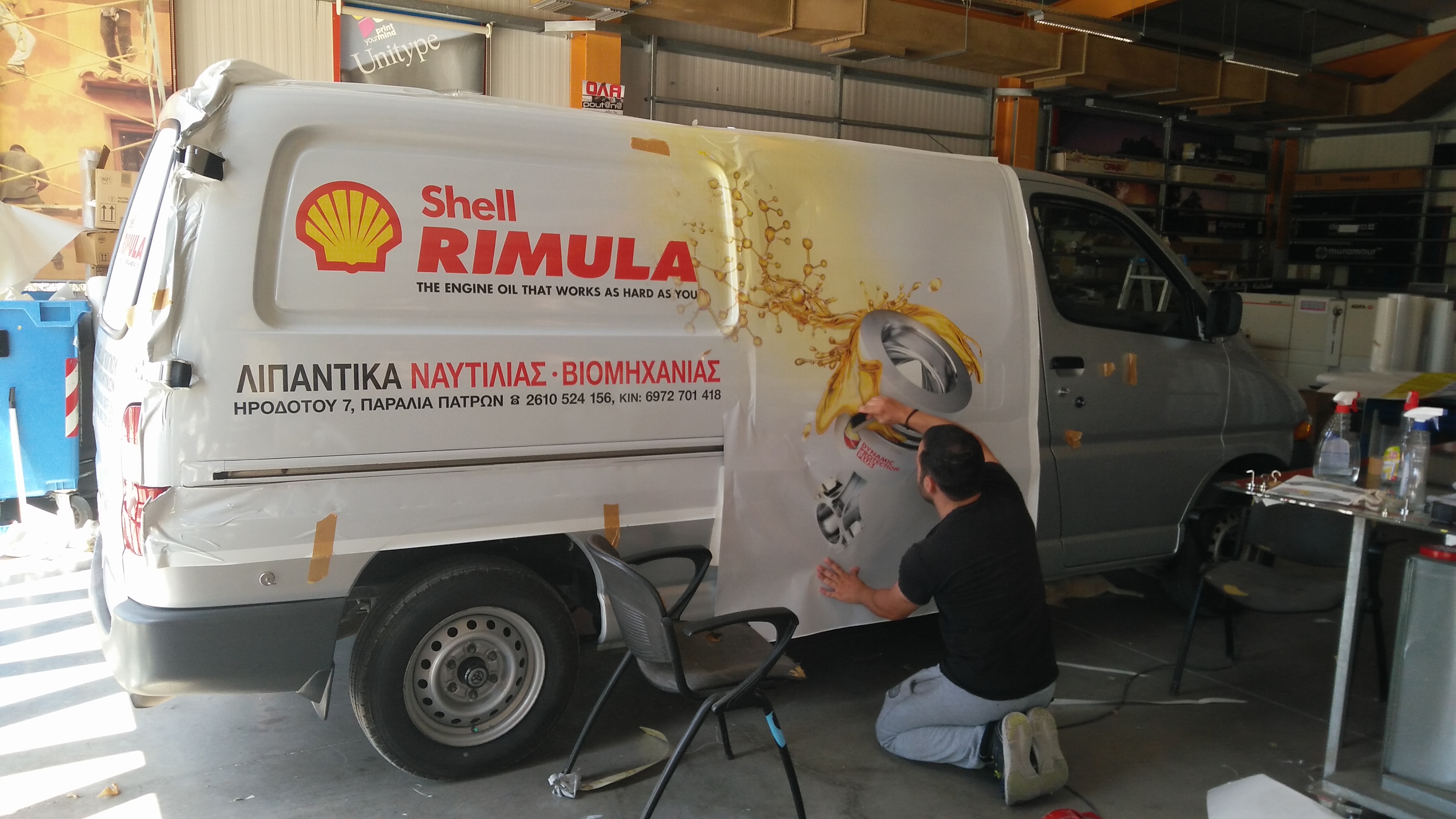

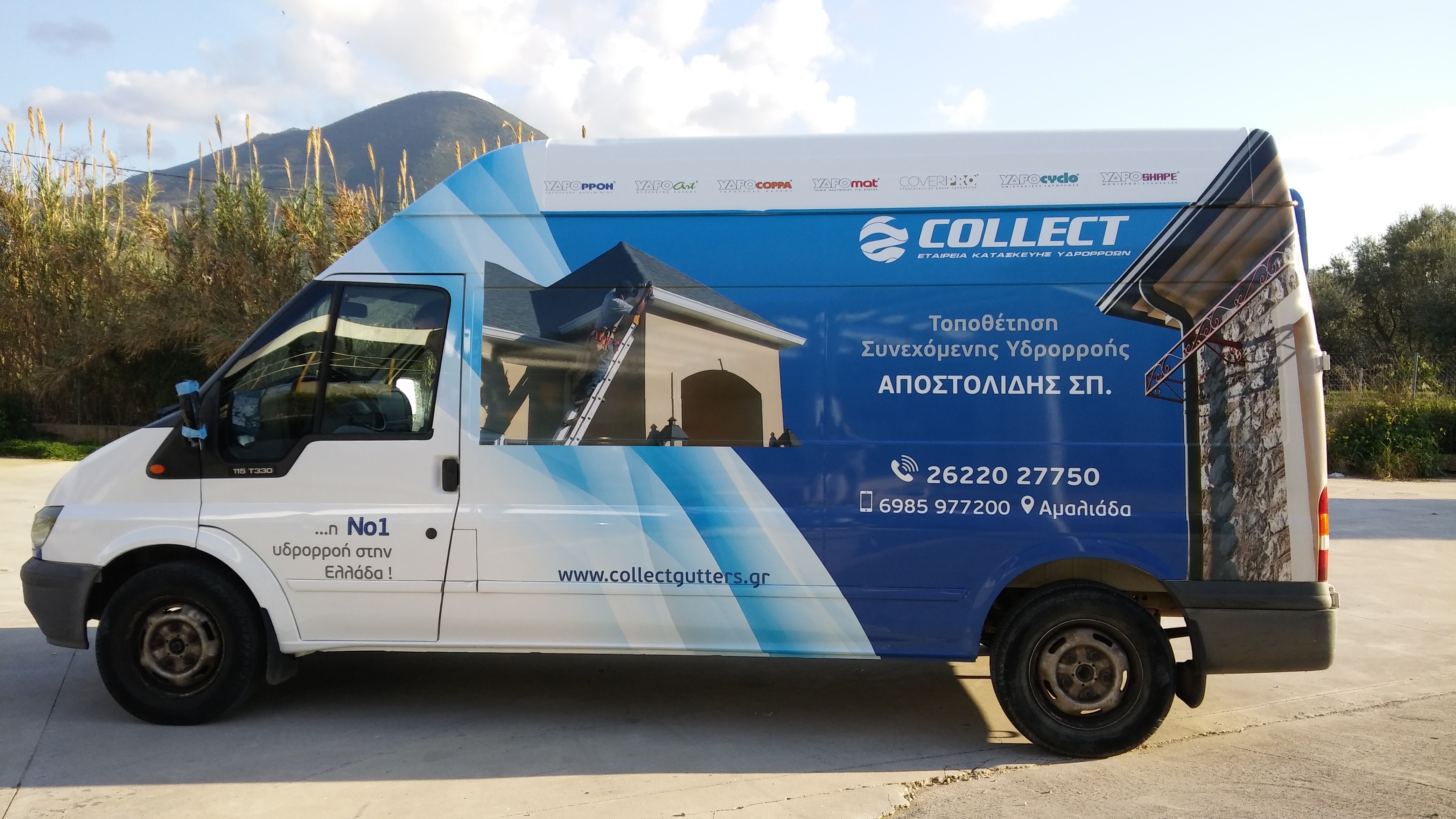

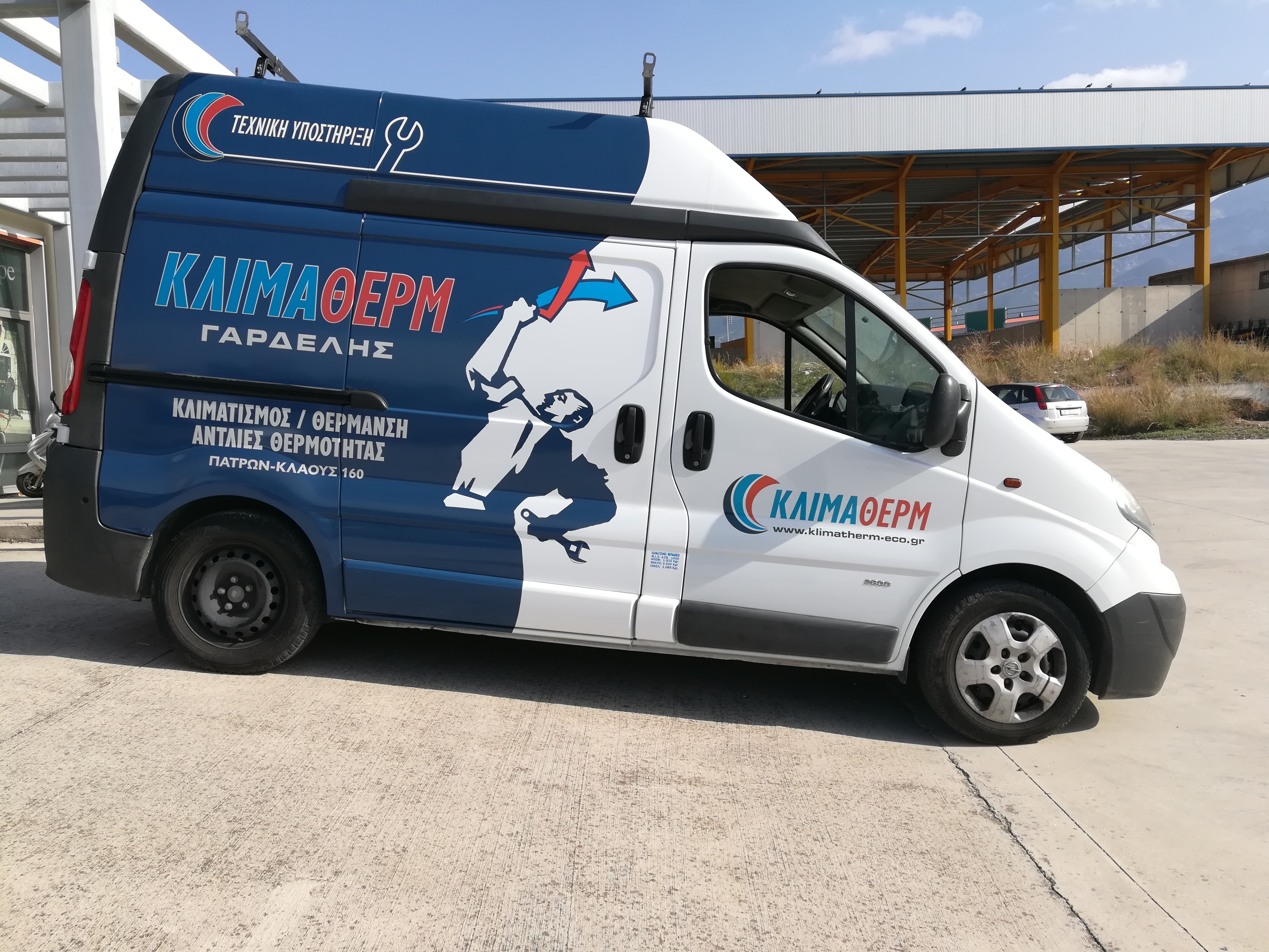

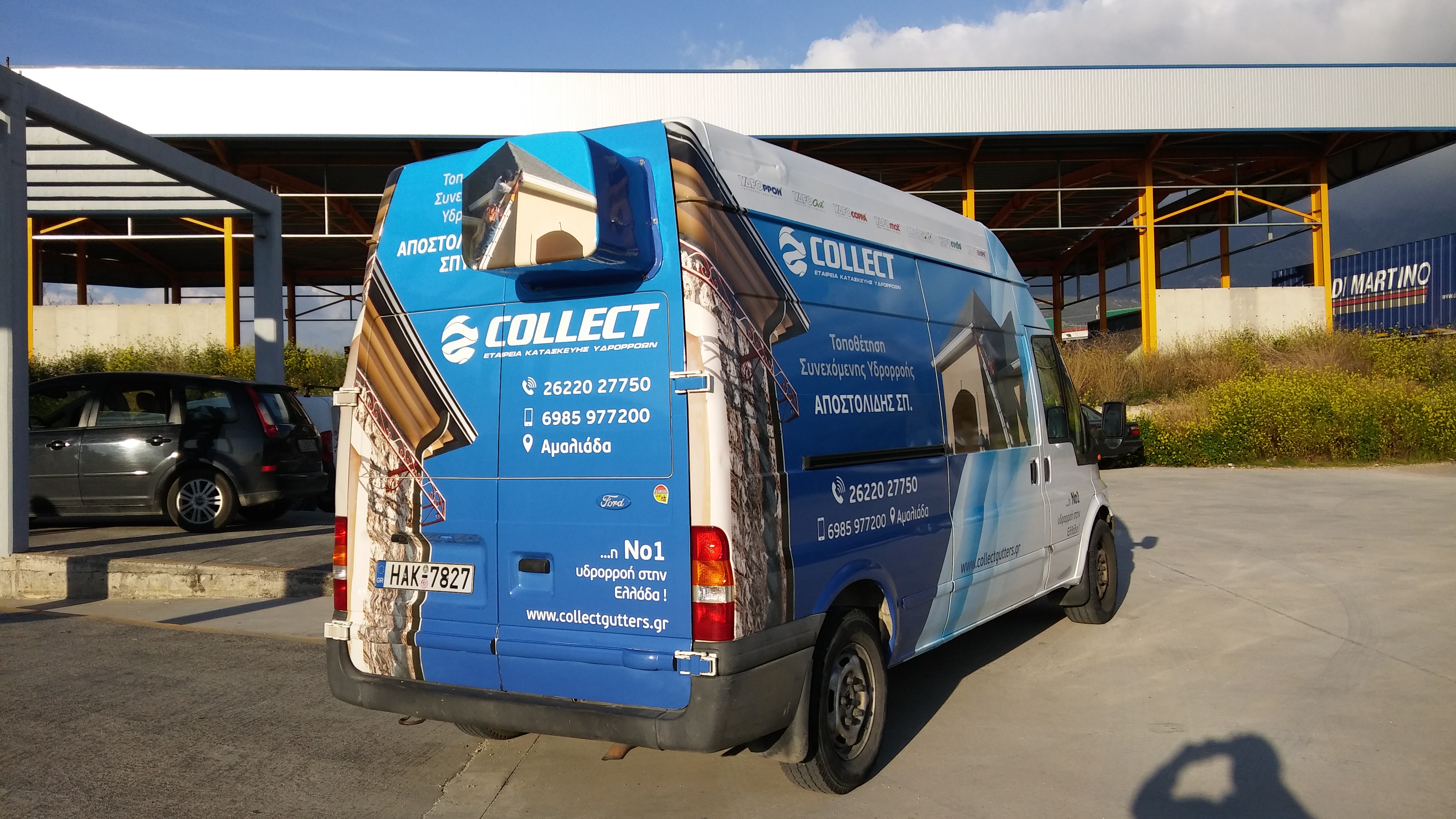

SLX+/3220 lam. Our beloved material for car Wrap!!!
We've wrap over a hundrend cars here, Patras Greece.
It's amazing!!!
Don't be afraid of the material and check Arlon's training videos for this.
Wrapping with SLX+ is two third the time than using Avery 1105.
And the print quality on our Epson SC-80610 is great!!!
