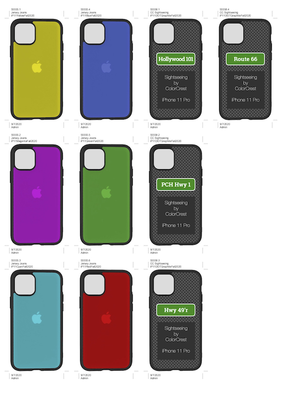

This is better handled at a more accessible and efficient database level as opposed to a more closed RIP software. Of course I recommend FileMaker as the database platform because that’s the most affordable option for sign shops. With the many touch-points and data-points involved, using FileMaker with it various built in engines can make for a centralized solution for overall control and scale. In this case, FM’s web publishing engine for PHP and XML along with a print engine feature to gang elements.
The basic workflow is that a PHP website accepts a customer’s input of data directly into a FileMaker database for their order info and their design options into PDFLib templates for the graphic and text elements. At this point, using FileMaker as the shop’s order management software, the order is active and already populated with the necessary data. The customized PDF is linked in the database which a CSR should verify by simply looking at the design.
When there are enough orders collected for a print run, an operator prints directly from the database using a layout which gangs files (12-up in the case of the OP's jig) to create a single, short term file for the RIP to print from a hot folder on the network. For small products such as phone covers, many shops choose to print as TIFF format for the interim file type and to use as a proof for customer’s approval. The data and the original PDF is always memorialized in the database.
I've offered a relatively inexpensive method if, in fact, you desire to keep things "in-house" and under your complete control with scalability at no extra costs.

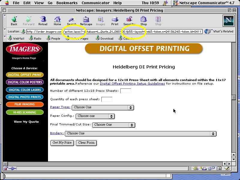

See the attached images. One is a gang print example generated via FileMaker. On the second, notice the ".fp5" portion of the URL which indicates the site of 20 years ago connected directly to a FileMaker Pro database version of the era. This site is from before PHP became widely popular, therefore used Lasso.

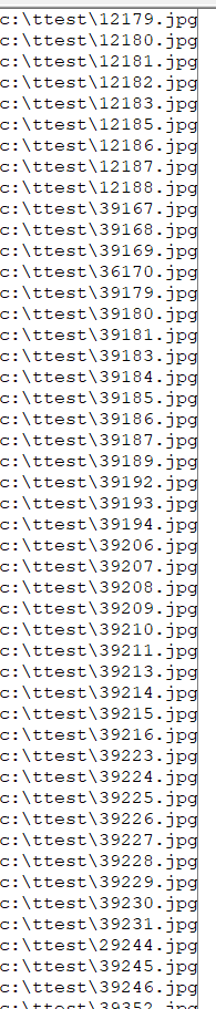

Variable window - Windows > Variable
Then you import as a .csv file. Text is just "Variable1, Variable2" etc, Images get places as "@Variable3" Etc.
What I see in the video is the user manually entering a different path name into the spreadsheet in order to link the variable image. That's a deal-breaker.

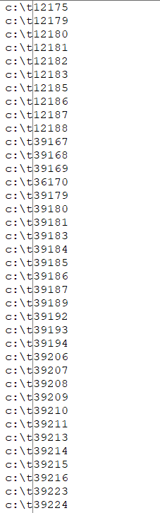

The JS script that I'm aware of is literally 5,000 lines of code which has been at GitHub for two years.
Not really a solution for web-to-print, but could be useful none the less.
As long as theyre in the same directory, it takes about 10 seconds in notepad ++ To enter a directory before the text, as you can enter text via coloumn. But in theory... your web to print software should be able to auto enter this information in an excel file.
