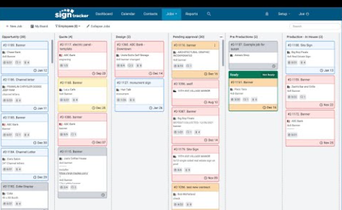

I use SignTracker. You can check out their site and I think there's a free trial. Each employee can be loaded in and assigned daily tasks. There is a super easy work flow board, calendars, etc.

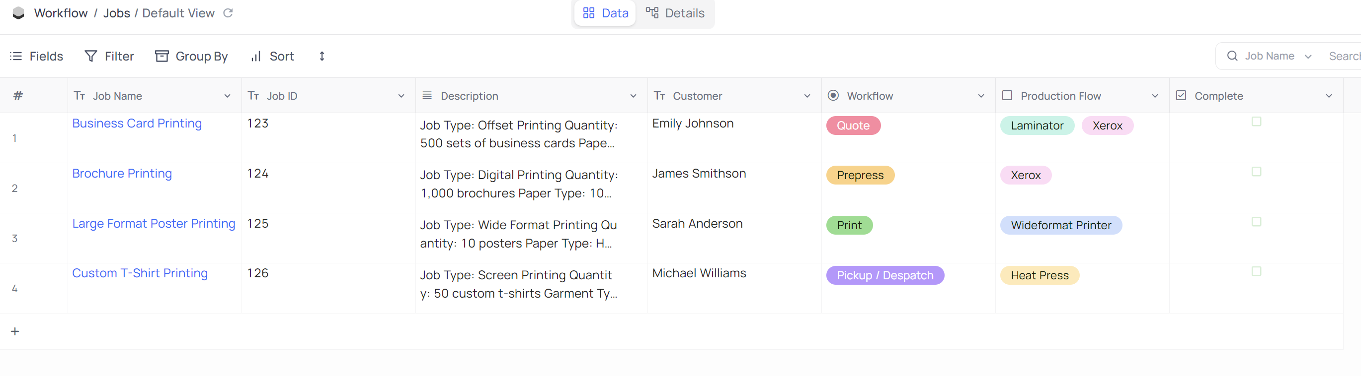

You need something like this. This is a 5 minute demo board i created for visual purposes. But it has the basics.
This is basically a database / spreadsheet style board.
Great thing is, you can have multiple views per station, So in the quotes, they can filter the "quotes" or the prepress area will only filter the "Prepress" When it's ready for the next department, you can just change the bubble.
You can use checkboxes instead as a progress. After each step is completed, you can check it off. You can set a filter to display "if quote and prepress boxes are checked" for the print area.
With this particular app NocoDB - https://nocodb.com/
I like nocodb as it's API is amazing and if self hosted, you can connect it to any database you want.
You can a form so who ever is filling out the table can have a form view for simplicity to input jobs.
You can upload files
Contact list and link them to the jobs.

Thanks for the assist! It seems i can’t open your link. Do you mind sending it to me by email? I’m very interested in checking it out!
