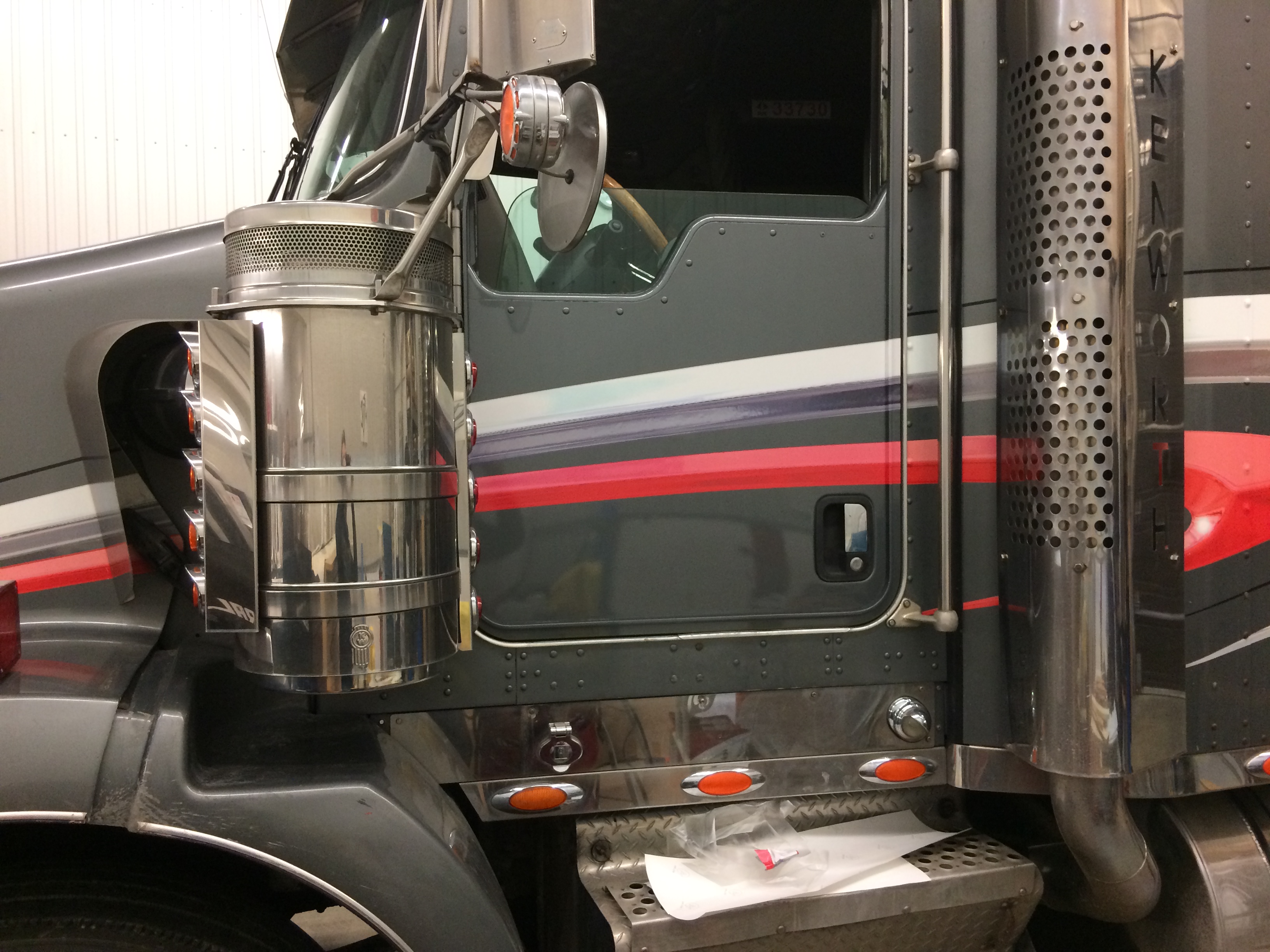

'Did a dk. charcoal Kenworth in 2007 with printed graphics (Roland OEM inks), client came back this summer asking to reprint doors sections because they were repainted. 'Found back the original file in one of my backups, reprinted the middle sections of the kit and BAM!!! it matched like 95% w/o any adjustment (anyway I went from SP300/ColoRIP/OEM MAX inks to VG2540/VW/OEMTR2 inks. Honestly, I was KO after noticing it takes a photographer eye to find the tinny difference. 2007 - 2021 on a big rig, dark paint color, under every natural elements, 4 seasons of eastern Canada, wash with industrial soap and steaming high pressure every weekend. 'Couldn't ask for more. Printed on Oracal 3951G + 290G
