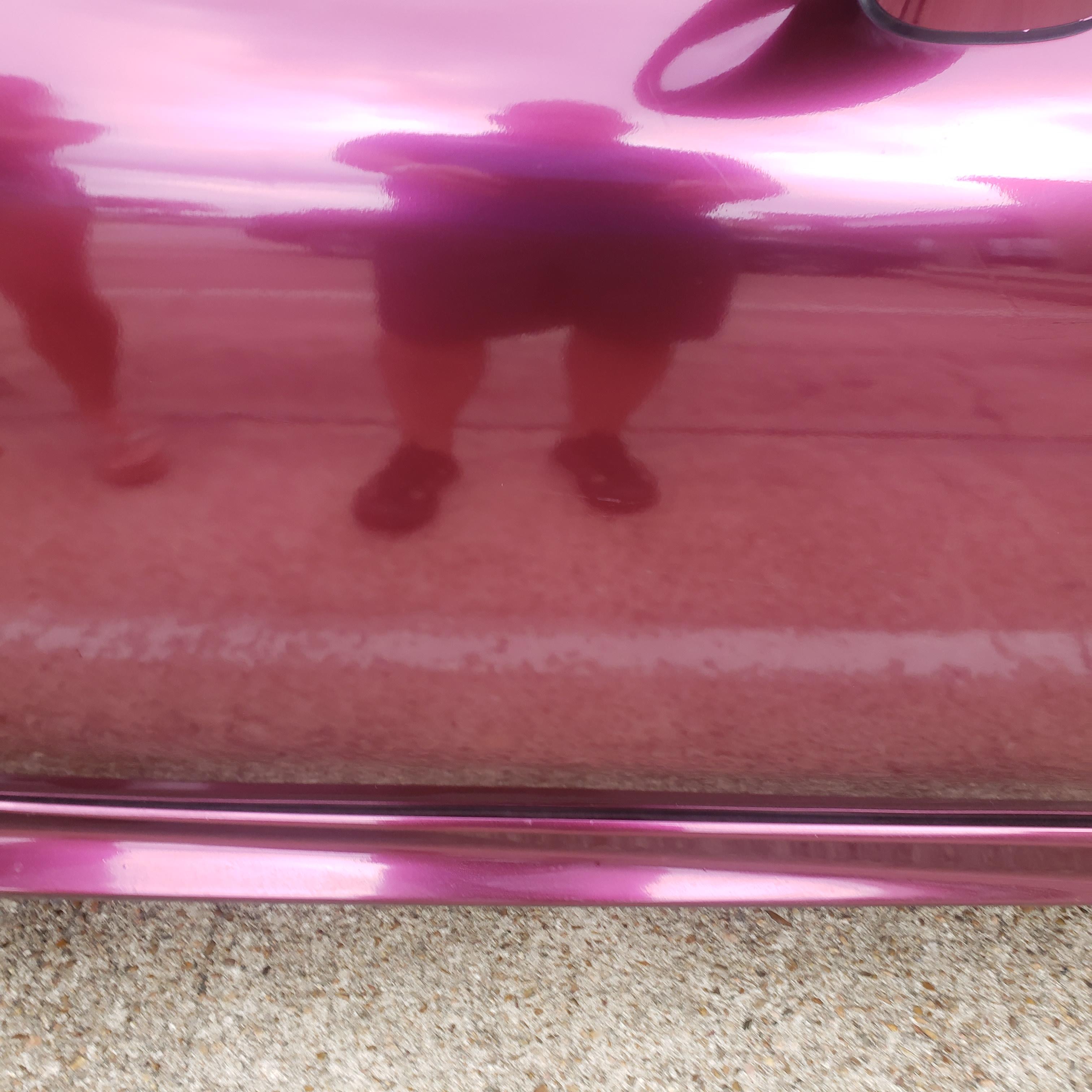

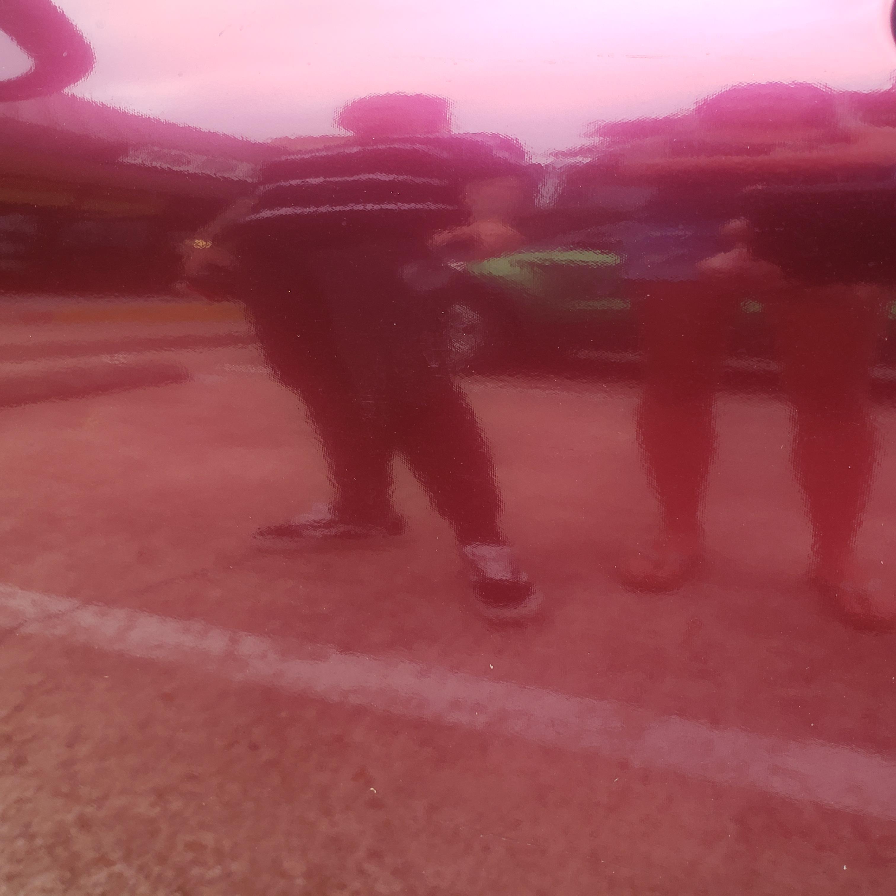

Alright my prends. I know some of you love avery dennison...I have a couple of customers who has come back with color change wraps that have black dots (kinda like orange peel) on the horizontal surfaces of the vehicle. One vehicle in particular, the dots are starting to move down the sides.
anybody have any ideas as to why its happening? you can't FEEL the black dots and one customers seems to think the wrap is "disentegrating". However, it truly looks like possibly chemical droplets? I am just trying to figure out whats happened.

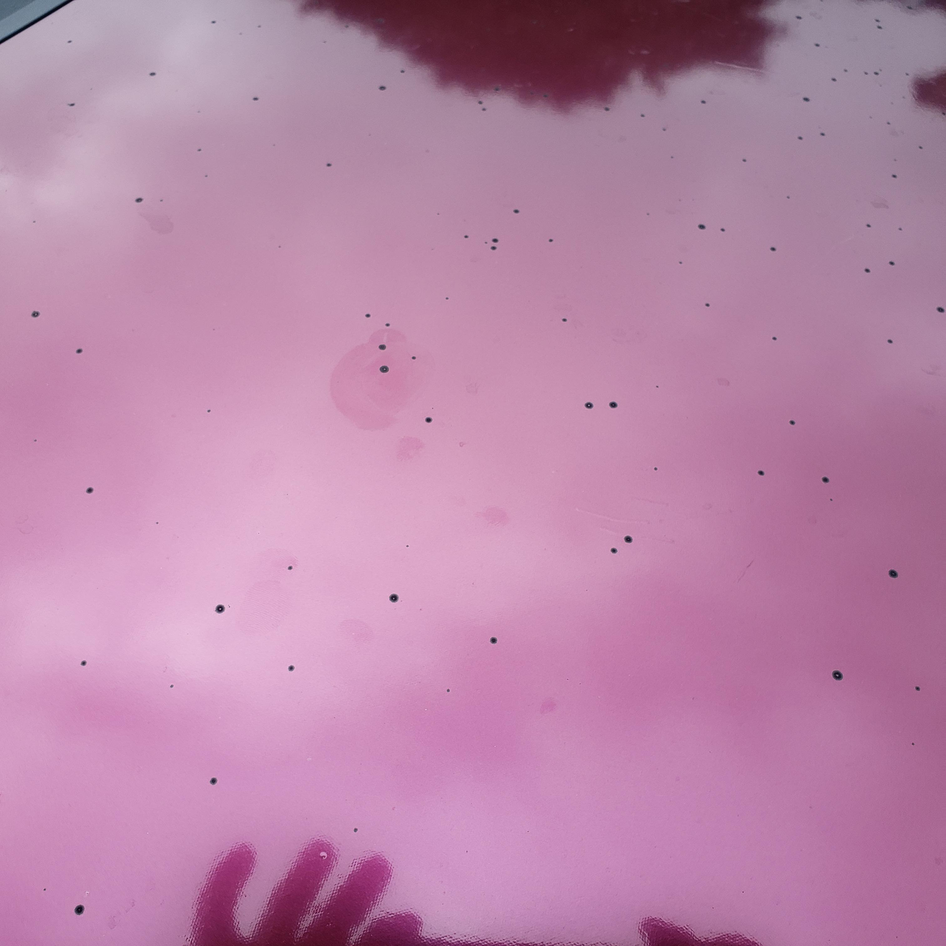

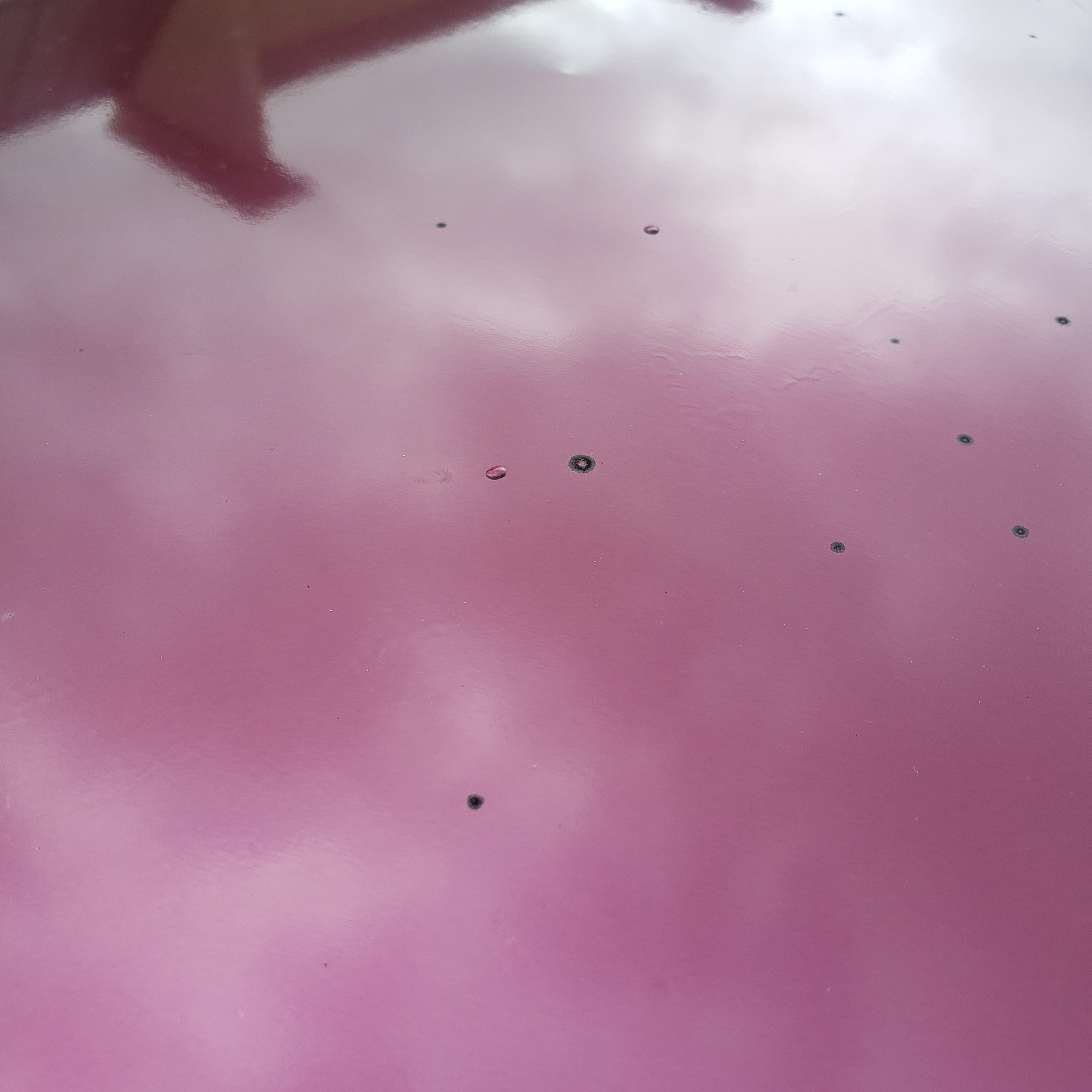

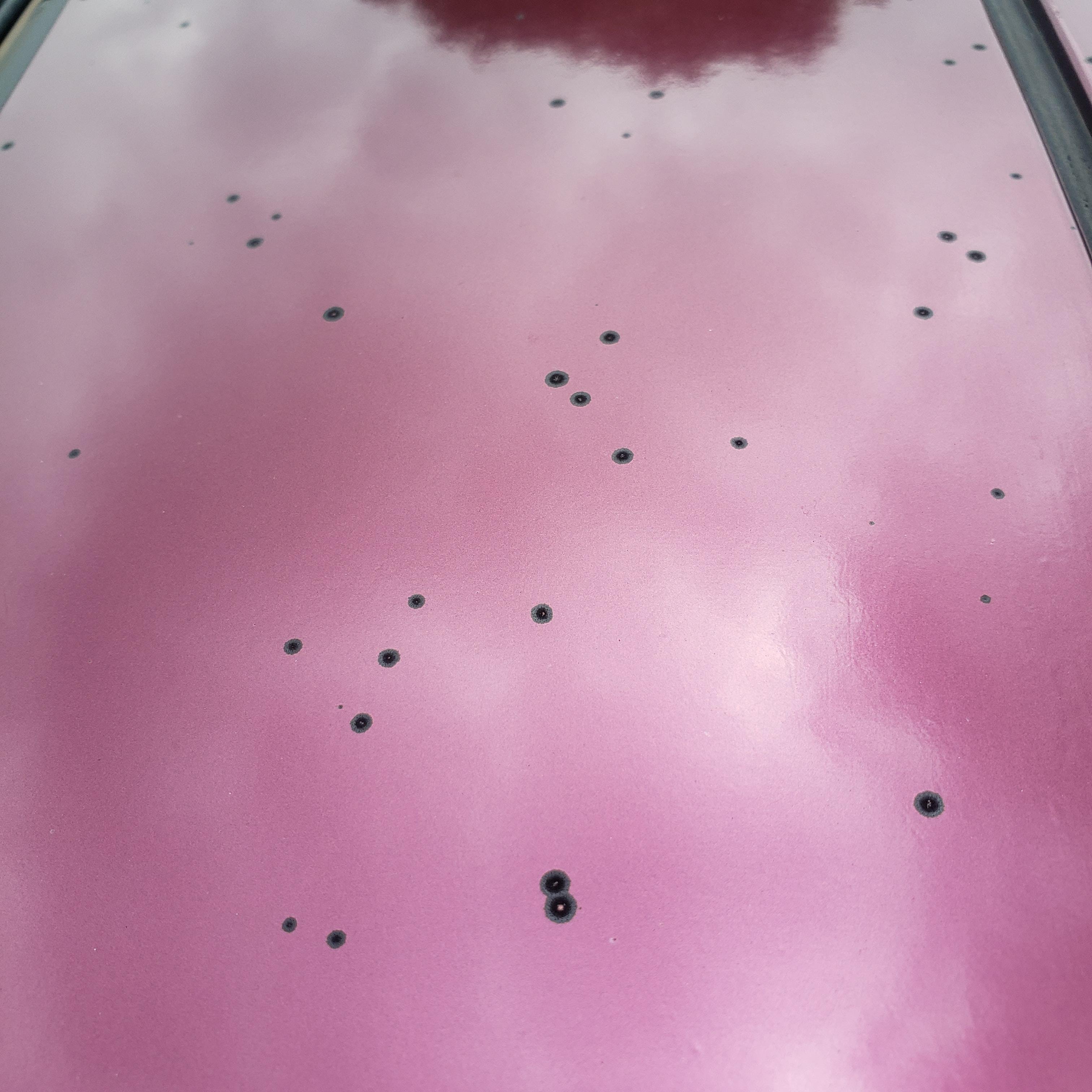

so, it's not sap. you can't feel it. you can't clean it off. its on the horizontal surfaces but it's making its way down. We have seen this on 2 of the cars that we have wrapped with avery. This one was done over a year ago and the other one was done over 3 years ago.

Ask them if they park the car anywhere near a burn pit or something. The debris from the fire can fall on the car from a good distance away.

Looks like mold almost. I would get a hold of your Avery rep and have them come take a look at it.

Get out your loupe or a good camera with a macro lens and examine the spots up close, I'm betting they're coming from "below" and not the surface.

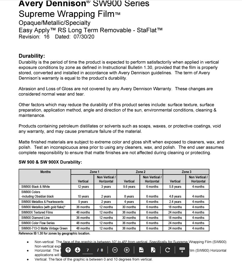

This wrap series does not have a very good durability rating. That could explain some of the reason for your problem See attached chart I found on the Avery-Dennison web site
It's been a minute since I looked at the specs, but I think 3 years on horizontal surfaces is pretty standard among the manufacturers.
The customer was saying that they think its coming from UNDER the wrap... so are you saying it might be mold under the wrap?
I have that page memorized and it's part of our sales schpeel when we are selling wraps. but thanks for offering that up.
and for the record, what gasouthpaw said...this is a pretty standard durability.

Pull off the vinyl and let everyone know if it's under the vinyl or just on the surface. I would lean towards an ENVIRONMENTAL problem and not a material problem.
