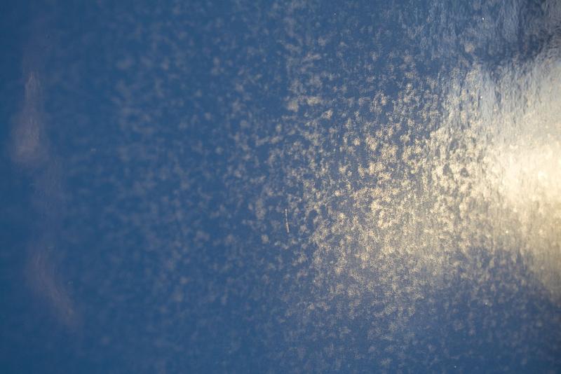

Anyone seen anything this bad? Avery quality control at its best?

We order small pieces like that from Alumapanel... They have Oracal and FDC. We get a lot of FDC 2100 series like this (small pieces, not defective).
Patentagosse
It happens all the time with Avery. I have a full roll of Process Blue 48" with a strip of 8" spotted like this. You can easily solve your problem by running the heatgun over it. It will turns glossy after few second. Just make sure not to over-heat the film otherwise bubbles will appear (like "boiling point"). Never got that kinda issue with Oracal or 3M.
If you have to deal with Avery, for whatever the reason, GOOD LUCK. It took me +8 months to get a refund after I did a job with cast materail that turned defective after 18 months (major shrinking issue, more than ¼" on 6" letters!). Film was rated 8 years... (wow!...)
Heatgun is your friend for this one. Lemme know how it ended up.
Patentagosse
I've been explained that it's when the film is still hot, it's been rolled a li'l too soon after process. The surface is marked by the contact with the backing. That's why heat can bring it back...
'Hope it helps

It's called Mottling and happens to vinyl occasionally.
Heat and sunlight can make it go away sometimes but I would return it for a replacement roll.
It looks like Sh!t and I refuse to tell my customer it will eventually go away.
Your customer will think your selling him or her old crappy film...

I've had mottling, marks, creases, foreign objects, etc etc at some stage from every brand I've used. As mentioned, try heat for mottling.

yepp... just heat it up or let it sit on the sun < lol its winter.
3m overlam's last yard or two looks the same

Unfortunately, I've seen a few rolls of Avery with that same blotchiness lately. Very disappointing and frustrating. I ruined an entire wrap because of it. Fortunately they (avery) honored a new roll of material.
msheurs
ive gone thru a couple rolls of the gloss black that had that. like they said heat gets rid of it and you dont notice it after its on the car and out in natural light. after that the sun takes care of the rest.

Oh I hope this heat gun thing works. You guys have me wanting to leave work to try this.
I noticed also that there was some pin holes in this vinyl when I took the pic.
