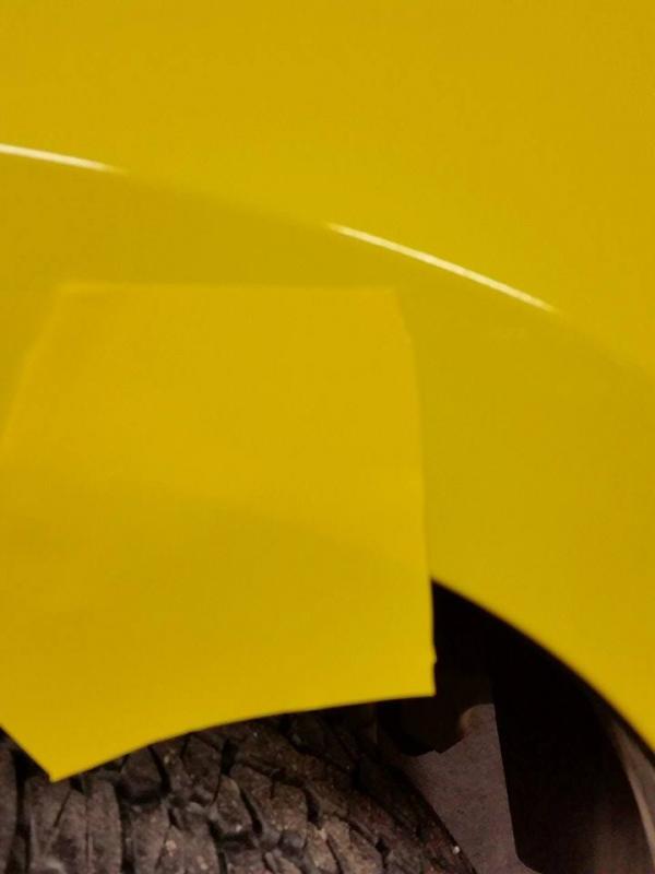

I have used sw900 more than once but never with a dark vehicle base and putting a light color on top. This maroon Tahoe I am putting the Sw900 yellow on makes the yellow darker when installed. NOT opaque like when the white backing material is on it. Also IF I need to overlap a seam the yellow then becomes opaque on that overlap and sticks out like a sore thumb.
Is this normal when switching from a dark base and putting a light color on top with the Avery Sw900? I am not asking for someone to tell me to use 3M, etc... and get into a material war. I am asking if I got a bad roll of Sw900 because I can tell that the base color is dark through the yellow wrap.
Attached is an image showing one layer vs. two.

Yes that is fairly normal on all vinyls especially onto such a dark base colour.
Some colours are worse than others and that yellow onto maroon is a pretty dead certain for a shade change.
As for the overlapping issues, I guess their is not an answer if it has to overlap.
I would get the client in to show them the issue before continuing and explain this is an issue with applying to such a dark colour.
