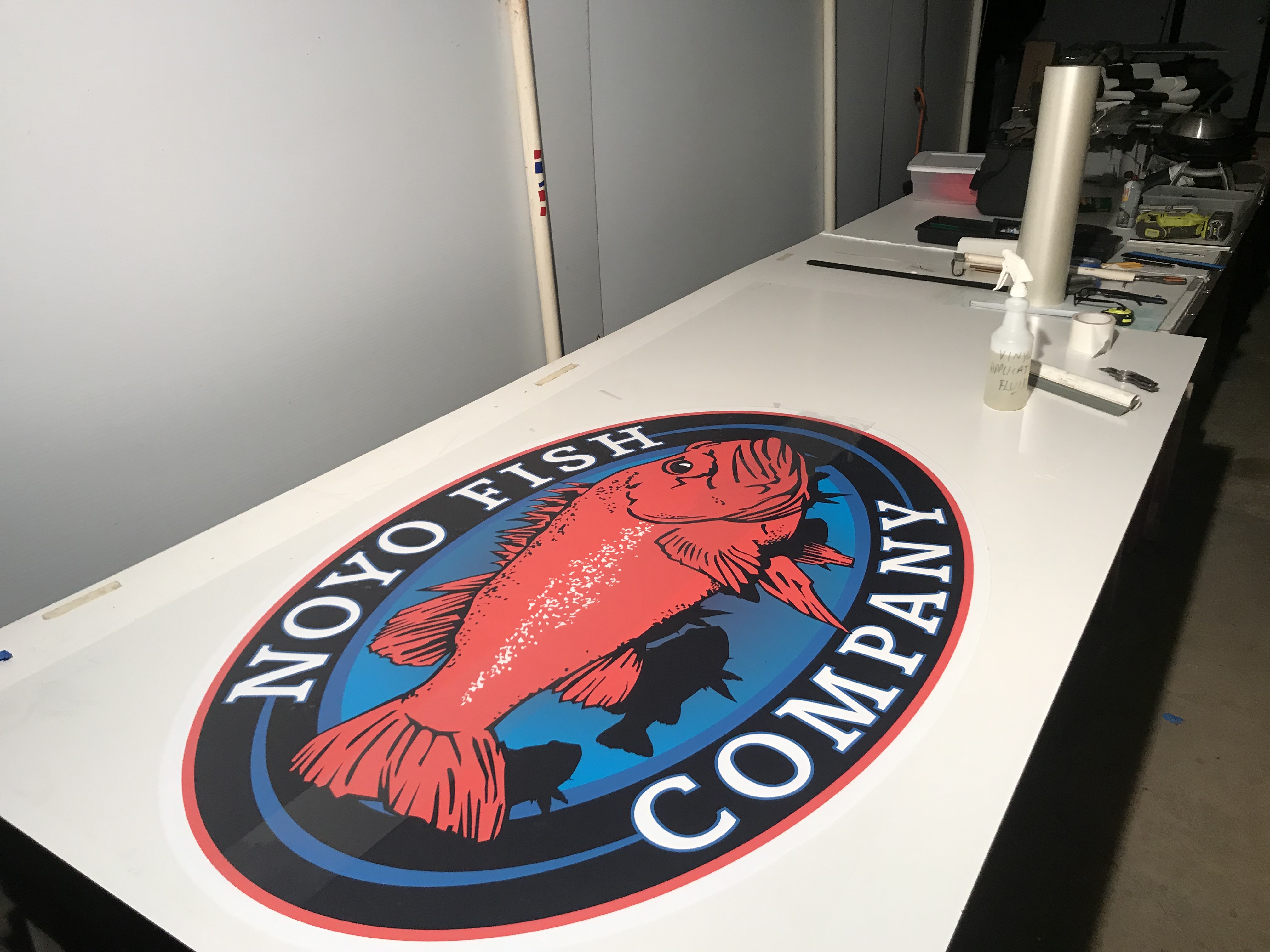

Hello ,
Im cutting an oval in this 1/8" B Board or B Bond. I put a 60x40 graphic on and I left the masking on. Im thinkin I will jig saw round that there. The masking Im thinkin will stay on while I saw the oval too. Sound like the thing to do? This sign Has been done twice now. Im worn out today. Going to saw in the AM. Going to saw real slow and real careful.

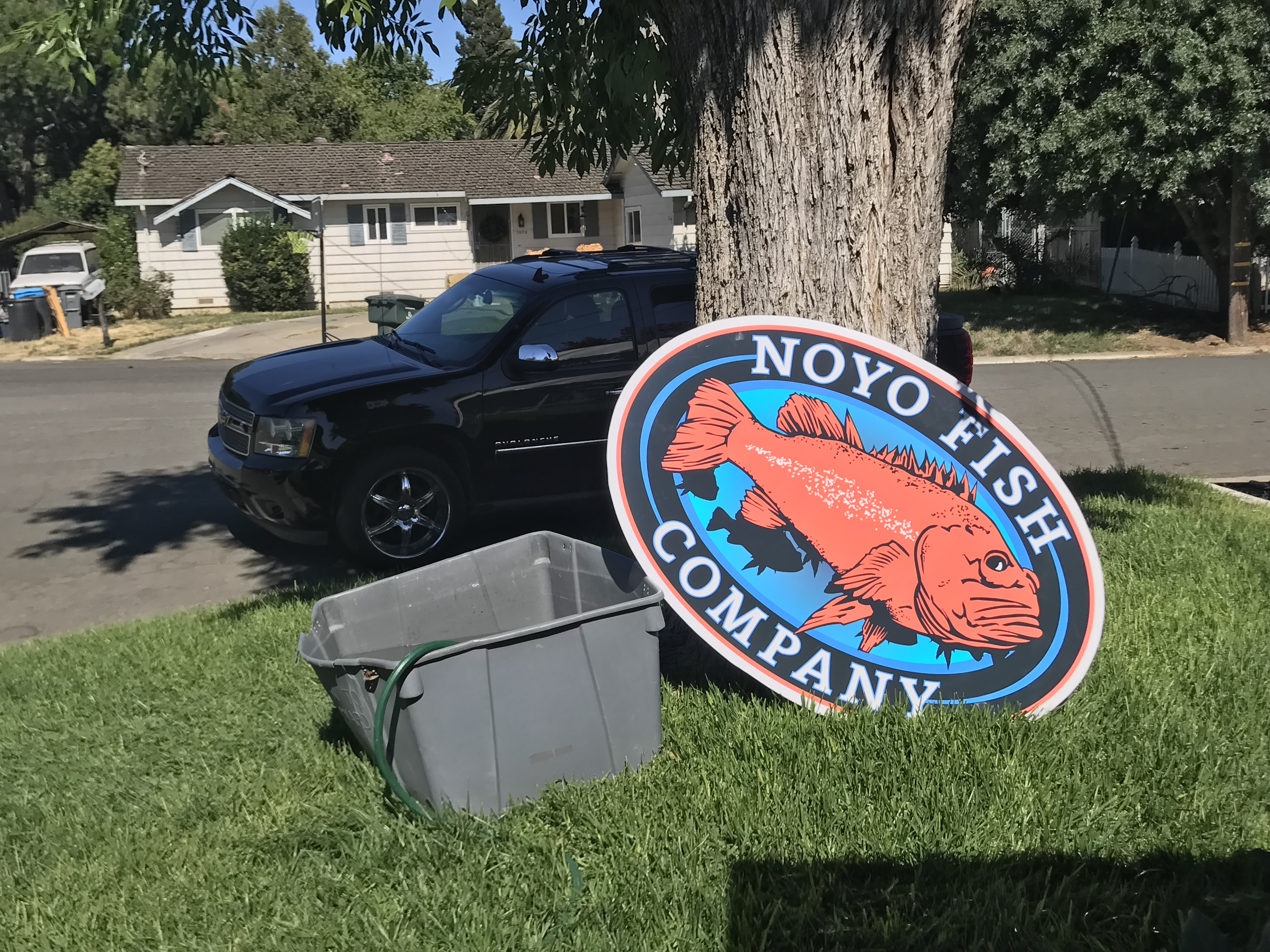

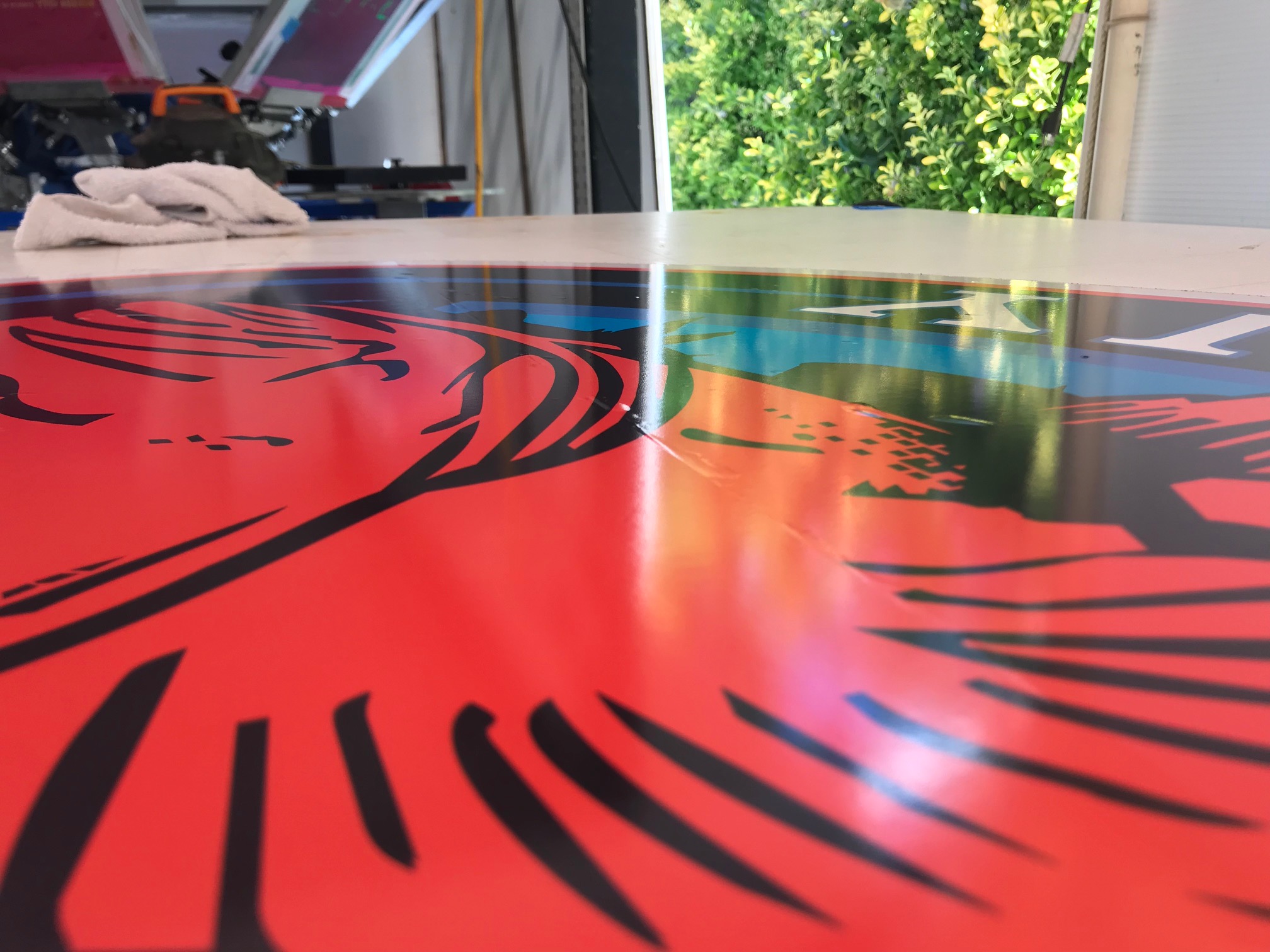

Second try... The first try is on the reverse side with a whole lotta bubbles. My taping session went south and I chose a middle hinge method. It was a sloppy. The whole session was sloppy rusty hacky work. I have been comm fishing for 3 years and this is my first job since i decided to do this again. Anyways So I had an extra decal that did not contour cut. I masked it with blue tape and carefully cut the border out. Ive put this decal on satisfactory and this jigsaw cut will be for the win. THANK YOU ALL for the tips and tricks!
Best regards to the 101

Giving myself a C on the cut. It wavers some here and there. Need more practice and maybe could relax more. After I removed the tape i do have more water bubble than I would like. But over all I think its worth the money. Its an indoor sign but maybe I will seal the edge. Anyhow... Learned alot and some of the suggestions I could research for sure. Setup tables and cutting oval before install. My brain smoked thinking how to drop this big sticker perfect on an oval at my yard/shop. Hmmm setup table? Tell me more
