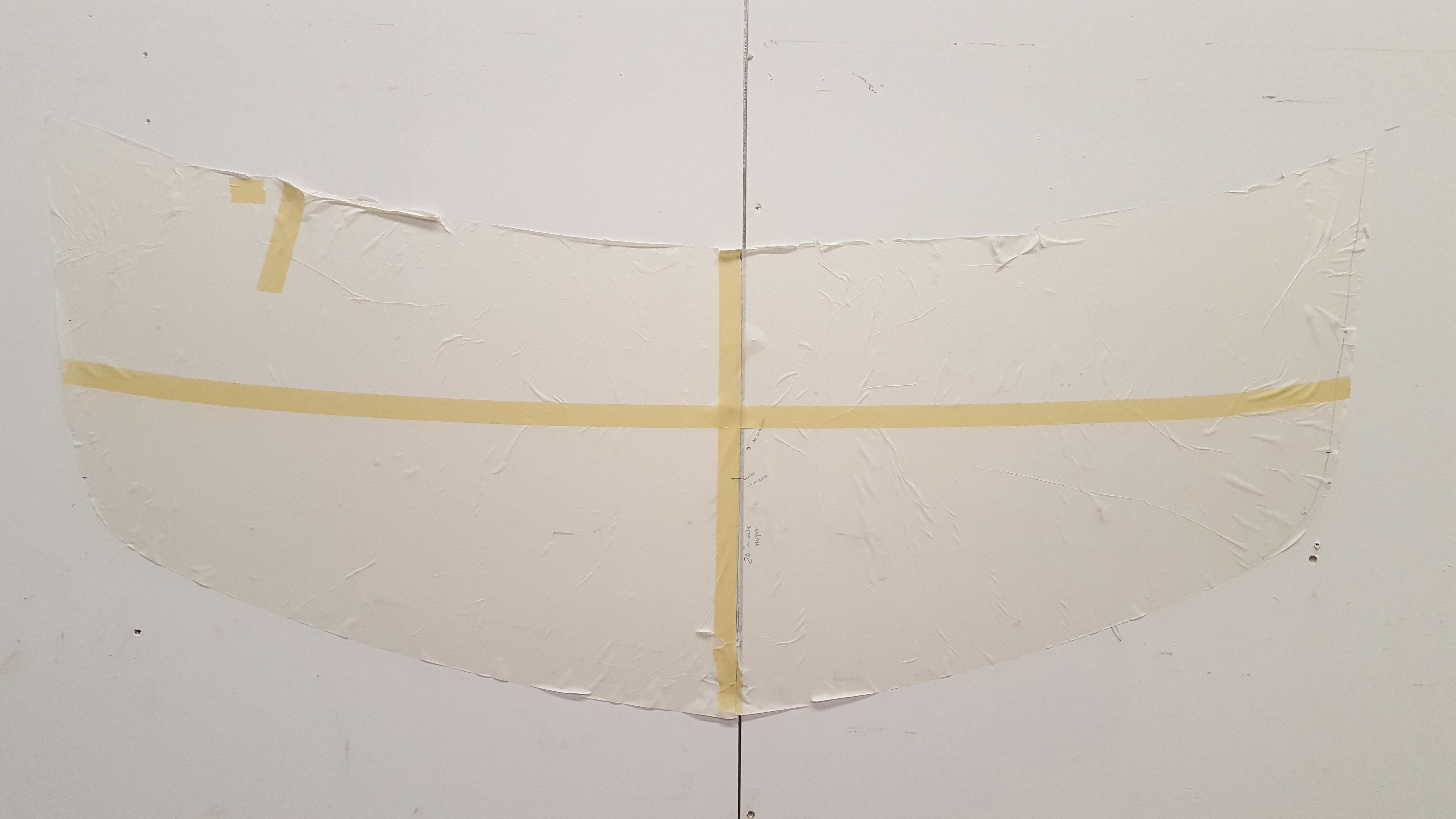

with window graphics (or vehicle wraps) the vehicle should be brought into the shop before hand. Cover the entire window with transfer paper as if you were applying the perf. take measurements and write them directly on the transfer paper. use masking tape to mark your center lines. the tape will naturally follow the curve of the window. trim out the transfer paper around the window. Remove it carefully from the glass and put it on a wall surface. Take a photo of it as straight on as you can. this will give you the curve you are working with.

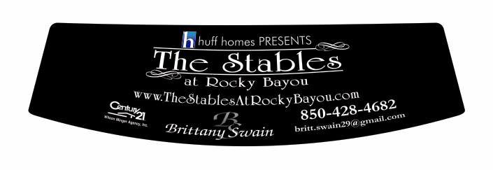

Import the image into your design program (I use illustrator) and use it to trace out your curve. Then curve your artwork to follow this line (into a smiley face, always curving up).

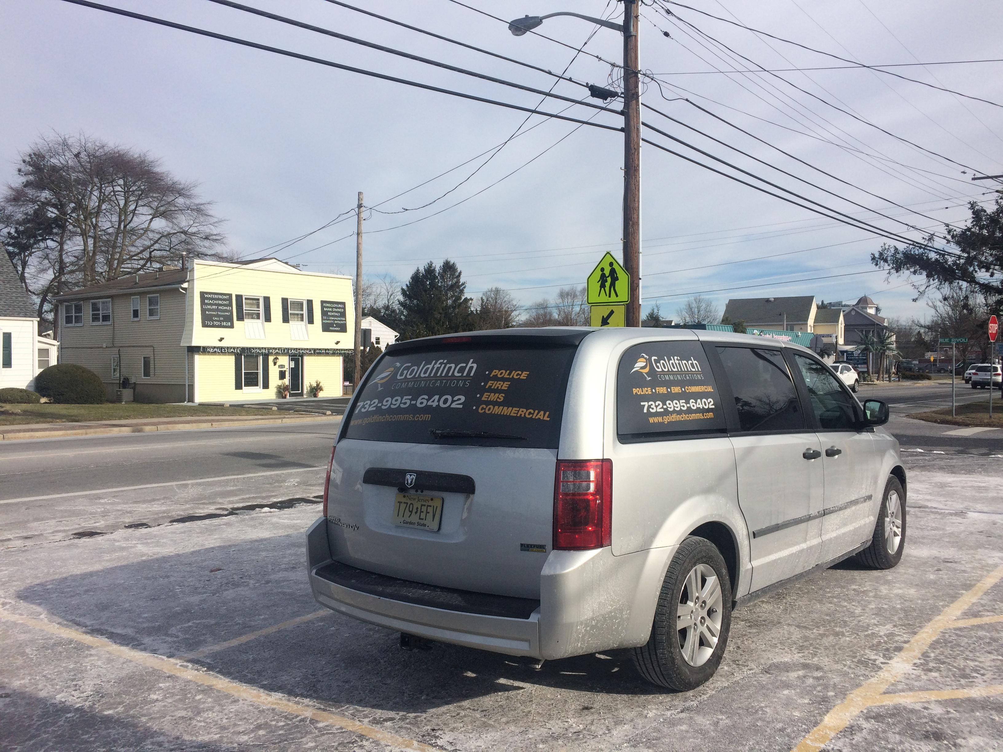

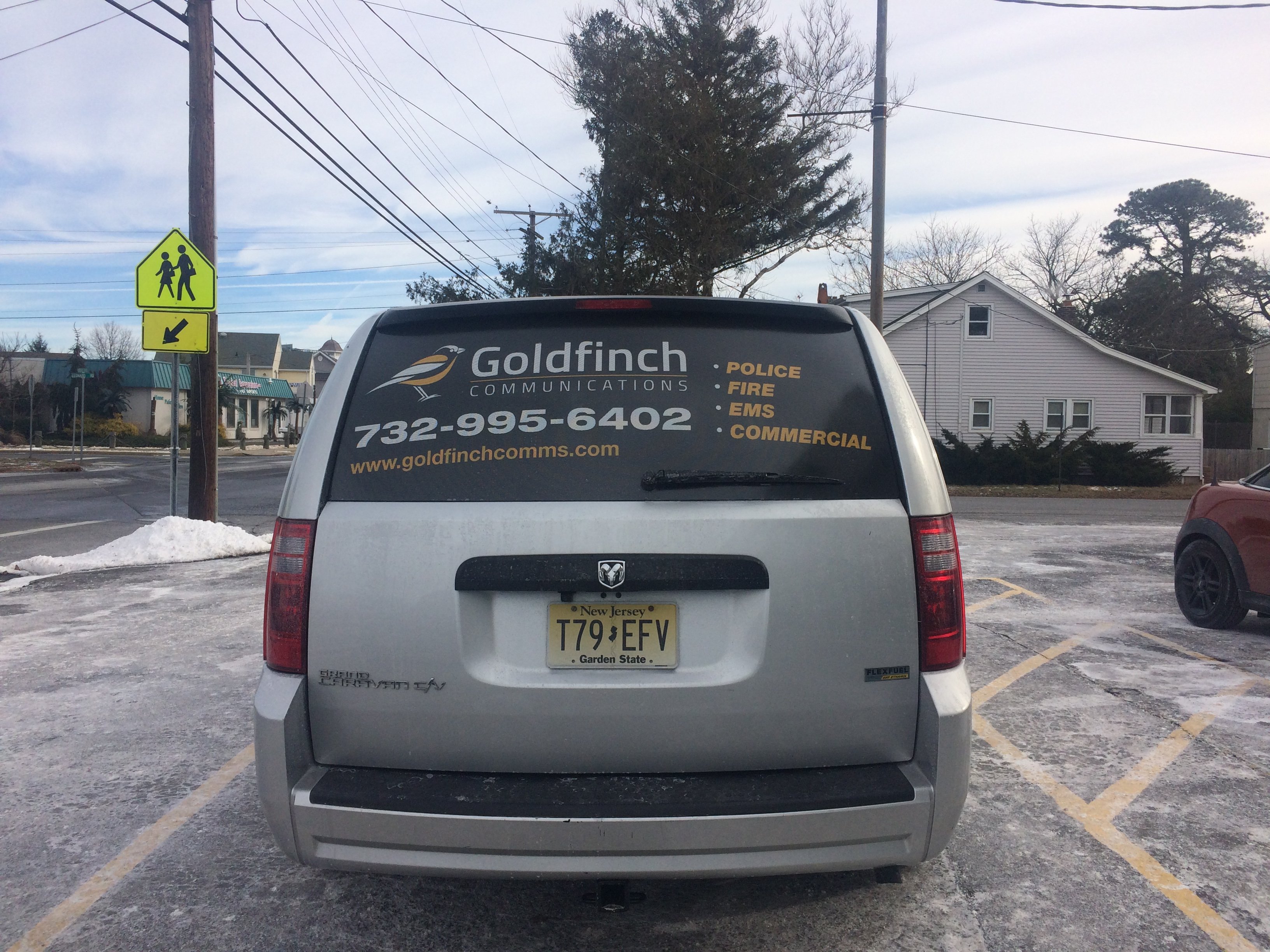

When it is installed the perf will fallow the down direction of your window and the graphics will straighten out. I have attached a photo of what I am talking about. Hope this helps.
