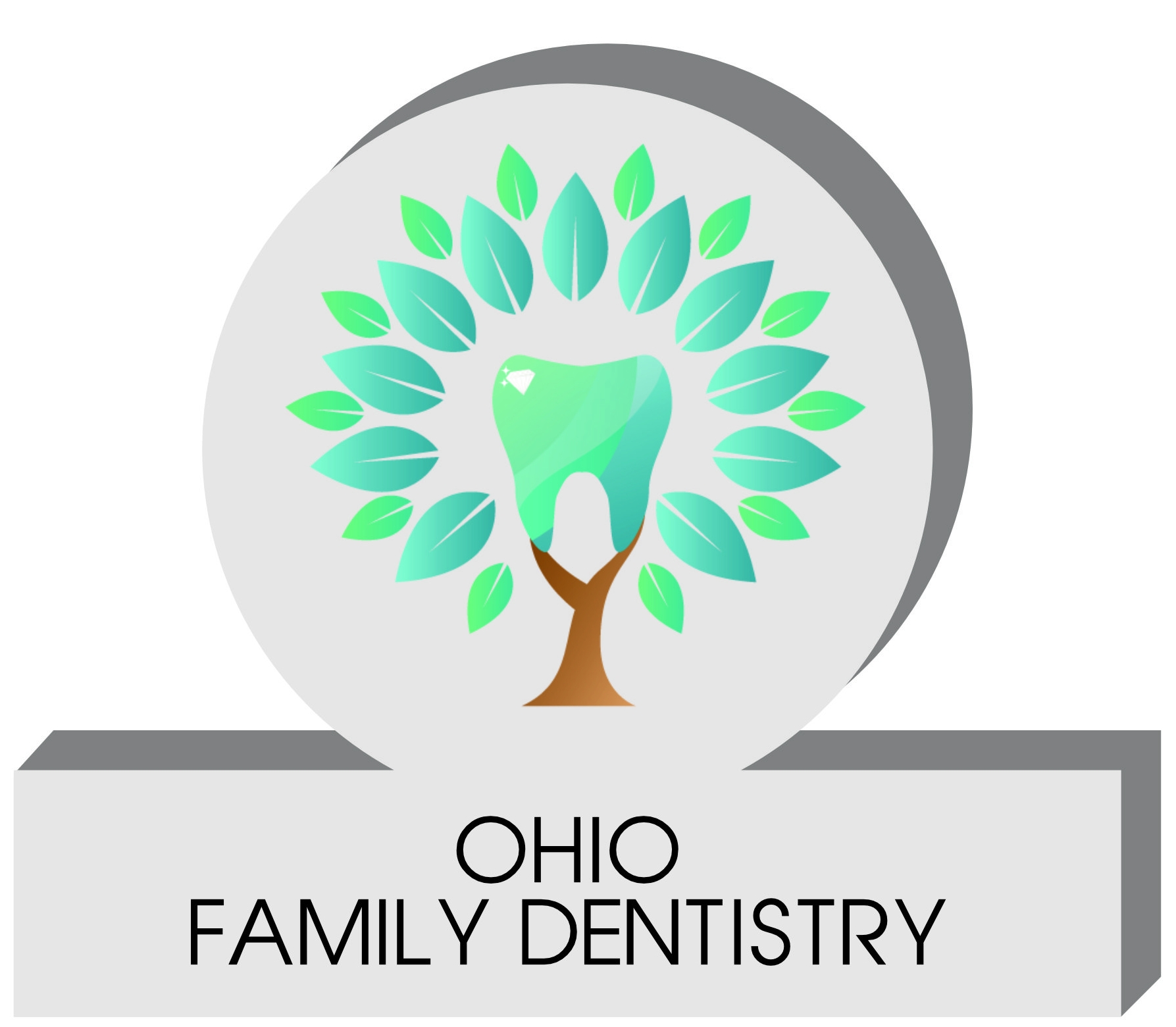

I've got a customer looking for a backlit sign, 1 sided, that would mount to a building. This is not a standard square backlit - which is fairly easy. I'm looking for a light box sign looking like this:
or
each piece of the logo as dimensional.

I would suggest that you consider creating two separate cabinets to help on fabrication and maintenance costs.
The icon section seems to dominate over the name section.
If these are simple backlit cabinet components, I don't see where adding dimensional elements to them will really enhance the look unless you intend to push through acrylic on an opaque background.
  • Approximately, what will the overall size be when finished ??
  • Is it a flat wall ??
  • Are you doing the work or sub-contracting it ??
  • Whose design is this ??

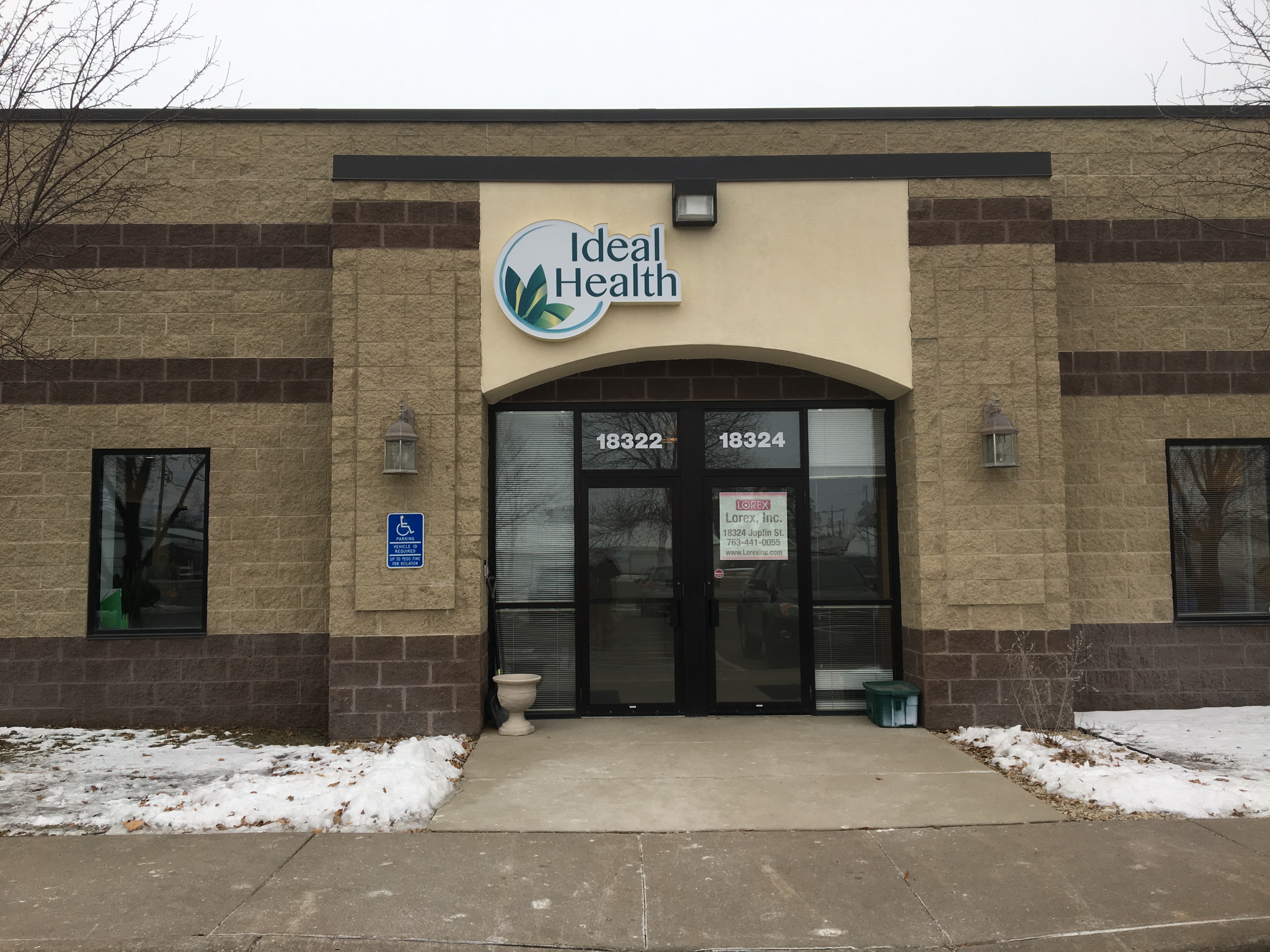

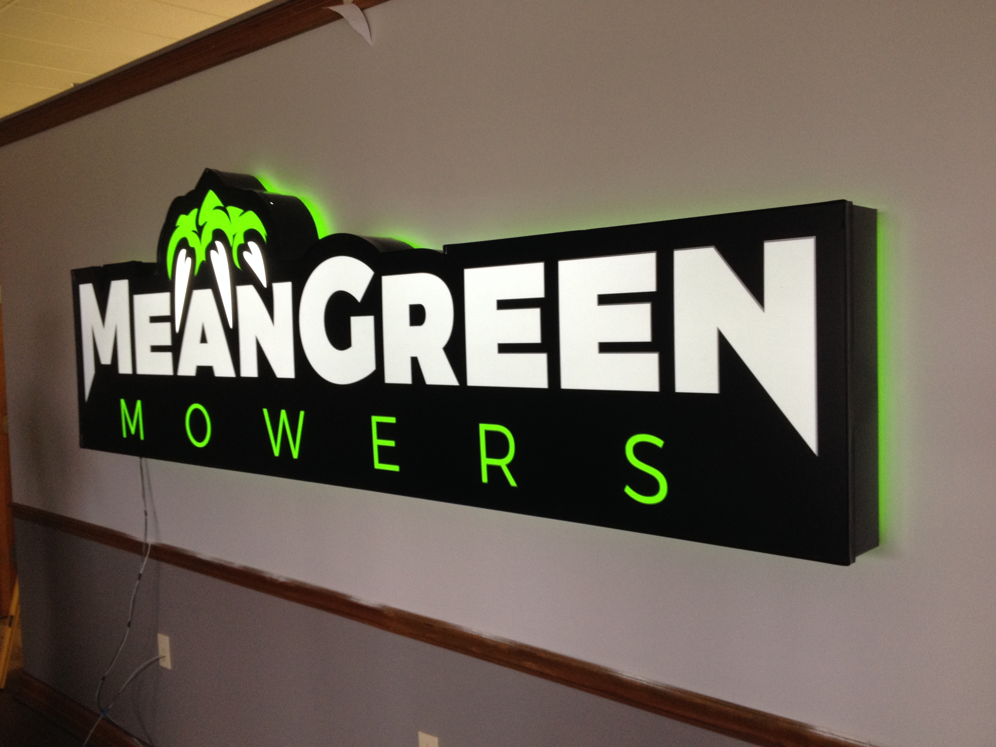

For a simple option why not a channel letter box? Attached is one we did a few weeks ago, subbed out to direct sign wholesale. Easy cheap and the customer is thrilled with it. Unless the customer wants to spend more, then I would look at push through style as others mentioned.

It is 4'x4'. I was planning on doing the work myself but contracting out the box.
This looks good. Where did you get that from?
Knowing what size it will be really helps. You could easily get a custom shaped cabinet with a trimcap face for that size pretty inexpensively. Then just decorate the face with a single printed decal on translucent media.
