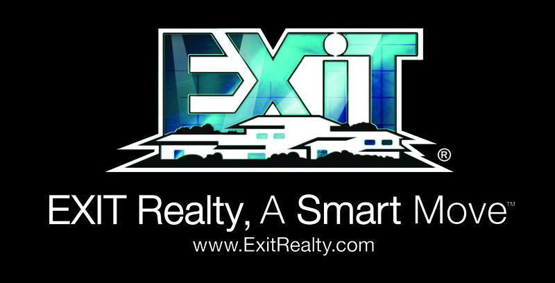

I am going to be replacing some panels in a lighted sign. They are 4'x8'. They will have a full color logo plus some white text and a black background... I have done these before some using cut vinyl and some using oracal 3850. I a trying to decide the best way to do this one so it looks really nice. I have attached a pic of artwork. Thanks for your help in advance

Do you have a 54" plotter? You could cut the black background and print the logo on white translucent for the outside. Reverse print the logo on clear and apply to the inside so the colors will be consistent when lighted and not lighted.

Couldn't help but notice in the tag line, "Exit Realty, A Smart Move", the typeface for "A" and "Move" are in a different weight then the rest of that copy. It can be perceived as a mistake rather than intended for emphasis.

Corporate does not always know best, even though they may think they do. It's visual. If it's worth your time, I'd send them the proof their way and then changing the A & Move thickness
and let them see the difference.

signcrafters london has the right idea, cause that black should be brilliant lit and unlit. You could always throw the typeface weight thing as a note with a reason on the estimate and let it be their decision.

I can do printed or lay cut translucent. I have a 54" Printer. I was thinking possibly about reversing printing logo on clear and backing with white translucent inside on clear acyrlic? and laying black translucent background on inside as well but i was afraid the black would wash on clear acrylic? I am trying to stay away from tranlucent paint.
That would work, I would put cut black vinyl, mirrored for the second surface, down first
Then the 1st printed Image , then 3M diffuser (white translucent vinyl might be fine but diffuser makes it pop more)
and then as I said above, a second print behind the diffuser so that it doesn't wash out at night.
