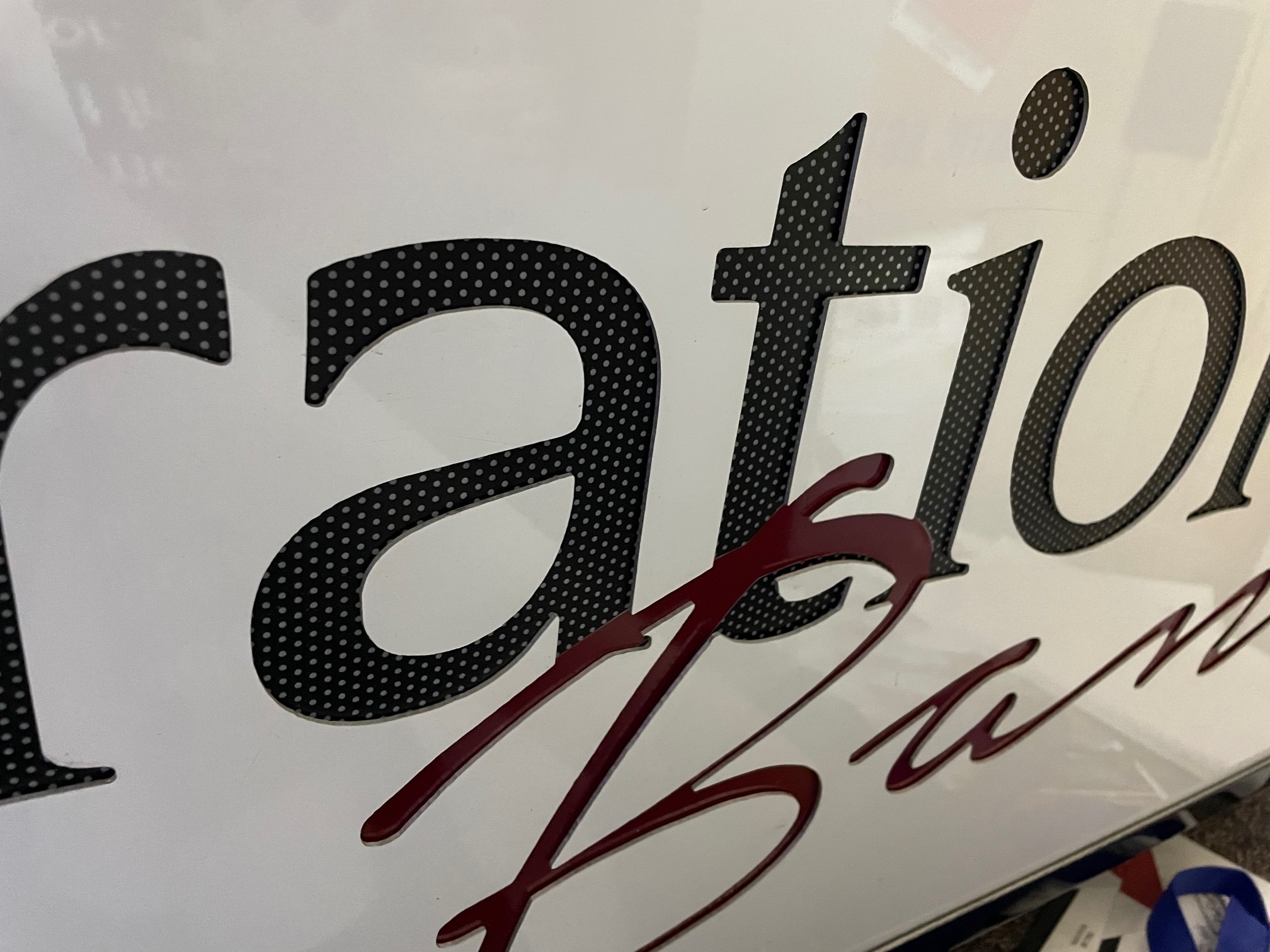

We are currently working on a project like this. The letters/logo are CNC cut out of ACM, then the letters/logo are CNC cut out of acrylic, but not all the way through, a thin portion is left on the back side. The letters will slide through the holes cut out of ACM, and that thin portion will be glued to the ACM. For color, I've printed on clear vinyl, which will be applied to the acrylic. We are about to put it up on the production table to be finished. I'll try to get some pictures.
JBurton
Signtologist
Then, how do you attach your polycarb to the back of it?
Magic!
But really, this machine is critical if you want to do push through copy that will last. Glue and tape are really only temporary solutions, epoxy works but is hard to deal with, especially with smaller parts like insides of A's. Though at least with push through, you have the edge of the acrylic helping to keep the piece in place. When it's just backed up it tends to sliiiiiiide downward. We route out of .75" clear, leaving a small lip, then add a sheet of .177" white poly behind that. It is feasible to glue acrylic to poly with channelbond, but if you don't have a very uniform coating between the two, it will distort the light where the glue is leaving dark spots.
Please tell me it's white acrylic or you're backing it up with a panel of white acrylic/poly. Clear acrylic, even with white trans applied, will hot spot unless the led's are mounted to the face of the can pointed backwards.

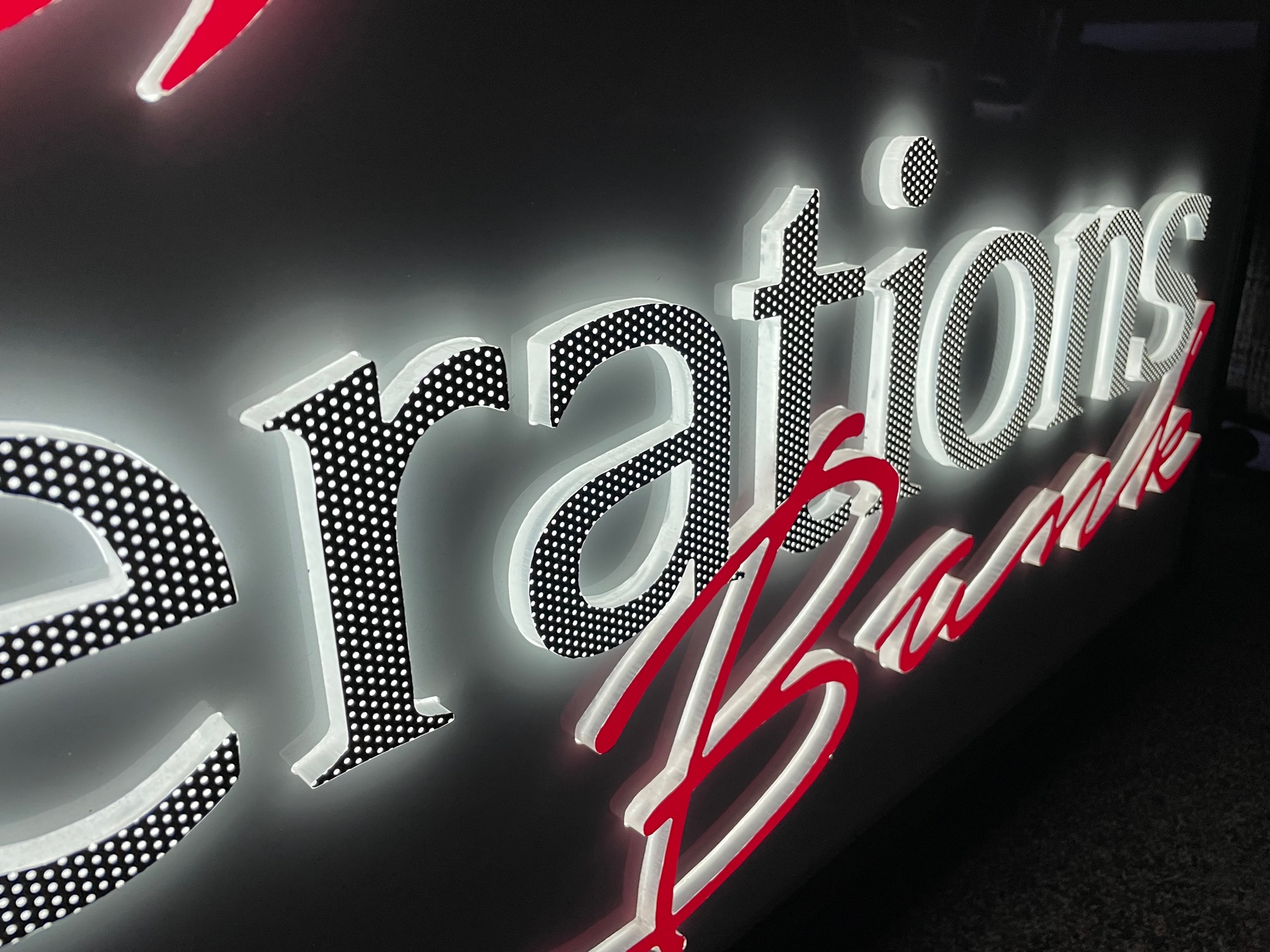

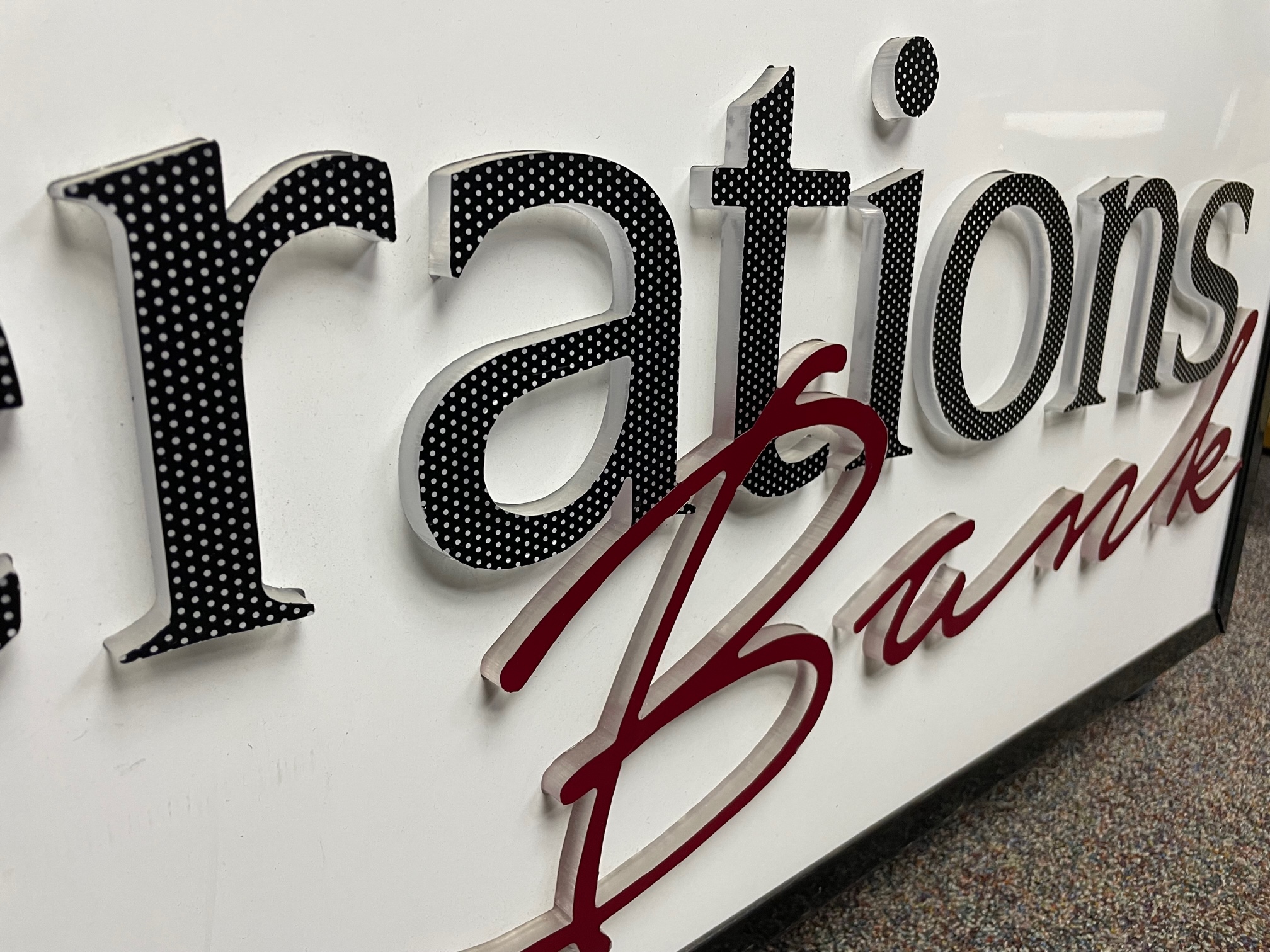

Here's one of our sample boxes, one side 'push through', the other is just 'backed up'. Forgive the rough edges and nicked vinyl, it was done with our old router and has been hauled to many banks since then. (We don't have to use the 'routed out' notation because some suit came up with ROST so he could speed through spreadsheets faster. Surprise mr suit, it's all routed out!!!).

Here are some pictures... Boss was just getting started as I was leaving. We dry fit the acrylic first, then he used a clear epoxy. Once it's set, we'll flip it over and apply the color.

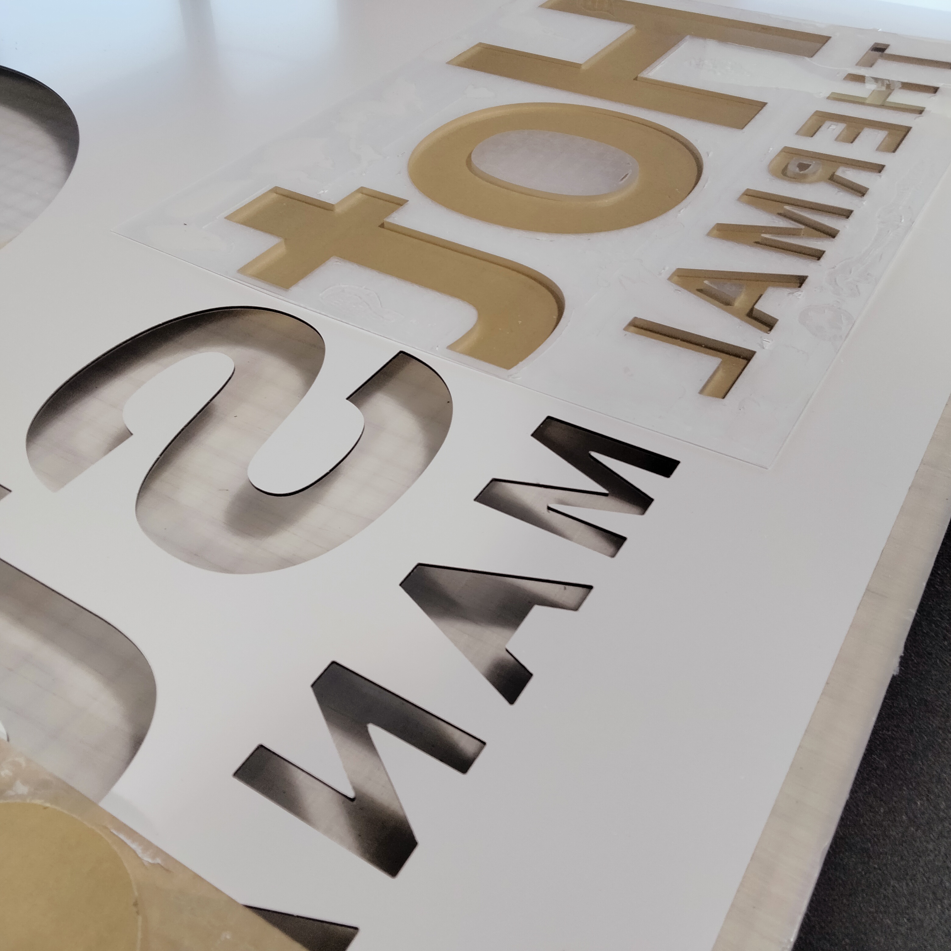

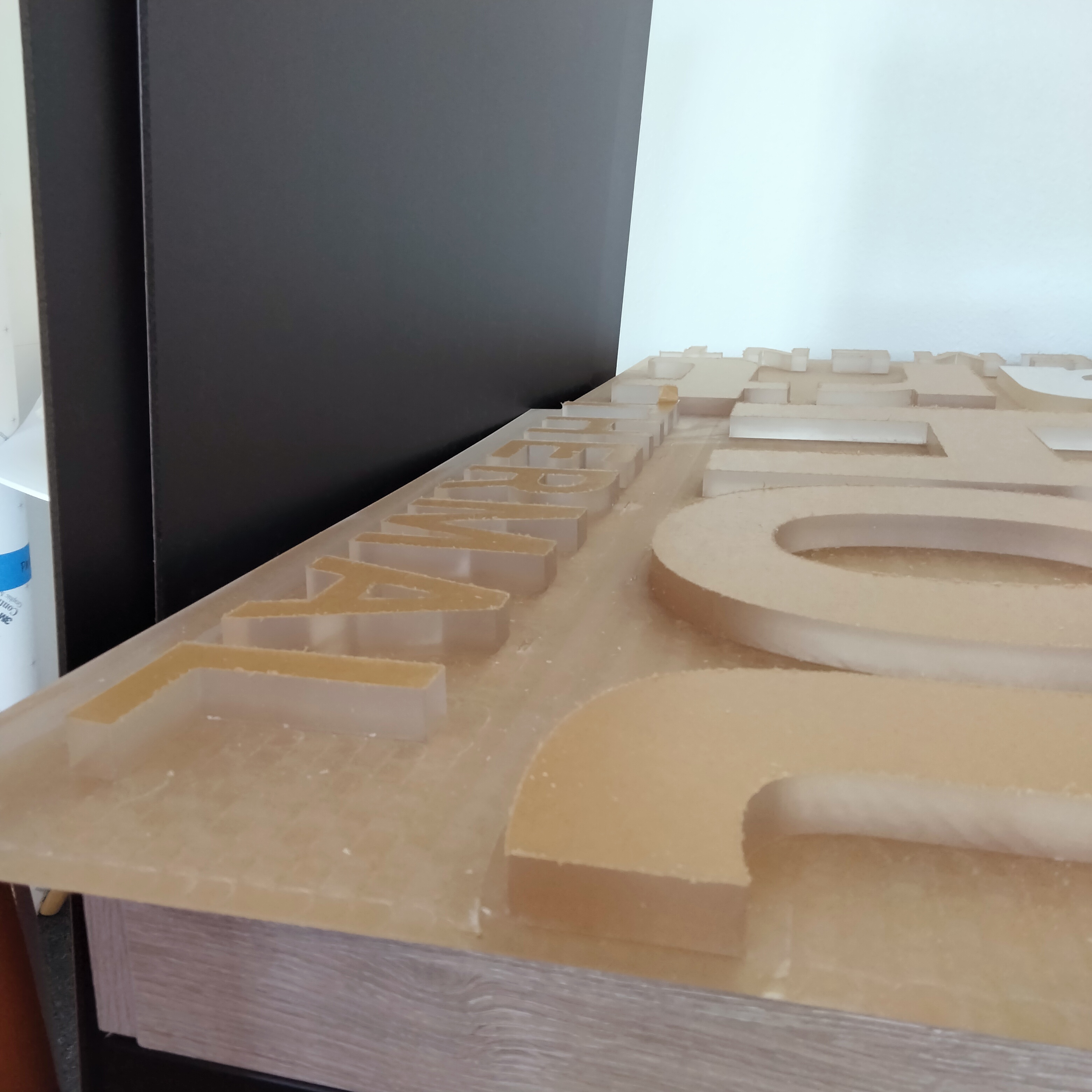

we don't have a CNC router in-house, we send it down the street to our CNC guy
Tell that poor guy he doesn't need to pocket out the whole sheet, a .25" lip around the perimeter is plenty, if you're backing it up with a separate sheet that is. That's the main reason we add another sheet, so that fewer studs have to be placed and less strategically. We used to have to run around the perimeter of letters putting studs just so, so they held but didn't show on the copy.
though even he admitted he cut it a little thin on the backing of the acrylic part
Looks about what we leave behind, between .25 and .125 will be plenty. You gotta imagine, for the letter to fall out, you have to push the whole thing through the metal (in this case acm) face. (wait, are those two pictures from the same piece? The one with paper looks to have much more thickness than the one in sign already...
