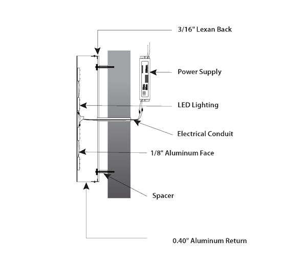

That is a "Halo Illuminated - Reverse Channel Letter"
First you need electrical access, it is a drop ceiling? Access from the back?
That is not aluminum faced foamcore and I don't recommend that, that is an aluminum or stainless steel reverse channel letter...
To stand it off the wall, you need to use butterfly bolts that run thru a stand off.
Lighting is by nestling LEDS in the letter channel.
Are you licensed to do this?

Order the LED lit letters with power supplies. You can wire up all the secondary wires yourself and just hire an electrician for 1 hour labor to wire up the primaries...

I've installed dozens of these. The letters are opaque and hollow inside, you paint the inside white, then route clear acrylic out of 1/4" acrylic the same letter but a little smaller. Place the LED's to the clear back and push inside the letter can and screw around it, this way the LED's shine in the letter and reflect back at the wall so there are no hot spots. Use thread all studs in the clear acrylic and for the stand offs it's nothing more than a small (usually 1/2") of PVC pipe, distance should always be 1.5" . Screw the thread all into the letters, put the anchor over and put into the wall.
