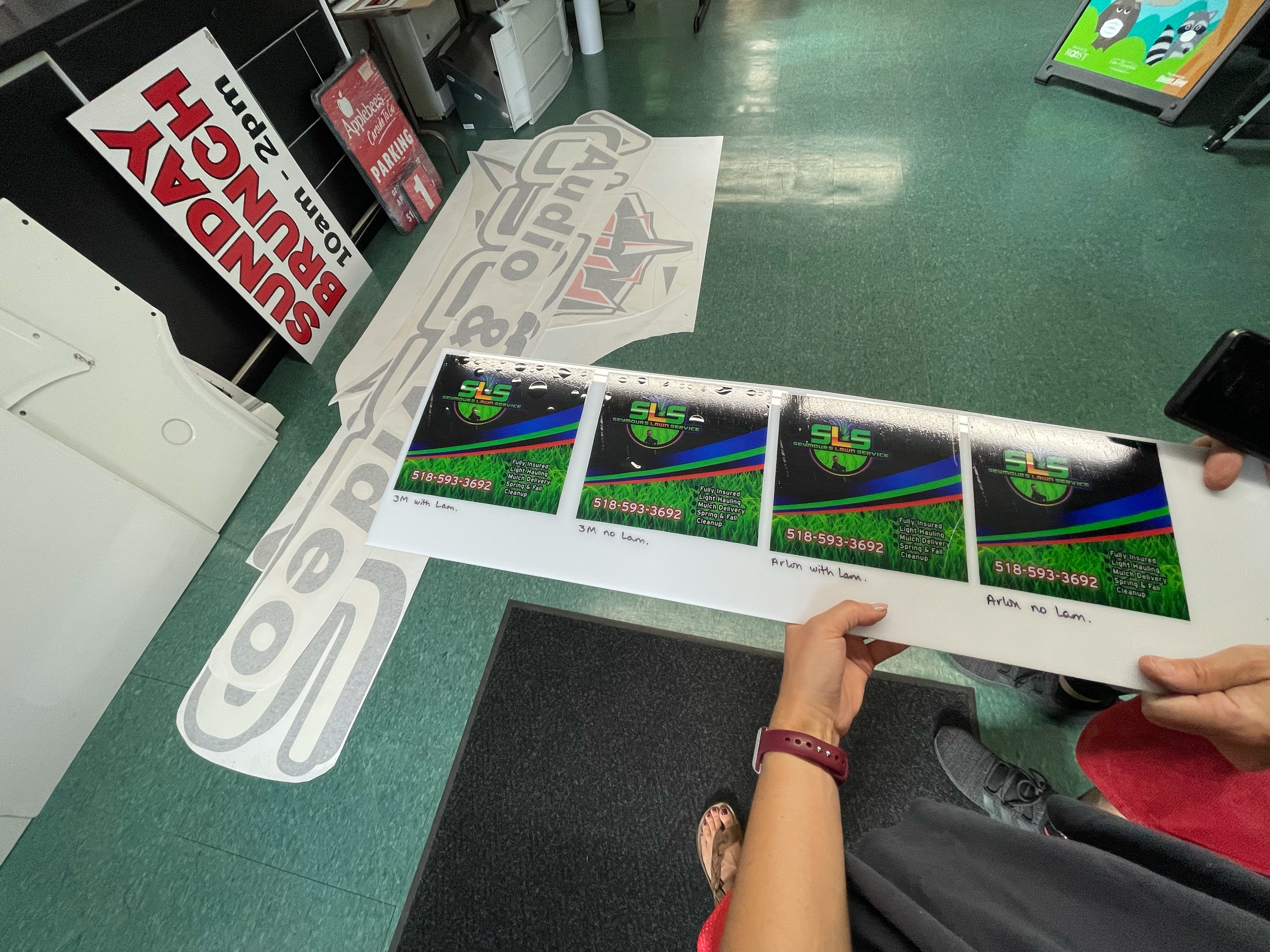

I know. We have a powder coat oven large enough but it's not something we want to be bothered with doing. We did some tests of our own. see attached The 3M is 40C-114R, the Arlon is 4500 clear.
That's a big difference. Did I miss the part where you explained why you use clear vinyl for your faces? We don't do much any more, thankfully, but always used 3850 when we printed graphics for faces.
Manuel Upton
We found that using white translucent vinyl with white poly was blocking to much light on fully wrapped faces no matter how many LED's we used. It could be an LED issue but I'm not sure about that. We switched to clear vinyl a few years ago and are much happier with the way the signs look at night.
