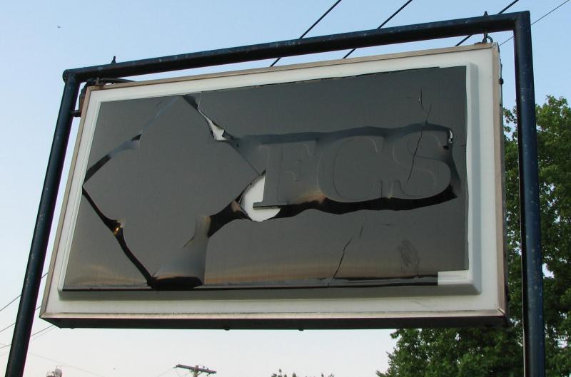

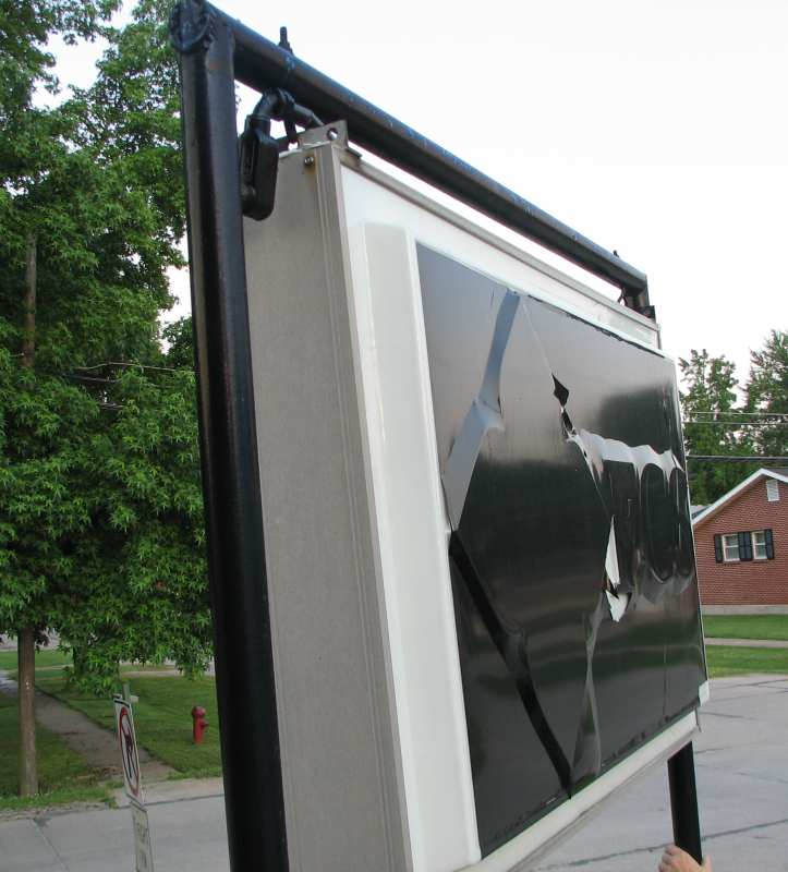

How deep is the back lit sign frame? Sometimes a pan face is used on thinner frames, say like 5", so you do not have hot spots in the lighting (when using a flat sheet)
Parthenia
Oh boy...I'll have to go look at it again. Good point. I'd hate to use a flat face and have the vinyl melt in spots!!!
Parthenia
I took a quick trip and the box is 6" deep. I took photos and have attached them hopefully so you can see it. Thanks so much for your help TammieH!
