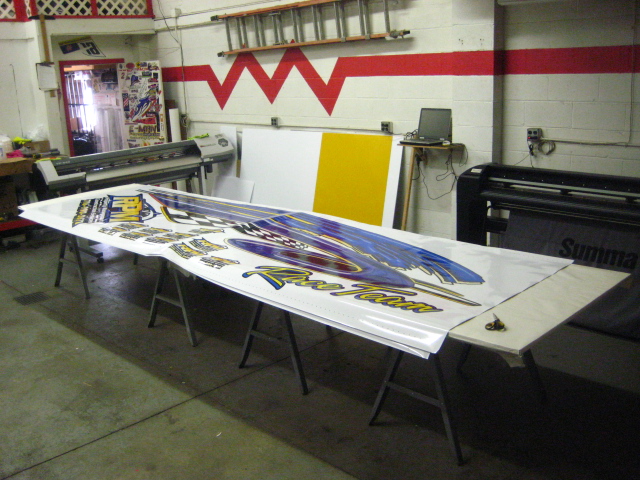

I don't see how you could laminate something this big with a BS this print is only 16'
Beg to differ. I have laminated 8' all the way to 20' prints
Its all in the size of the table or pushing 8' then pulling material to other side of table and pushing the remainder.
The BS requires a true flat and large table. if your pushing 54" wide prints your table needs to be at least that wide.
They do work great on smaller things and are fast but they do not replace a laminator. I think I now have 4 or so of them floating around here.
