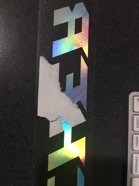

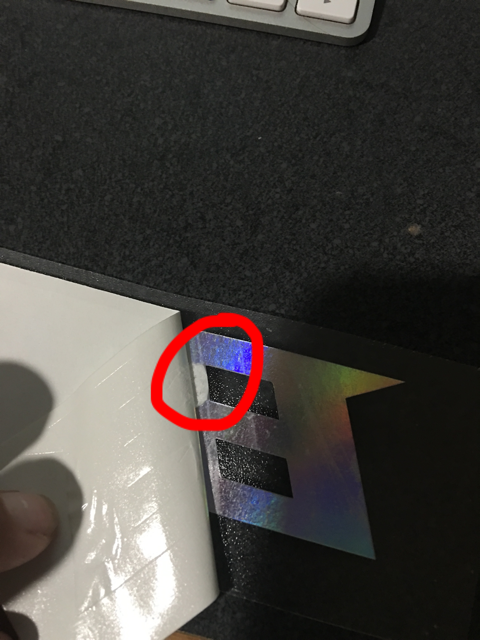

I am having a horrible time with the backing liner splitting into two when trying to lift the transfer tape off some holographic cut vinyl. Does temperature have anything to do with it? I am in a climate controlled room.....
Never had this issue before - especially if I go at a 45 degree angle to release, but this stuff is splitting and sticking to the back making it very time consuming to get it all off.

I normally work with printed wraps - so going back to old school and layering some cut holographic vinyl on top of a wrap.
I put the sheet of holo - cut, weeded, applied the clear transfer tape.
I now flipped the piece over to remove the backing paper of holographic vinyl - however it is splitting into 2. Almost like the transfer tape isn't strong enough to hold the holographic vinyl down, while I peel back the release liner - thus it splits into 2 and leaves a film of backing paper from the roll of holographic on the back of the sticky side of the vinyl.
Did this for years in the past and never had an issue....

It's not the tape, it's you. You can clearly see in your one picture, your knife blade is cutting far too deep into your liner. Lighten up and your problem should go away. Perhaps, your blade is dull and you're putting too much down pressure on it, due to the type of vinyl you're cutting.

Sounds good - like I said I don't use this roll of cut vinyl very often. I had a old GX-24 Roland cutter - had it dialed in for this stuff years ago. Now I just use my VersaCamm - blade is good, but apparently 145g is too much for this particular roll.
This stuff is picky - as I remember on my GX-24 experimenting and not having enough downforce and everything would be weeding fine except one or two spots and ruin the whole thing, unless I caught it quick enough and cut it myself with a knife.
